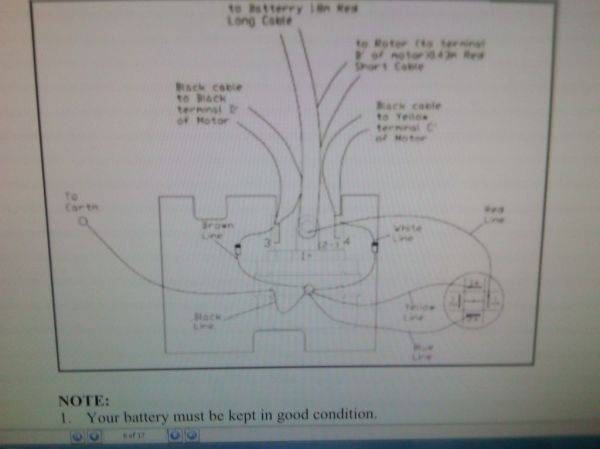

    3 wires i figure 1 is hot, and the other 2 send power to the in or out.....
    seems easy right... wrong....
    http://www.smittybilt.com/docs/installation/97281.pdf
    wiring diagram......for soleniod
    all i did was tap in and add a red , yellow and a blue wire....
    even thought i only think i need 2.....
    when i test the switch i find that both in and out get power no matter what way you push the switch........

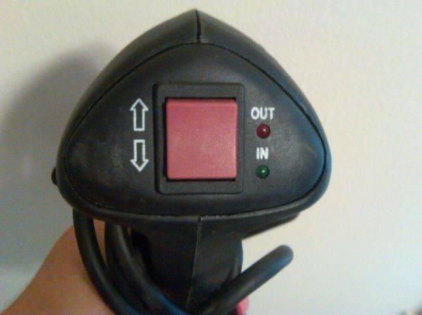

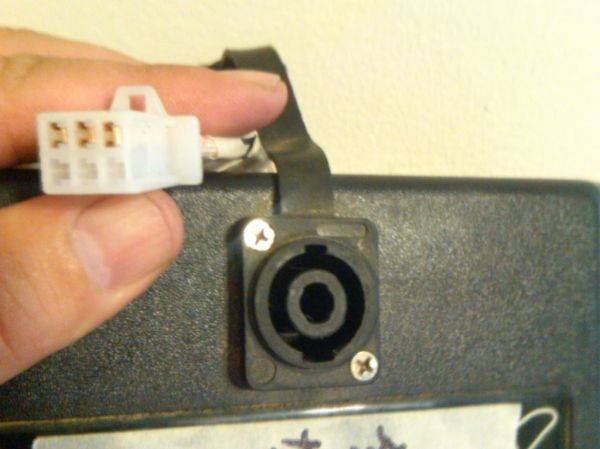

    here is switch on hand held
    this is the backside of where handheld plugs into VVVVVV

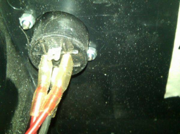

    the wiring from there goes into here
    .....then the white plug plugs into the wiring harness on the soleniod....... " would have been nice if they used the same colors through out entire circuit" but anyway....
    i jump a hot wire i tracked from soleniod and test the other 2 terminals and they both get hot no matter if you press in or out.....
    so then i try all possible combinations and none are correct
    and i can find my continuity tester:mad:
    and my multi meter dont have one built in......

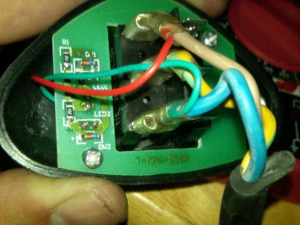

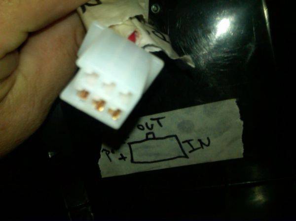

    ok so this sound confusing but here it is.....
    yellow/green wire on switch is left on cover and is +
    blue wire on switch is middle red on cover and is IN
    brown/tan wire on switch is blue on cover and is OUT
    now i apply 12 volts to + side and test switch and the other 2 terminal both get hot .... with the switch while pressing in or out.....
    hmmm
    wtf
    broken switch in handle idk.....

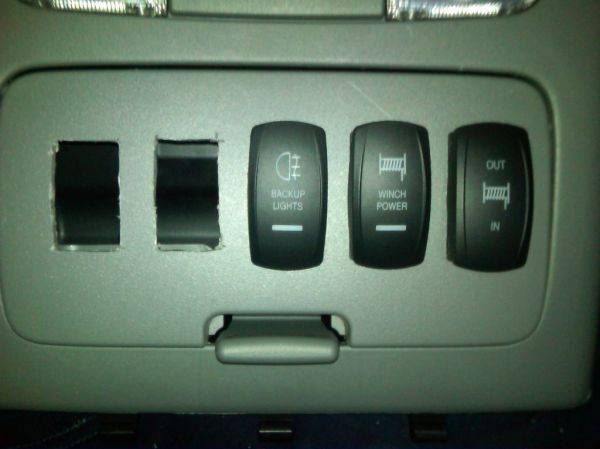

    thats alnmost what im doing
    but i relocated my plugs to the bumer and have a switces in the cab...
    all that is left is to splice to 2 or mabye 3 wires from new switch to the ones going to soleniod.......
    shouldnt be hard at all.....

    this is the stupid xrc8 instructions from their website..
    great quality they have.....
    by the time them 3 wires above ^^^^^ go to quick connect on soleniod cover the to switch face the color change 3 times.......thats just stupid

    here are the switches going in

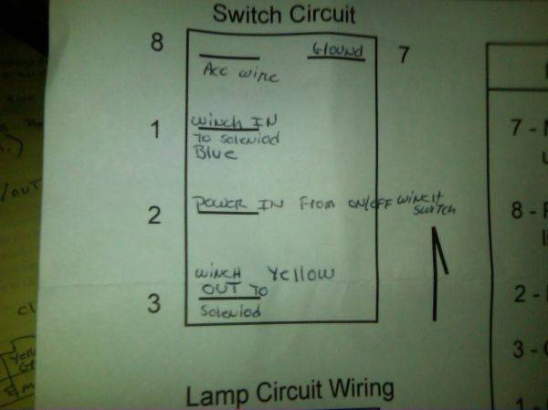

    here is the connector from / on the soleniod
    so here it is i belive
    when tapping into the soleniod wires.....
    yellow/green is out
    blue is in
    and red it was sends the current.....
    i think
    works out in theory
    if this makes sense
  9. Jul 13, 2012 at 5:19 PM
    brutalguyracing
    brutalguyracing [OP] BIG DADDY
    Jun 28, 2009
    #19000
    24,052
    F.U> GUYZ
    broken mods
    this should be it
    thanks for all the help guyz

    i think i got it......
    they try n confuse me with the stupid color change in their wiring.....:cool:
