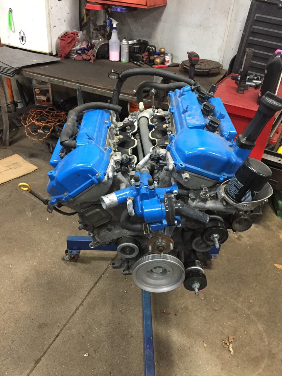

    Gotta start doing a build page so here we go. Gotta lot to fill in but gonna start with my motor now that I’m building it. And go back to the truck
    2005 xrunner speed way blue
    133k at the moment
    Magnusson blower
    2.6” pulley. Upgrading to 2.3”
    Doug thorley long tubes
    Urd y pipe
    Ghetto cat back
    76mm throttle body
    Urd intake
    160 degree thermostat
    Snow performance stage 3 meth
    Custom ice box set up for supercharger.
    Extra water pump for ice box
    To install with motor
    650 injectors
    Nst pulley kit
    Nst supercharger lower pulley
    Urd stage 3 clutch
    Aluminum flywheel
    Clutch master hydro tob
    Cp 9.5:1 coated pistons
    Bc rods
    Arp head studs
    Arp exhaust manifold studs

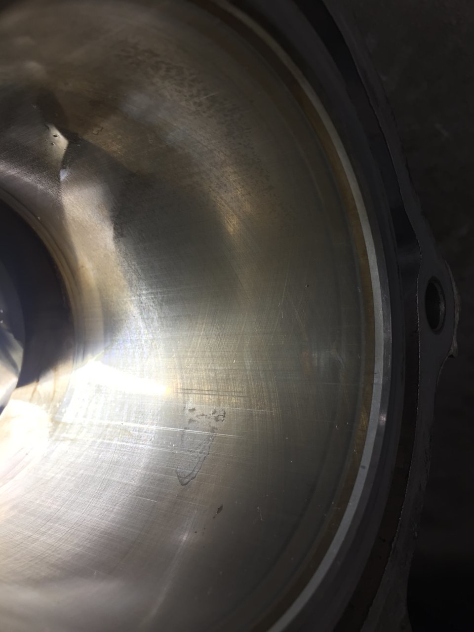

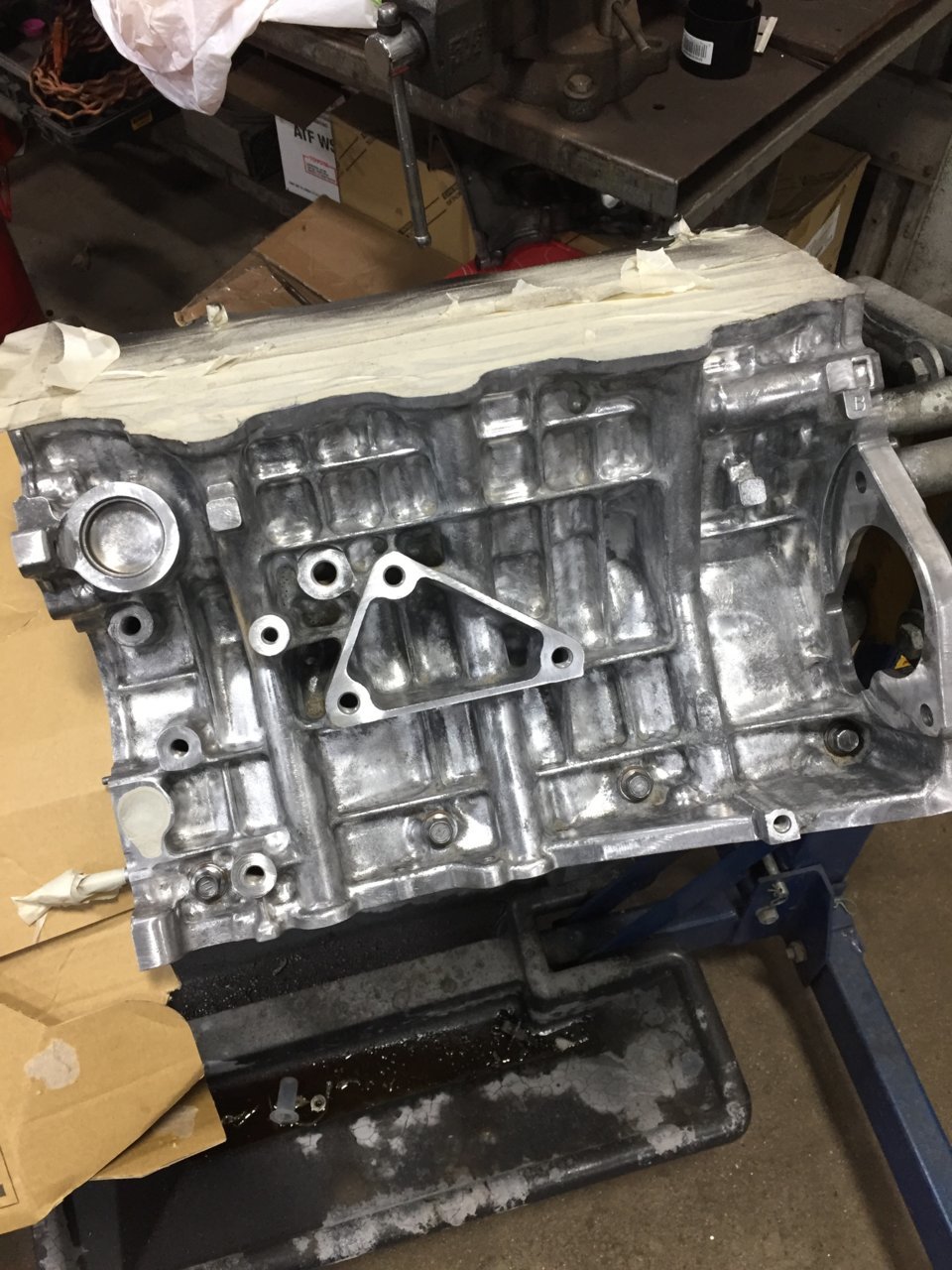

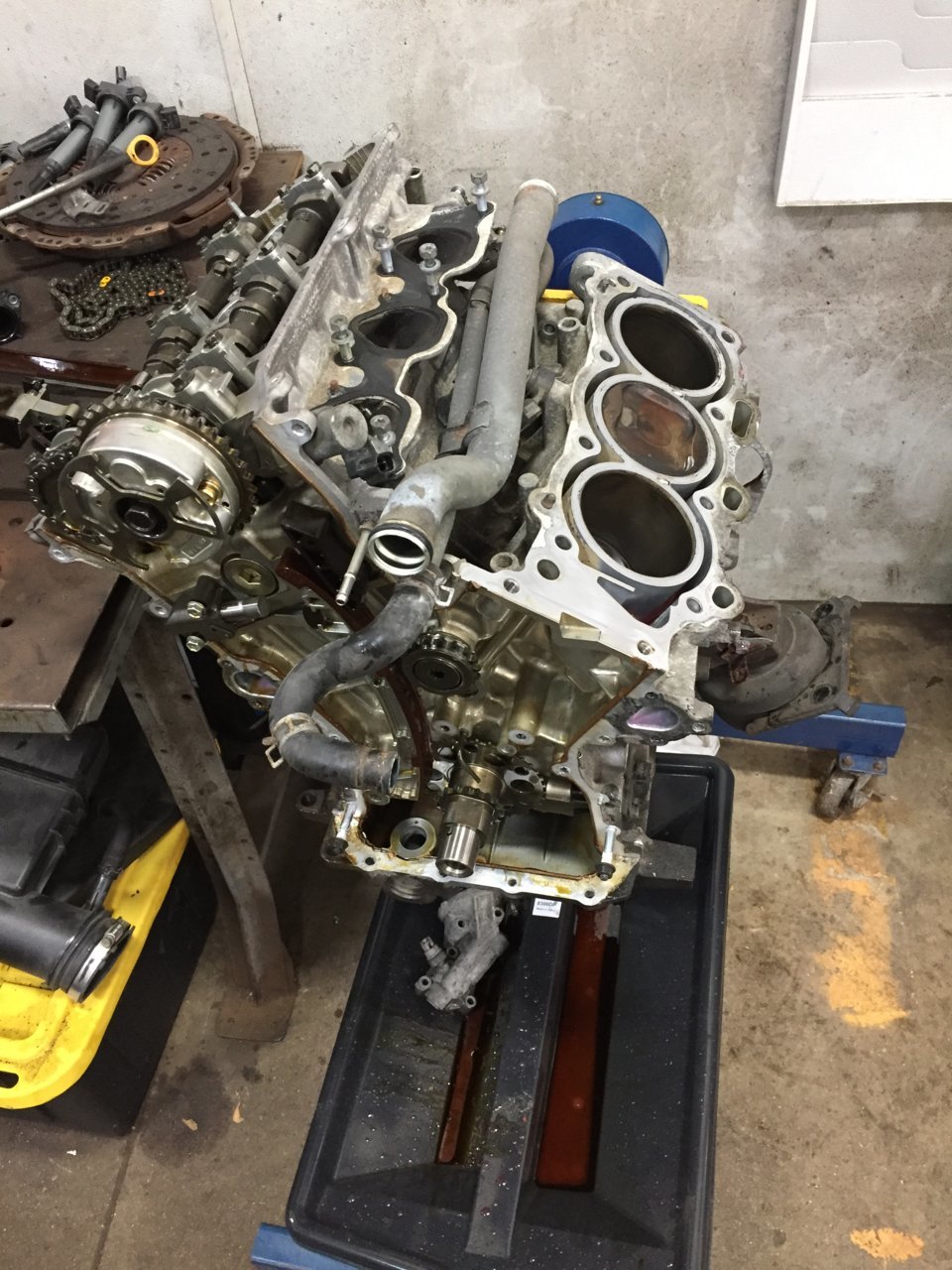

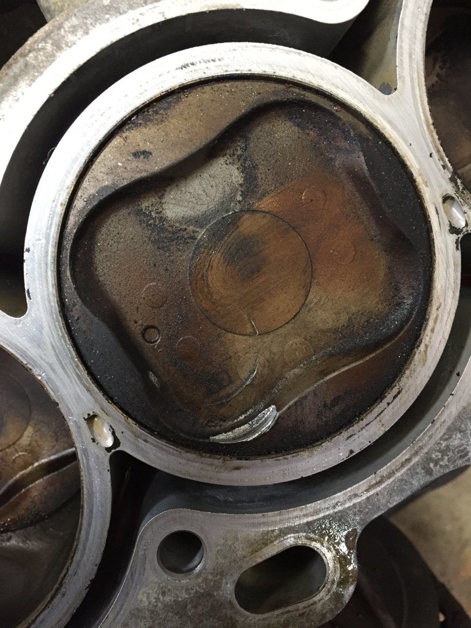

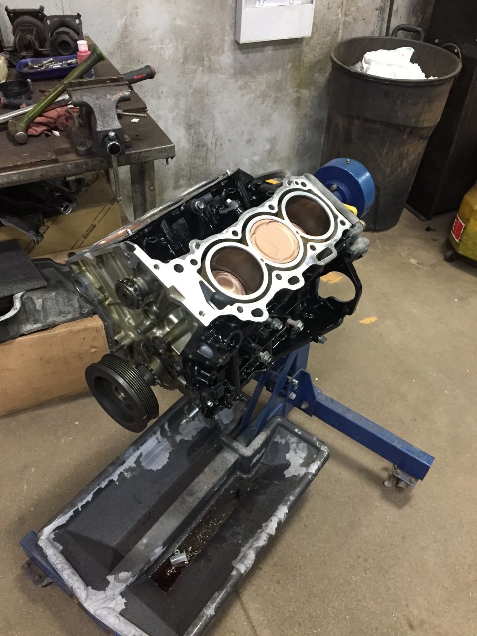

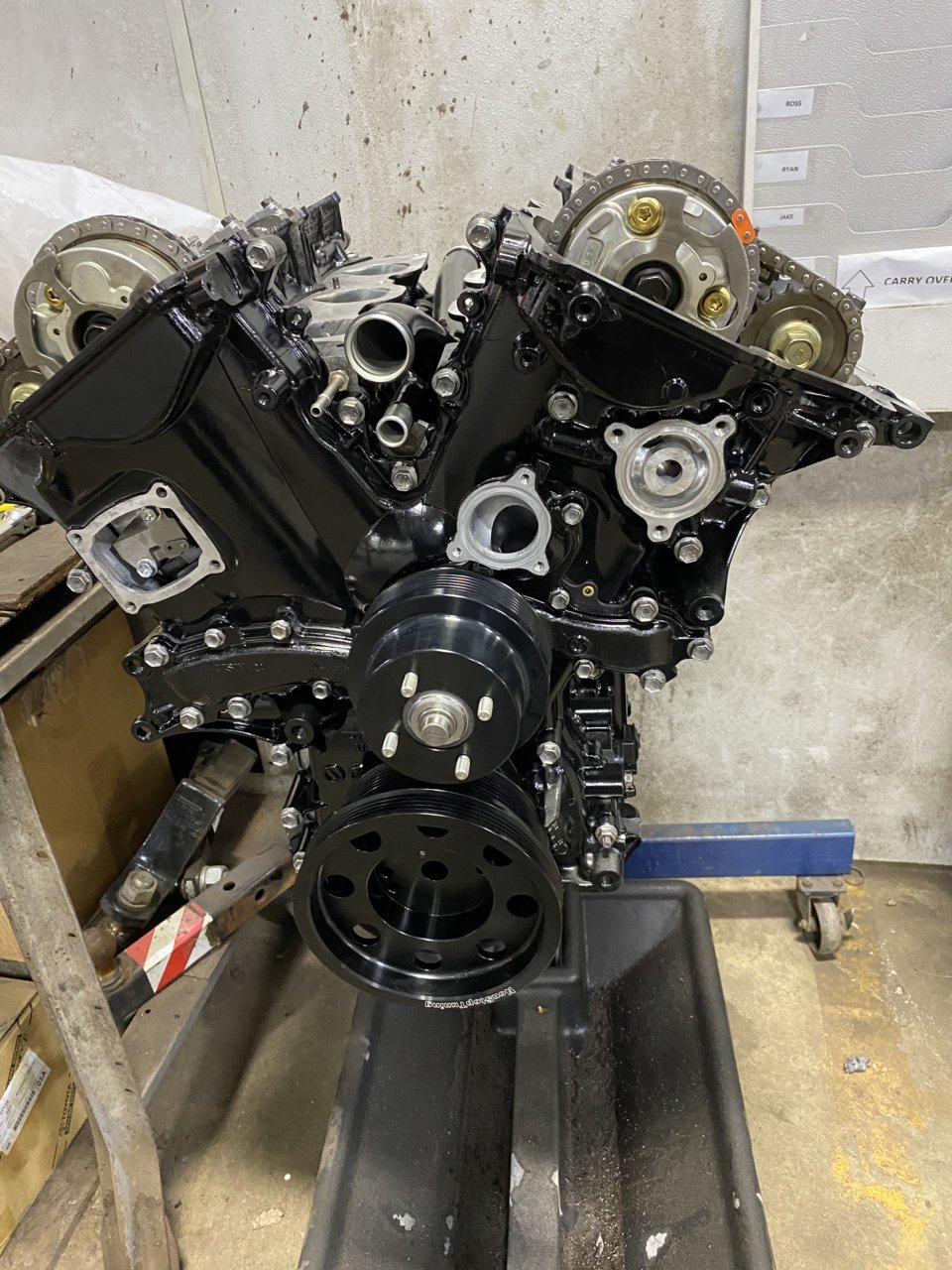

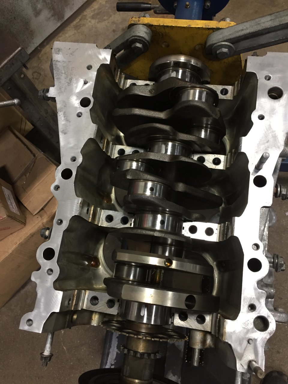

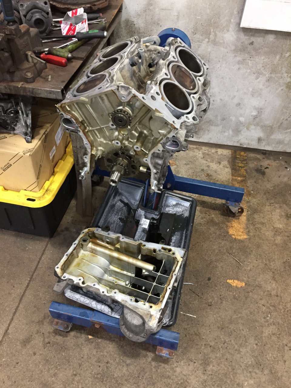

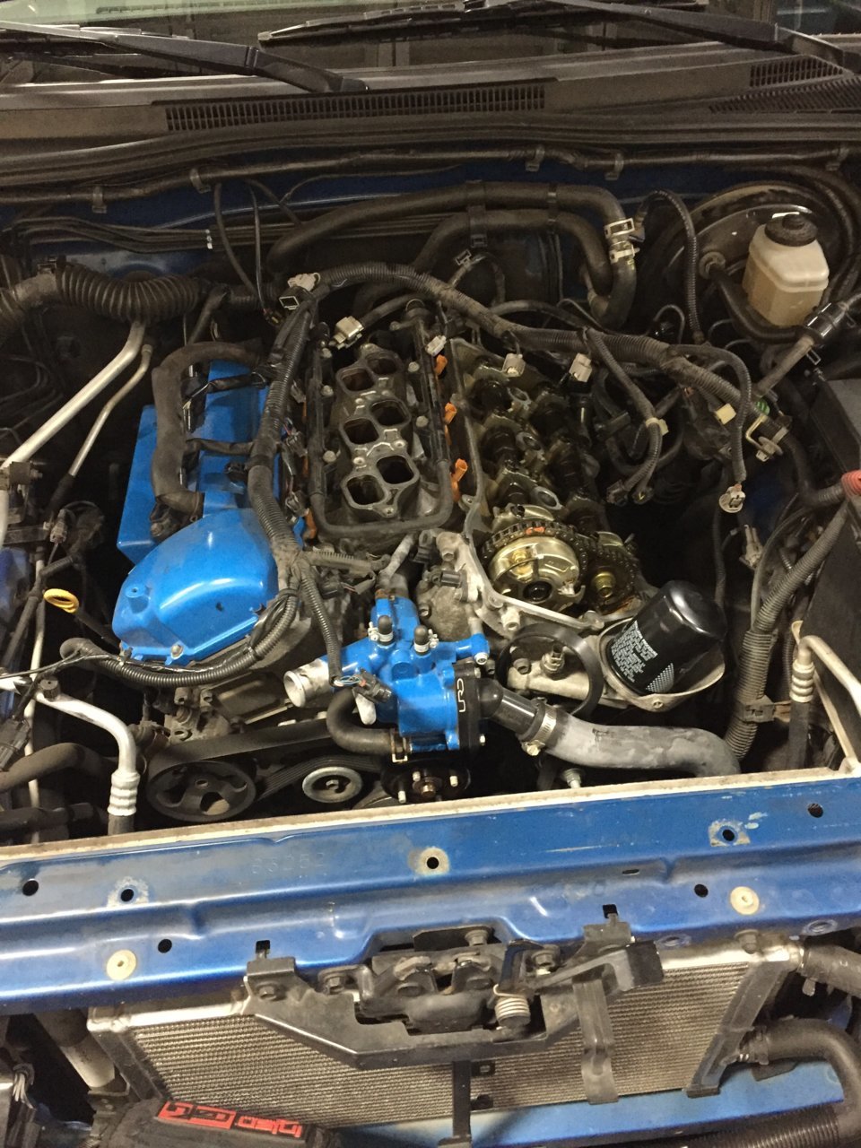

    Doing a on-ramp pull one morning. Regular thing for me. Rev limiter shift. And cel started flashing after that. Didn’t have any power and couldn’t go into boost. Said f it and continued 20 min at 80mph to get it to work. Praying for a bad spark plug or something easy. Misfire on cylinder 4. Checked the plug. Looked fine. Swapped plug and coil and still there. Decided to do a compression test. And 0 psi in the cylinder. Tried using a borescope and couldn’t see anything. Knowing it was either valves or a bad piston I knew I needed to pull the motor anyways. So it started.80676DA0-F2A3-466A-B8A8-F1ECA3FE5E76.jpgVisually checked everything first and noticed one exhaust rocket had no play and knew something was wrong with that valve. 41F0C656-F588-4670-BEEA-C3EB2190F514.jpgA7EB88AB-E4E5-4128-9326-AC98F3498991.jpg B9D52BEF-C953-40B1-AEA9-66C7B0DACADD.jpgAnd the tear down starts. Luckily I can do this all at work in the heat.
    BC36D934-C19A-47D4-BDFB-0ED352C4A58D.jpg A32F0FBA-728A-4D9D-9AAE-EEA1F03F963D.jpg 29017330-F2C0-4422-A647-6B846F986602.jpg

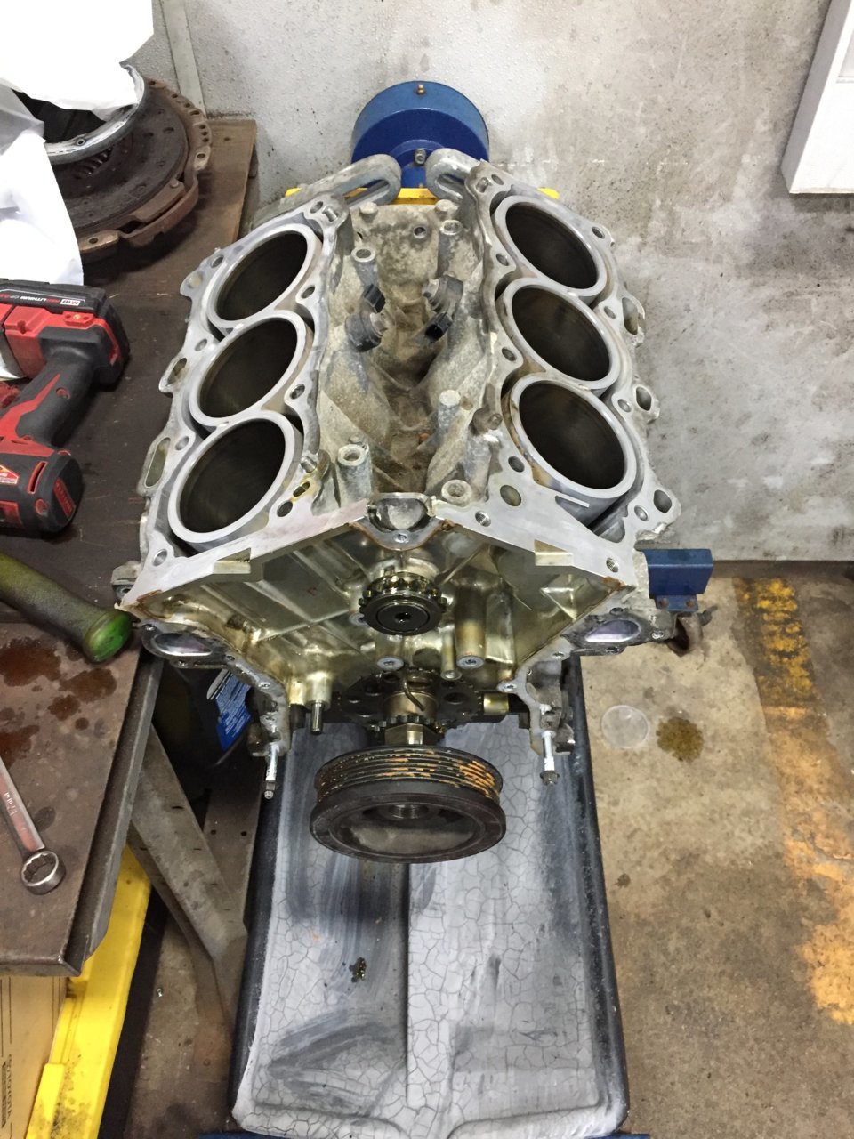

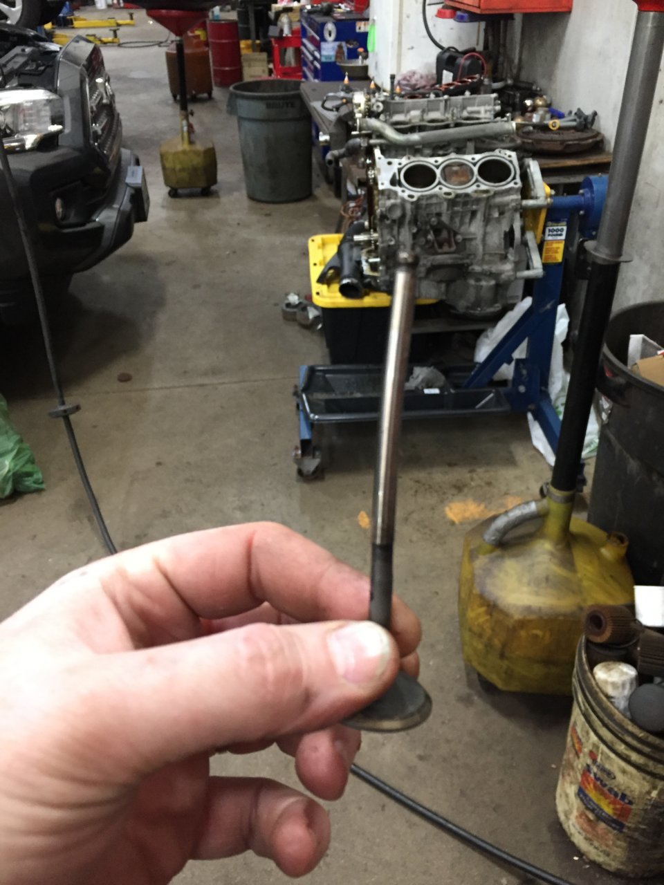

    Looks like an over rev. With a weak valve spring. Keepers fell off and let the valve go and piston smashed it. Not much damage and easy fix. But where the fun in that. 8ADDEDB8-4F80-4D01-896D-710BB0C25DE7.jpg2F234BEB-C450-4F20-B45C-20C670F8AB63.jpg A3EADF5B-1018-42BE-9D42-3B90FF43B1AA.jpg 0703DF70-3269-454A-8458-B183A209243C.jpgn
    Started ordering parts...

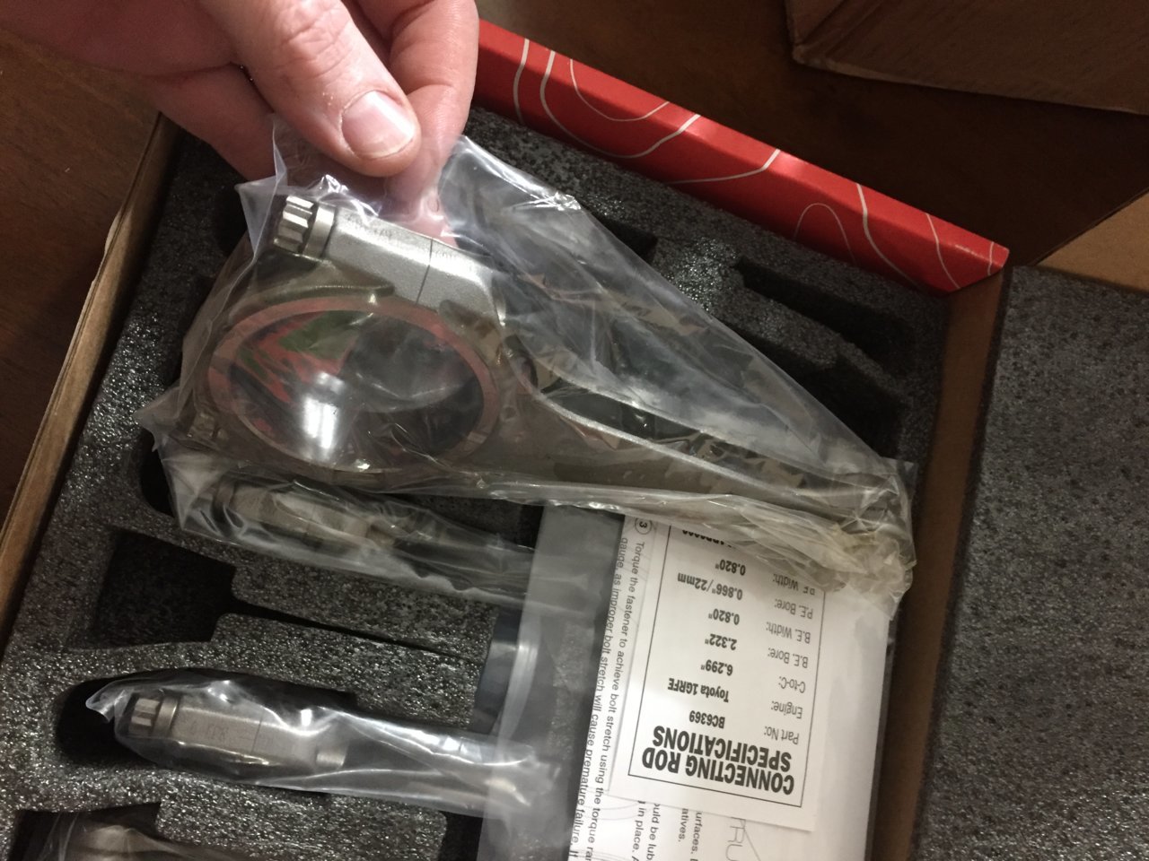

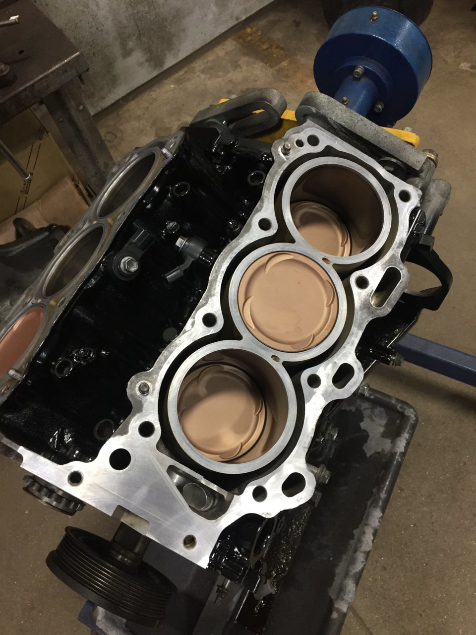

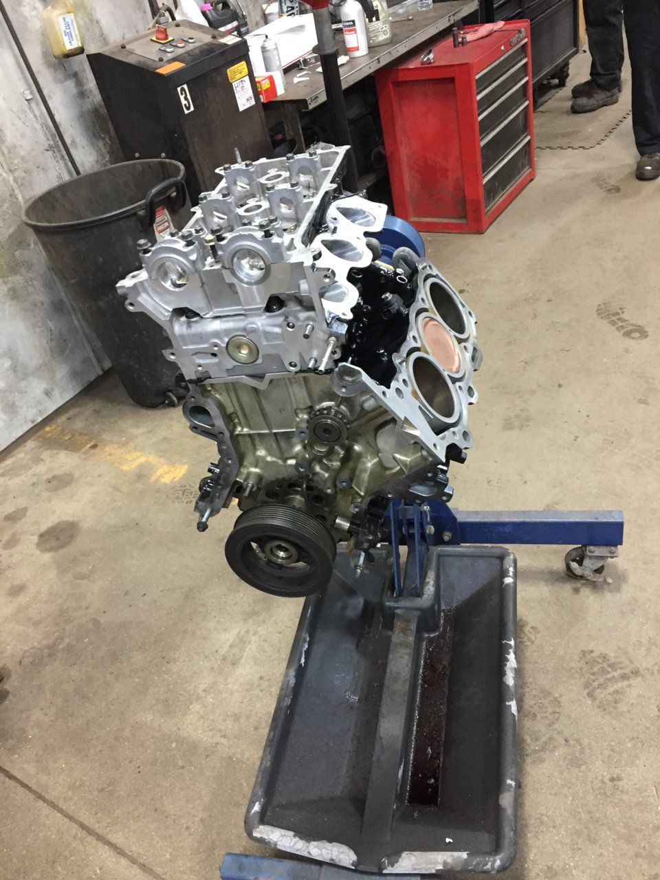

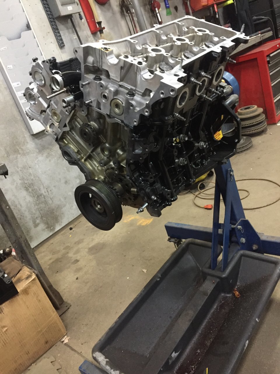

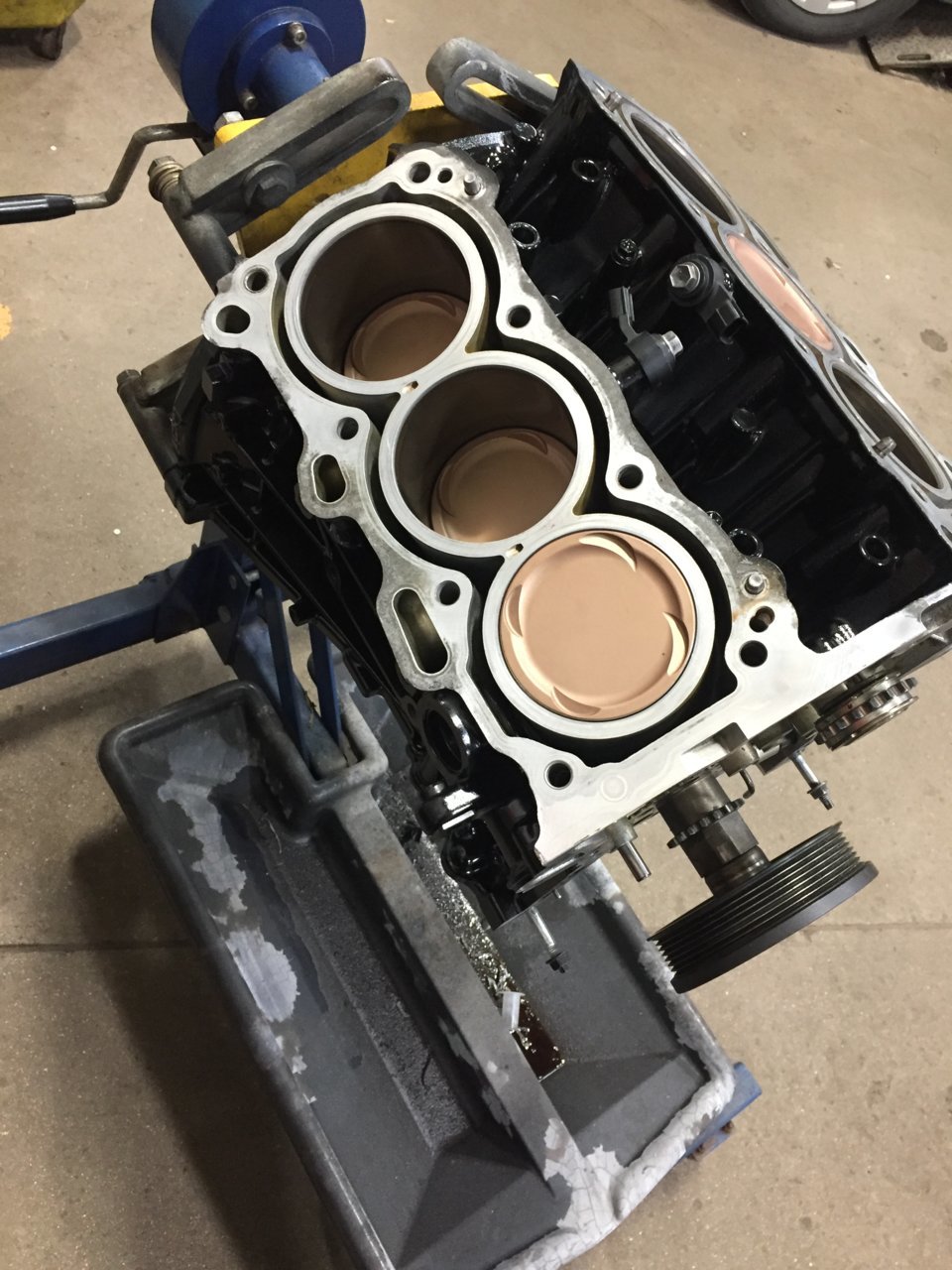

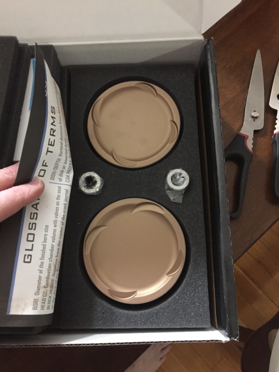

    Cp pistons 9.5:1 compression and ceramic coated. With some Brian crower rods.23250E91-B2DB-4E9A-9A62-8187F7EB8A80.jpg55959AC3-AB29-4CB3-9C6E-C12A22B57E59.jpg 4DEA2EE3-3581-433C-BB2F-9474F9FE784B.jpgD37B00FF-1253-4BDD-83DD-7C2A6E83FBD6.jpg Still have tons of parts to order but starting to go back together. Ordered new oem crank bearings and thrust bearings. Plastic gauges them to make sure they were correct. F95A325F-E3A9-4D75-AE44-CD6C8339B490.jpg

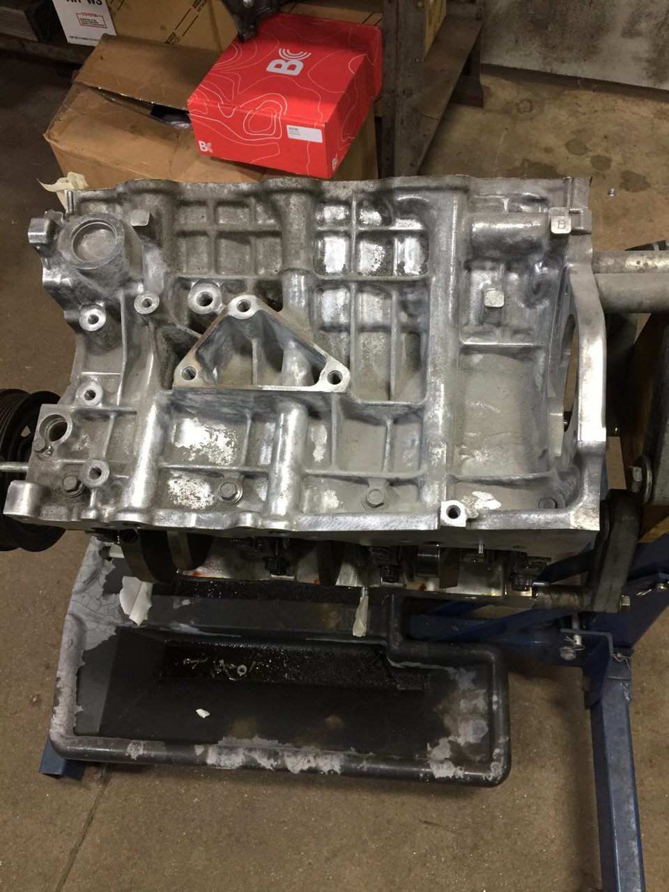

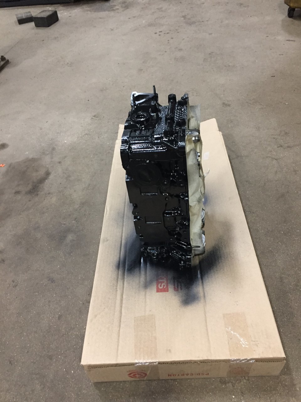

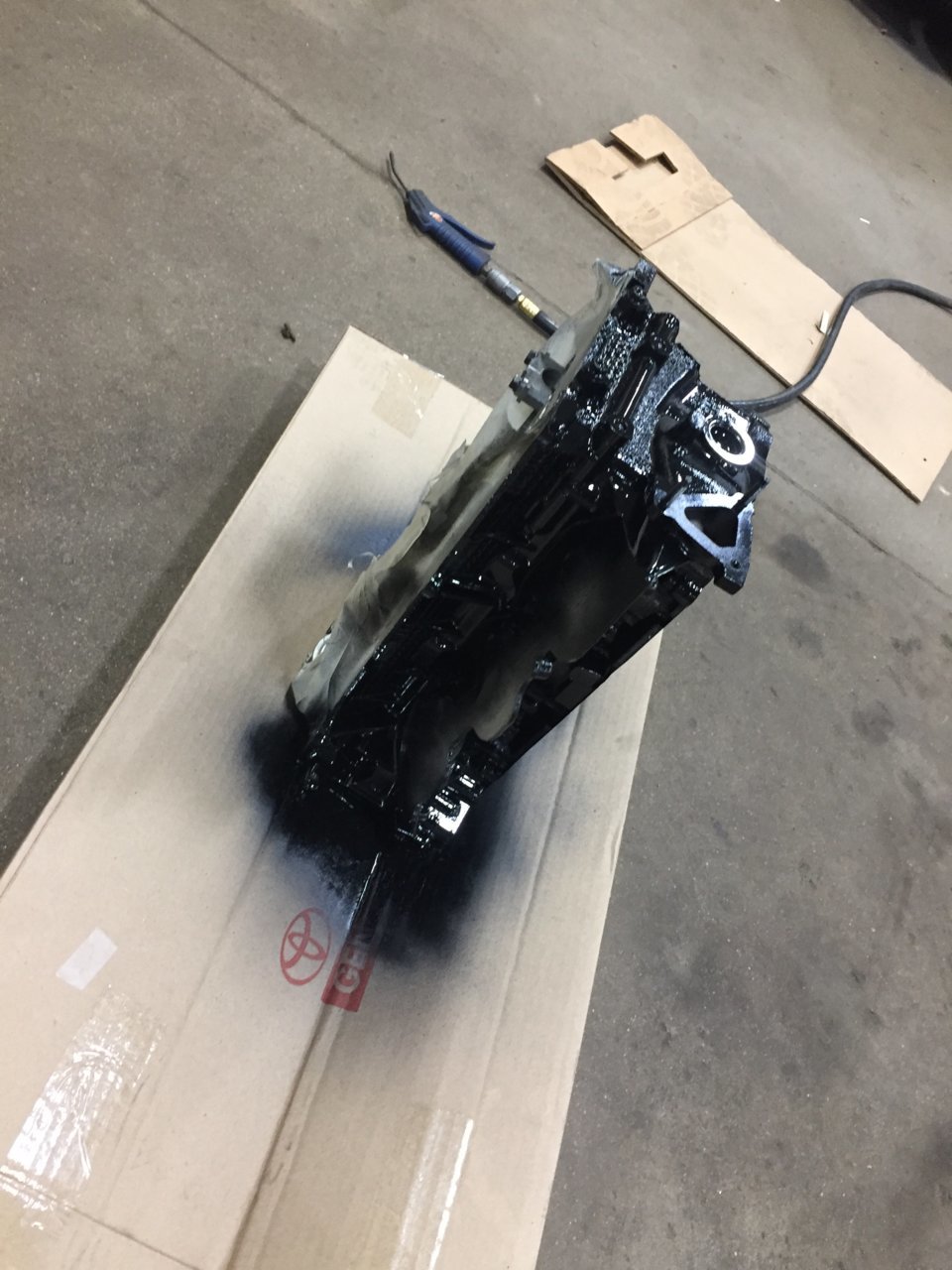

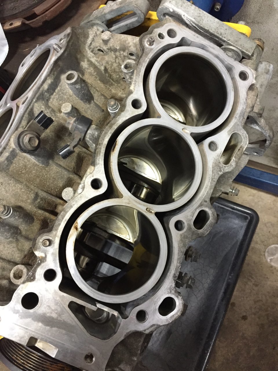

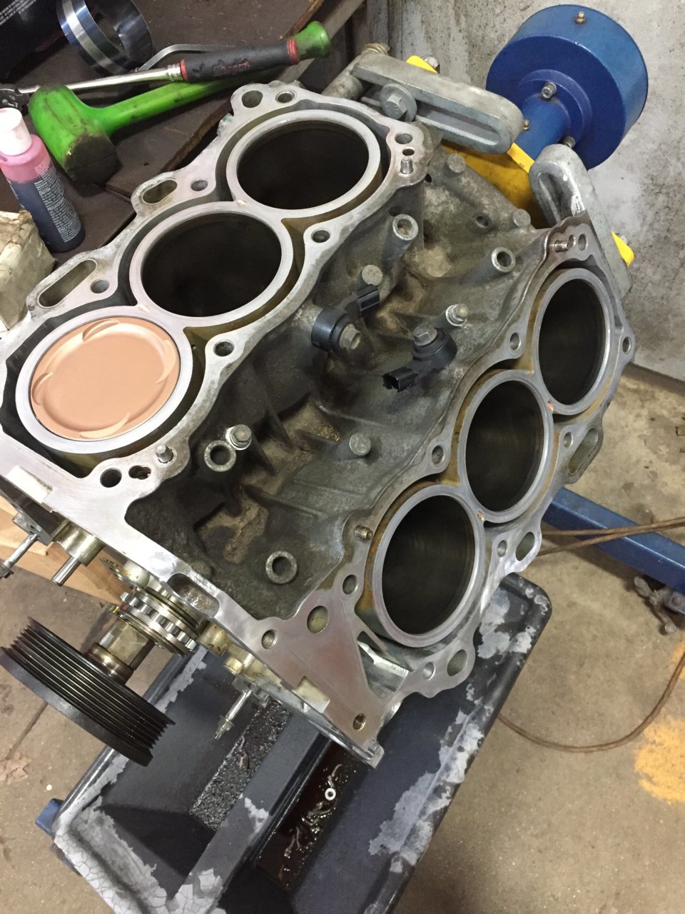

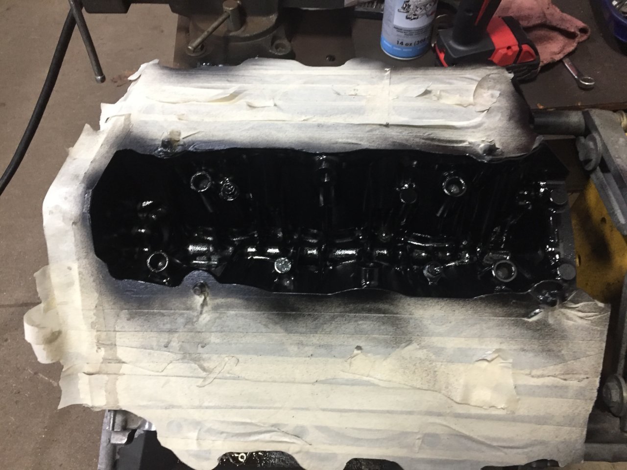

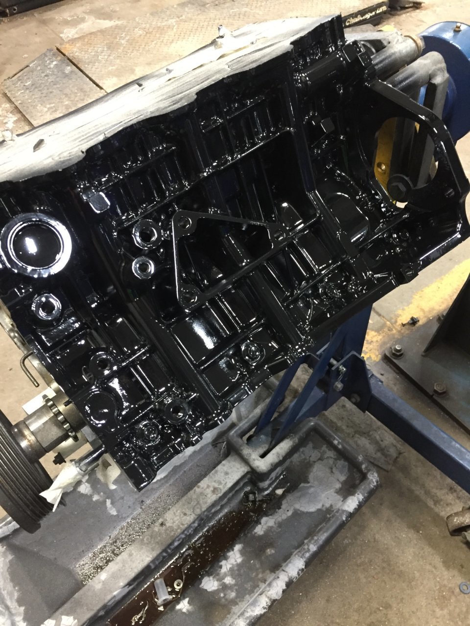

    50848E56-AFB8-4A23-86B1-09C6255FAFE8.jpg Got one piston in. Decided to take a break and get it painted first. Takes a long time to clean. BA9973A4-69F4-436D-B670-70C70970448A.jpg

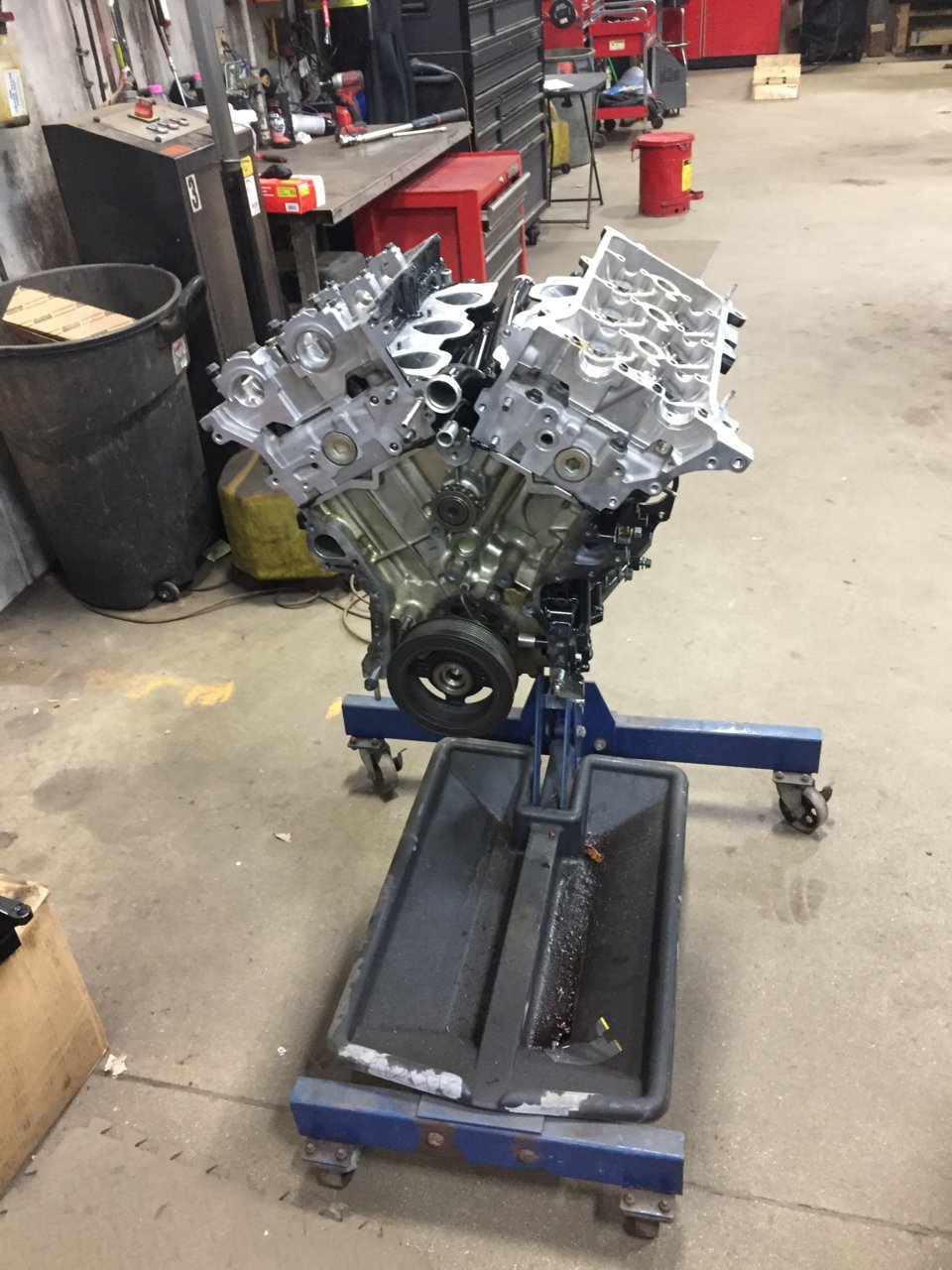

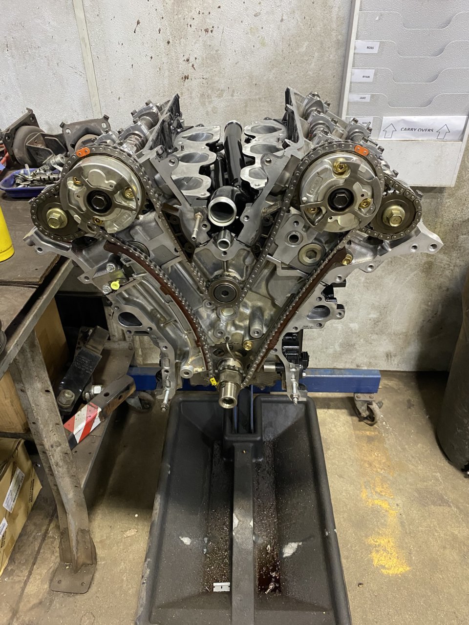

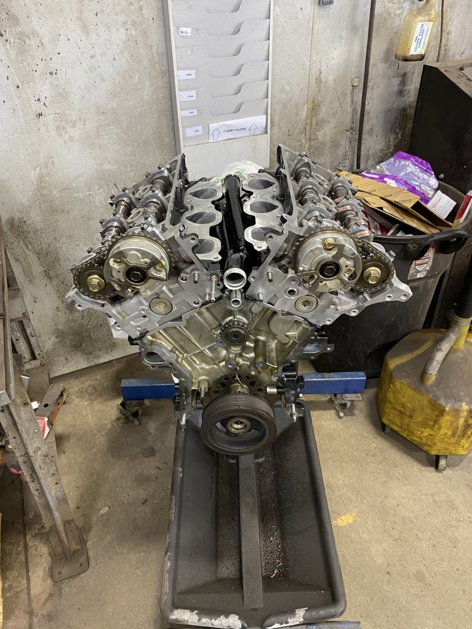

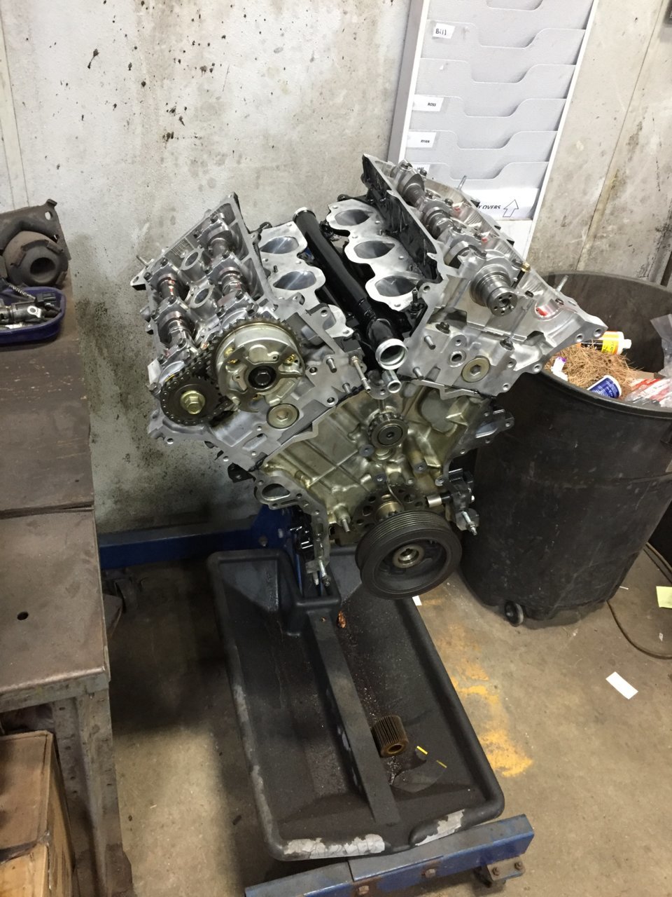

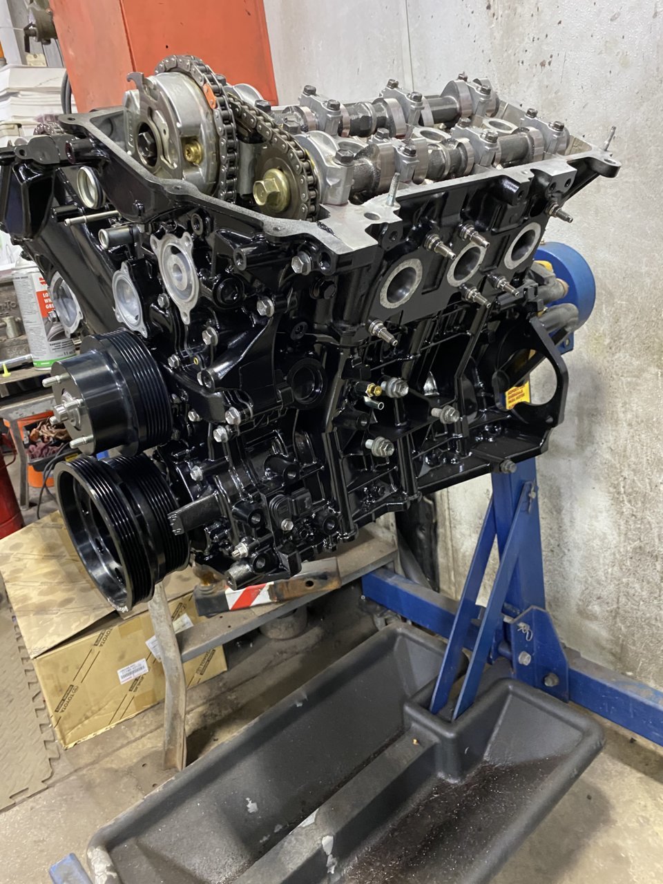

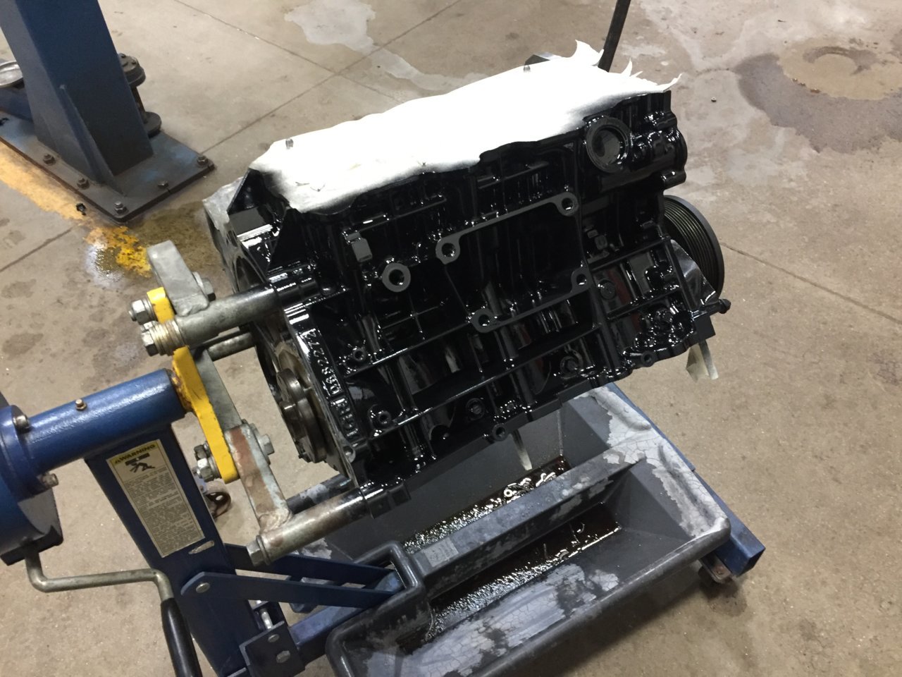

    Finally got all the pistons in. Motors all painted. Just ordered cams. So will have to start playing around with heads next.21A16892-8DE9-4353-BD1F-E22AC164DA12.jpg161ACFFE-7804-4D21-8E3A-784352872CD0.jpg 3280A18F-8BEE-4610-B2B7-F14B54DFA825.jpg

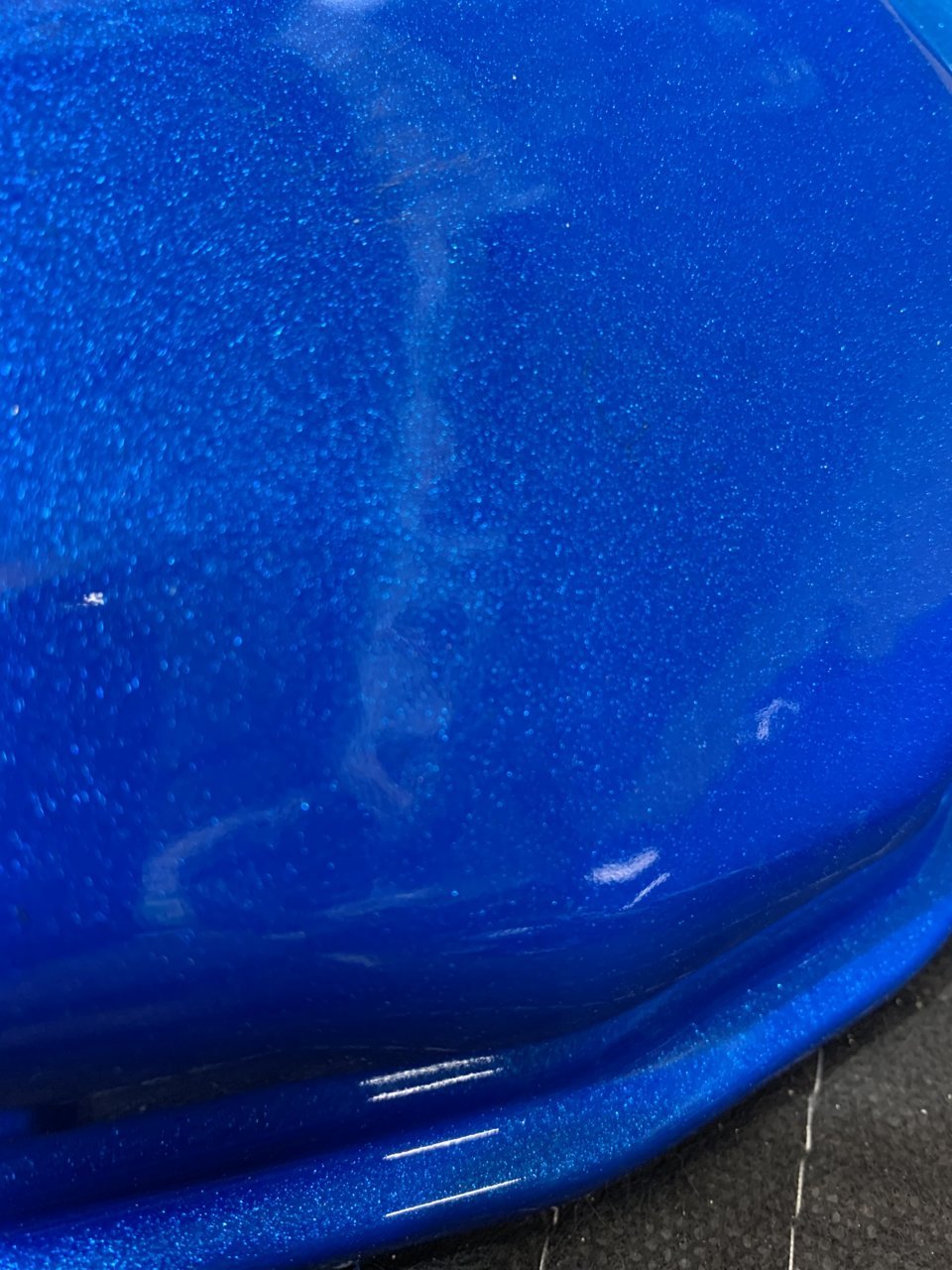

    Also got some stuff back from powder coat 87A84728-EEF2-4DB5-A218-51DAAEF5528F.jpgD9A0A275-DDF9-436C-A92E-6018FCDEF6B7.jpg

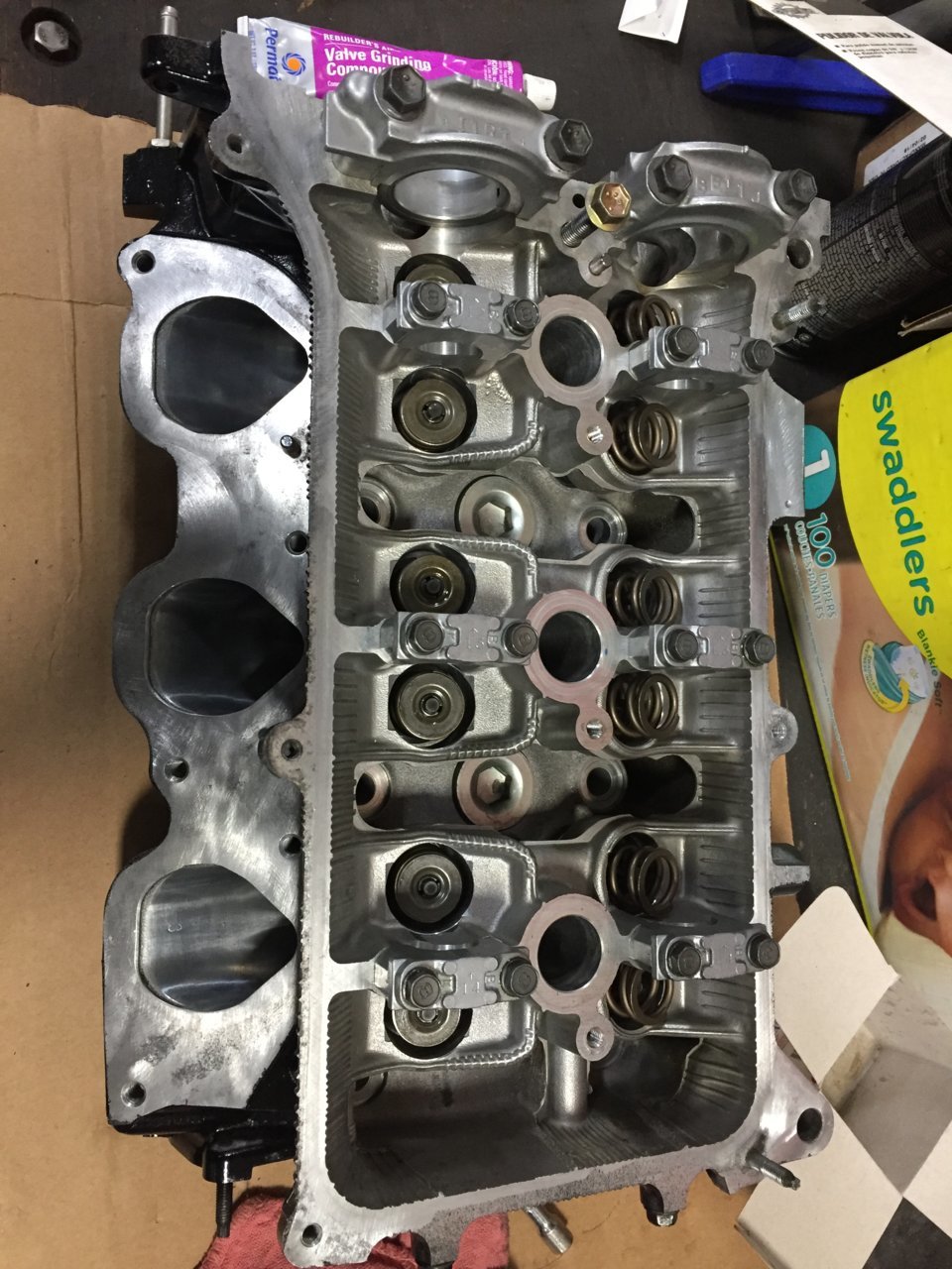

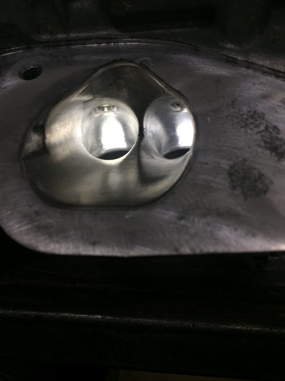

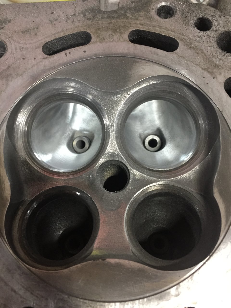

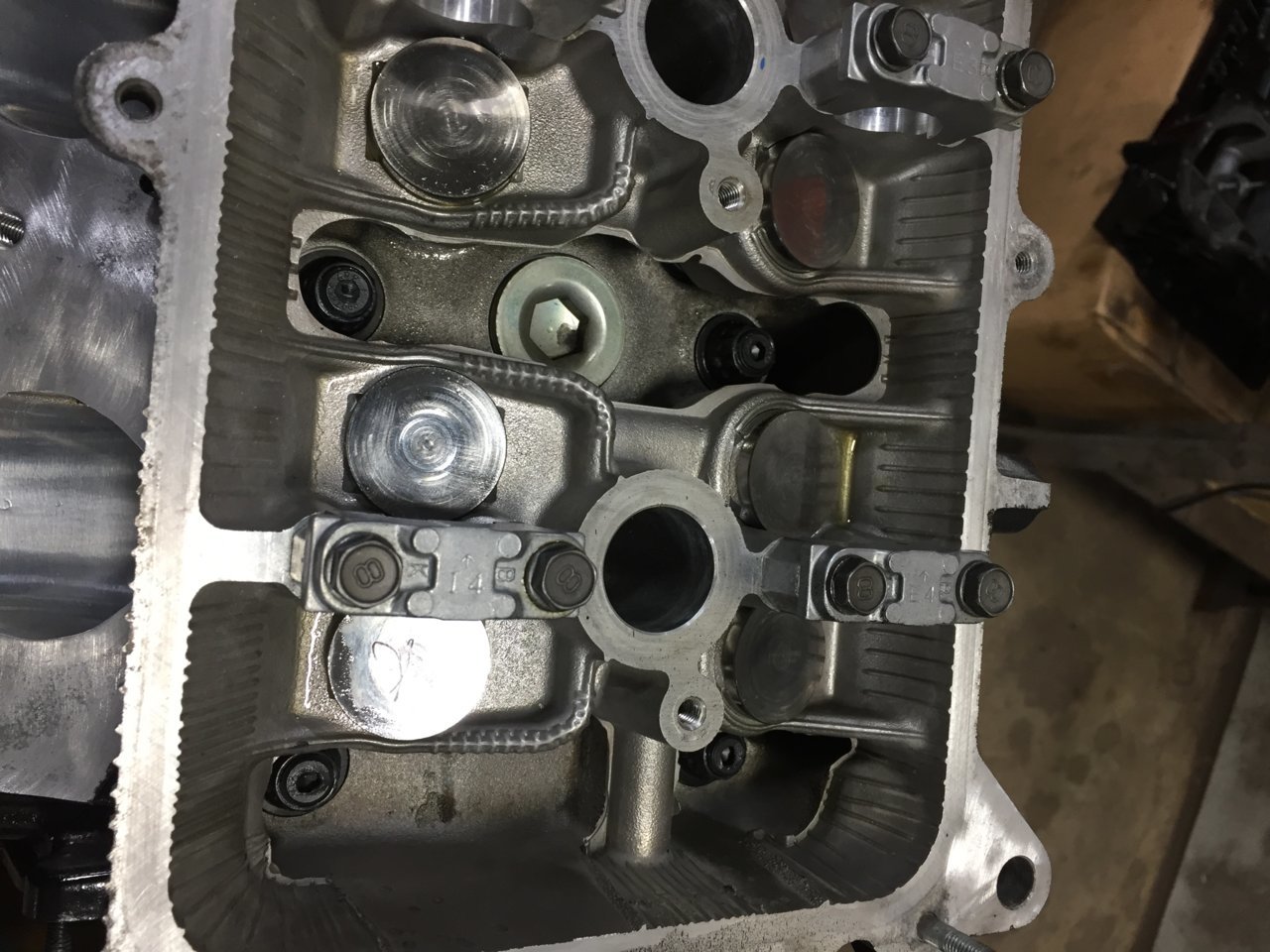

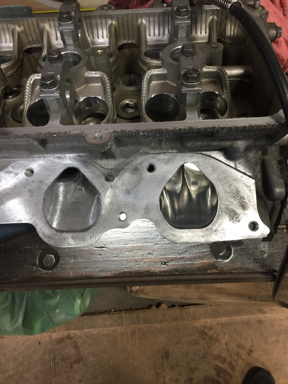

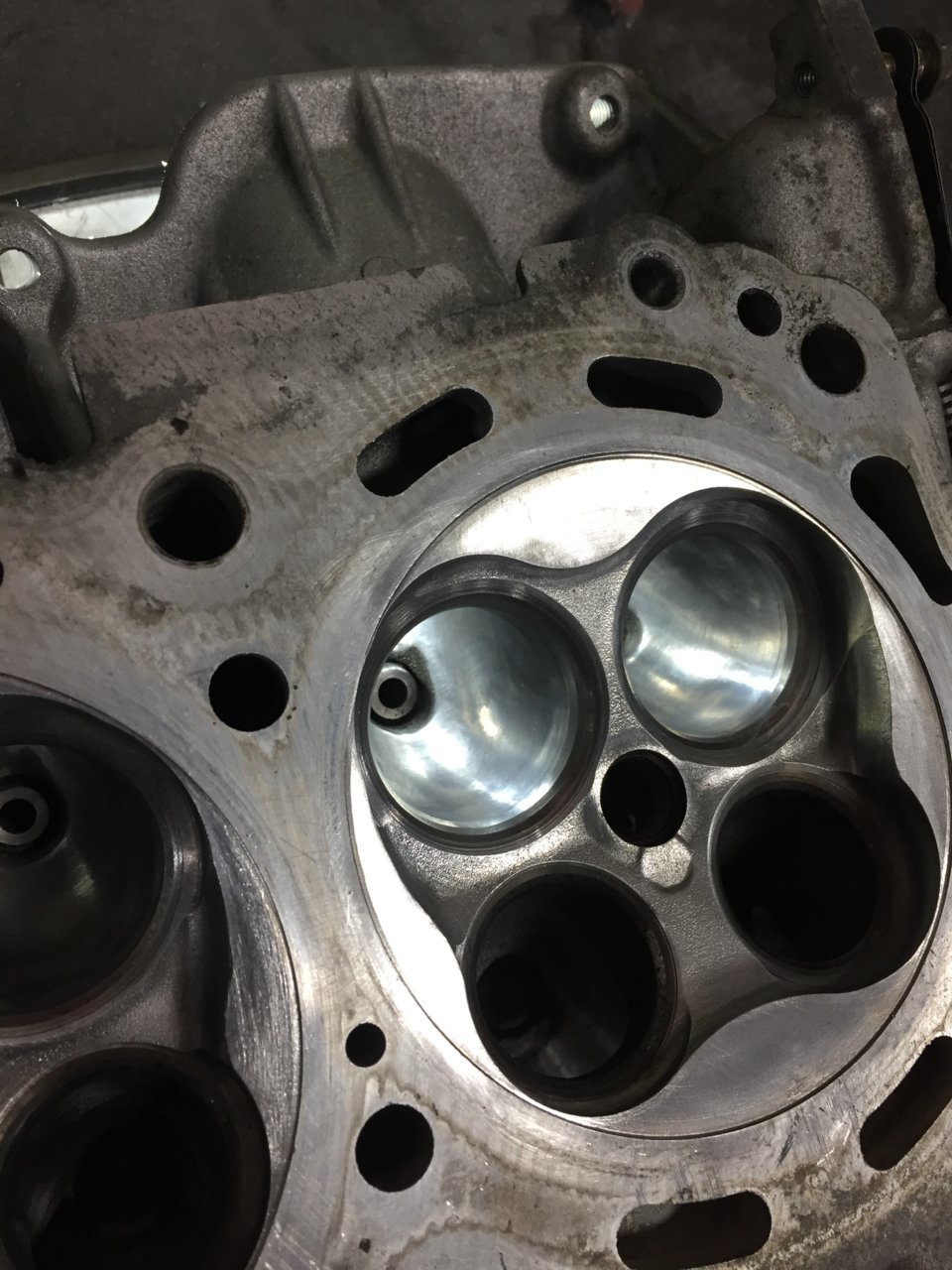

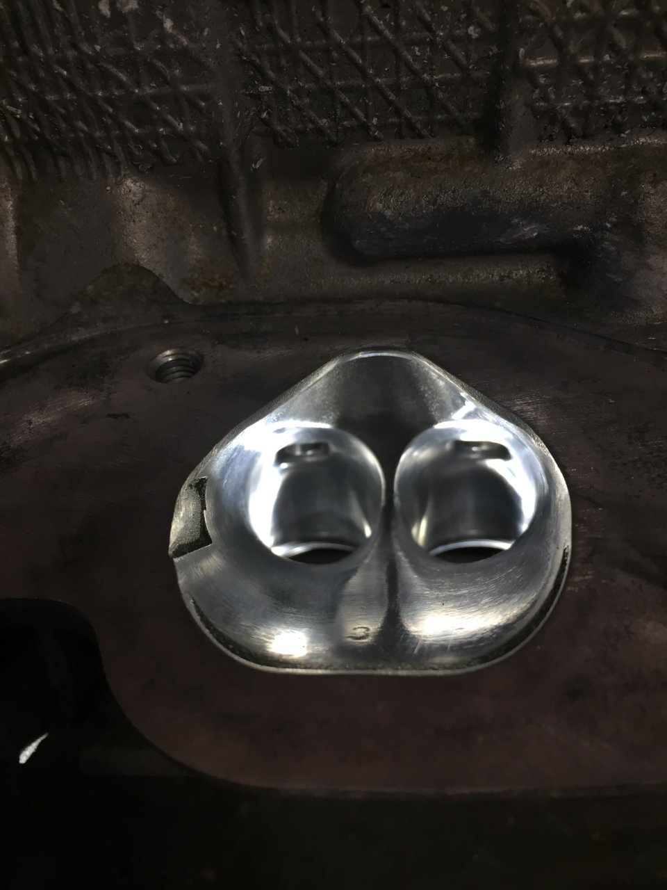

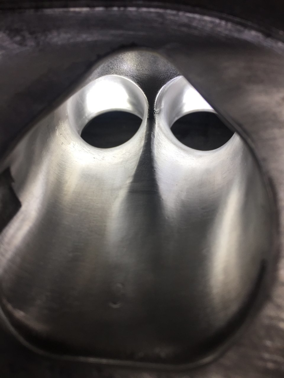

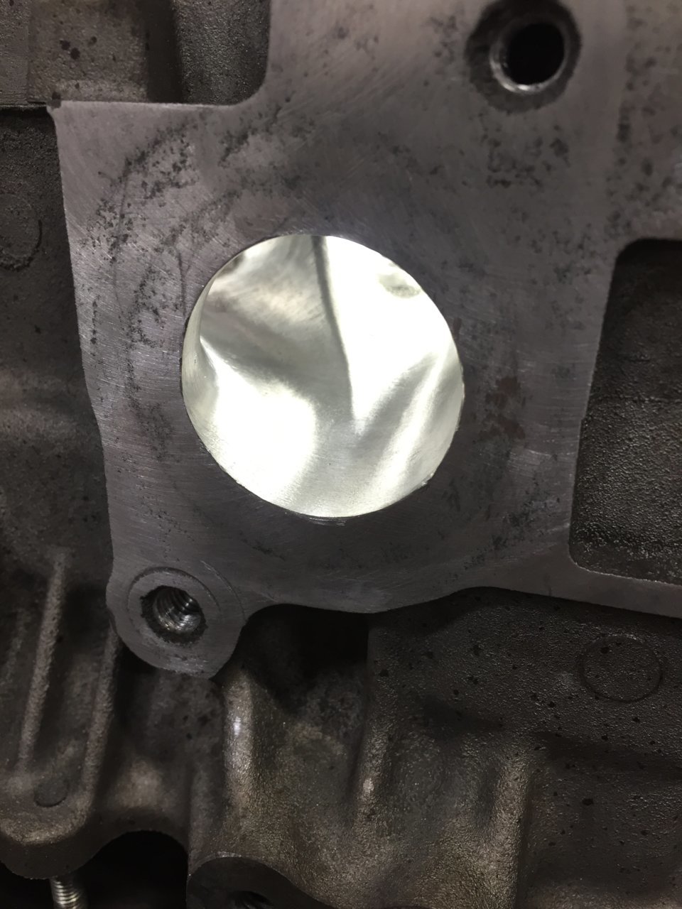

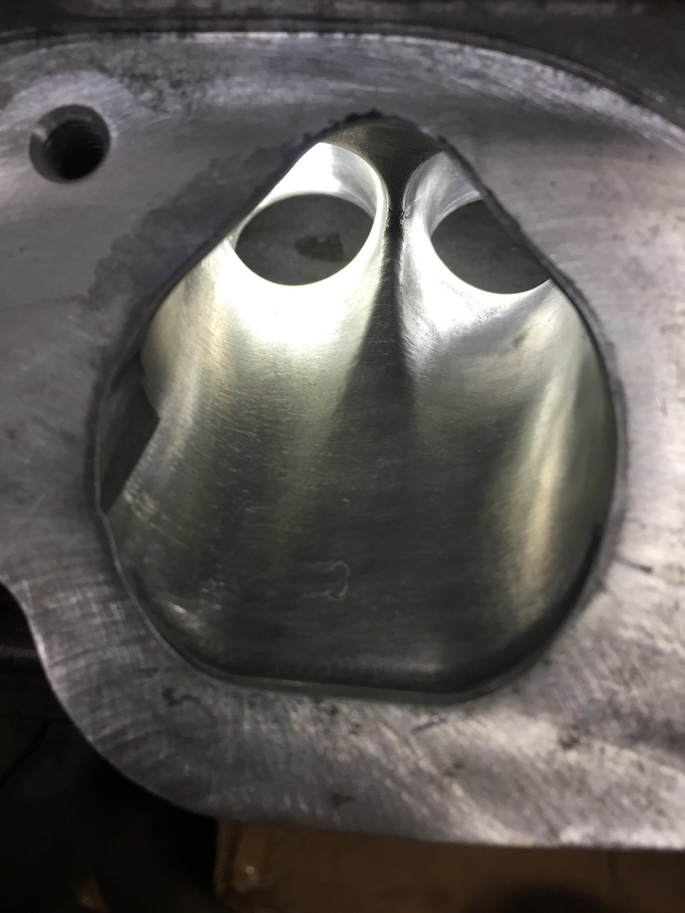

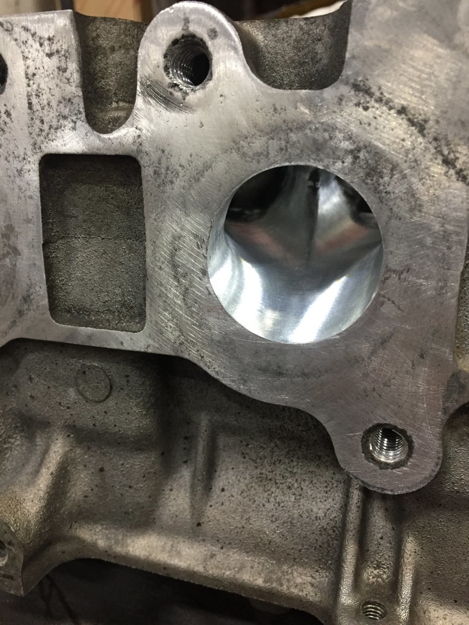

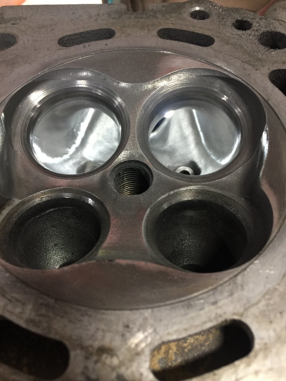

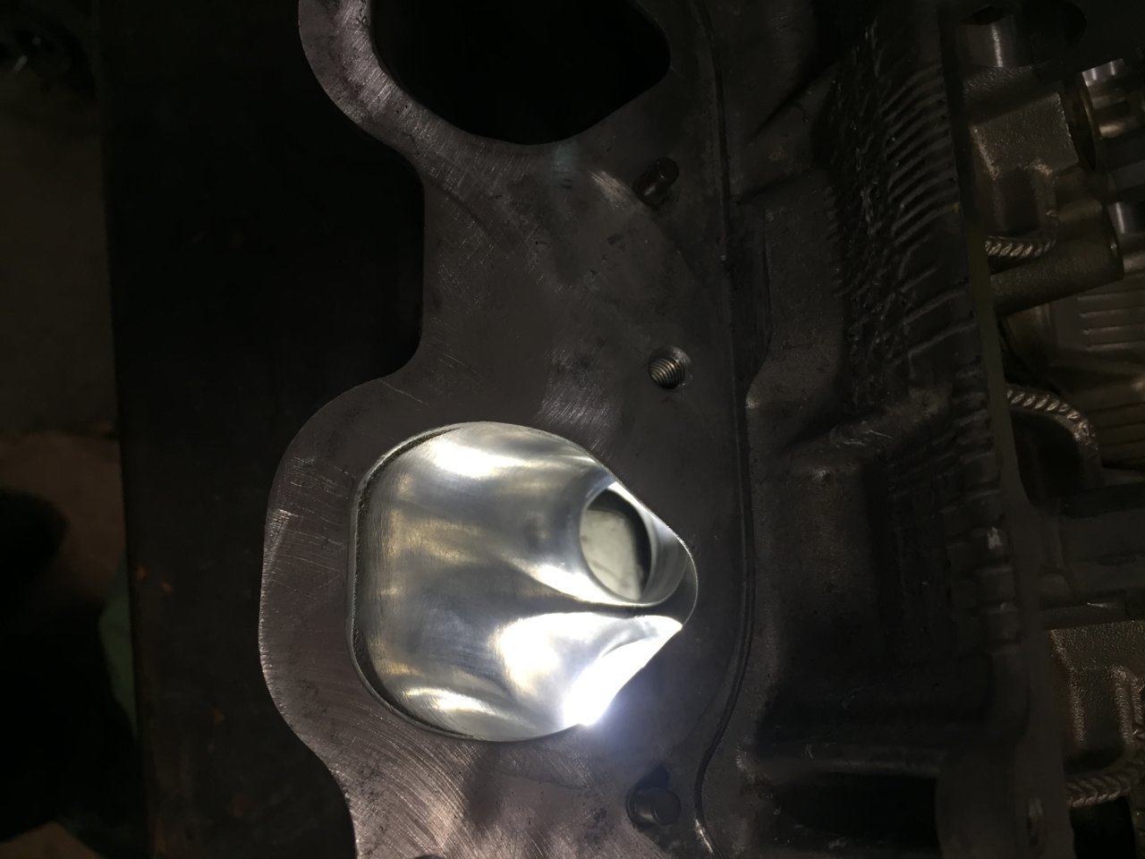

    Some more updates. Cams came in with springs. Head work continues.D10457AB-9DD1-43A4-A4A5-5855A9E9DFB6.jpg55114682-3A8A-4784-9746-0393CA94CCDC.jpg41814EA2-4A04-4631-9AFE-2FFA5BFAE950.jpgF60F3D19-DC4E-4AEA-9353-3EF3828C2EF8.jpgA4260C04-6116-4DF0-80A7-94C54B542208.jpg62693006-46C8-41B8-9DFC-041EC2F1D412.jpg70090B65-F9C6-42E9-B667-D3A8B48C4B32.jpg41057F06-7502-446E-8DB2-36B1667E1C6E.jpgAB000A3E-A4BB-40DF-B3F1-D715582D5858.jpg695FB130-63B8-4022-95EF-410D13852723.jpg

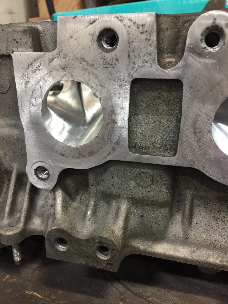

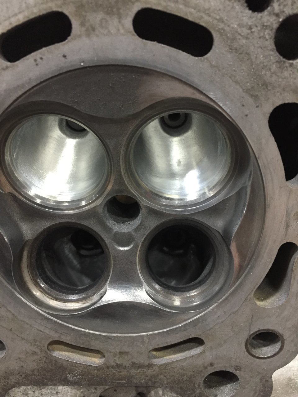

    Got the intake side done on one head 179468EB-3207-4B54-AA69-1FCCAACA0200.jpg33B95A98-D11A-44FA-9EED-A0A869D5AF58.jpg 85948625-1AAD-40D8-BAE2-46E50EF93878.jpg9884C851-B45F-450D-B83B-C26524A316B1.jpg

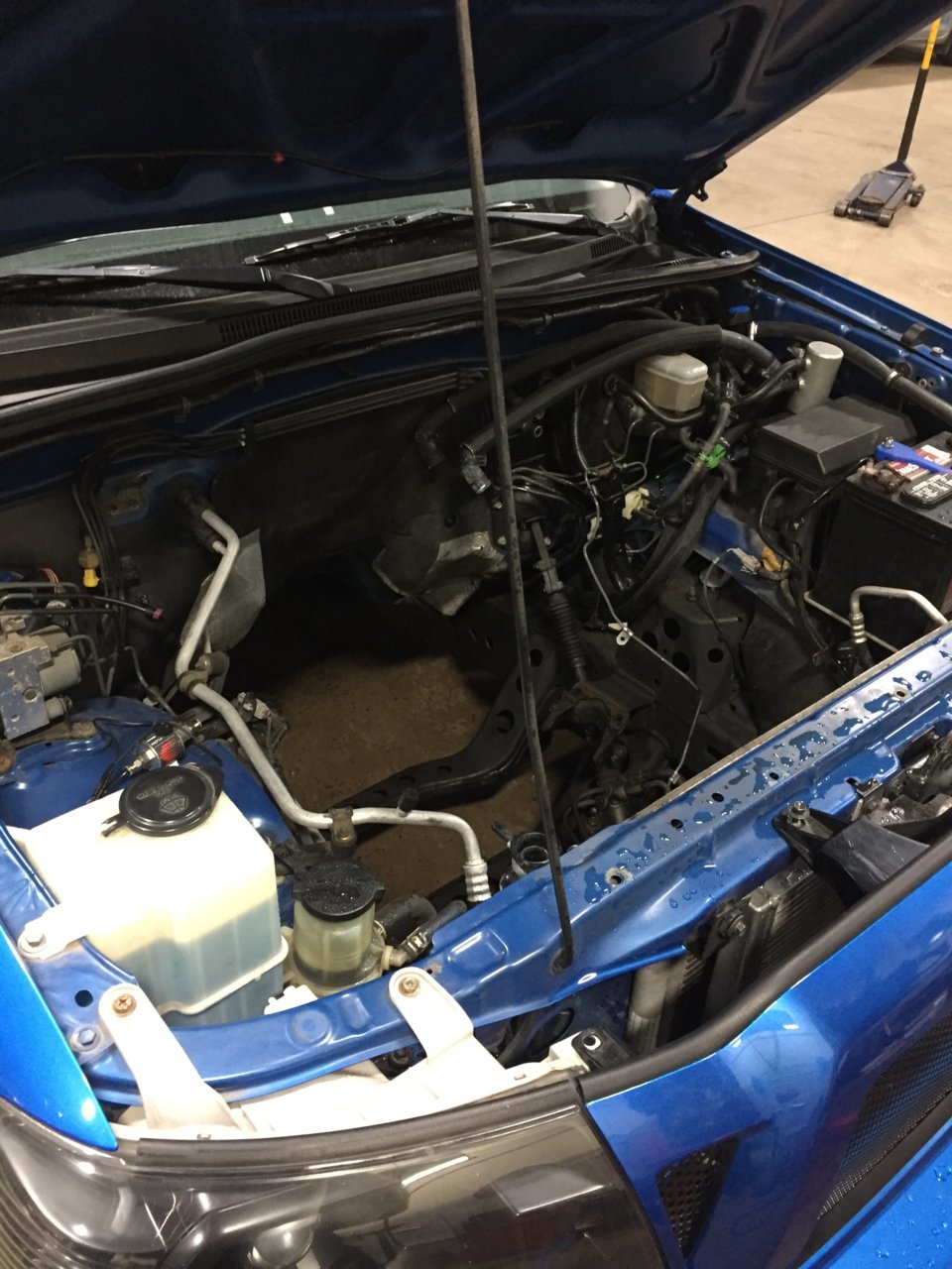

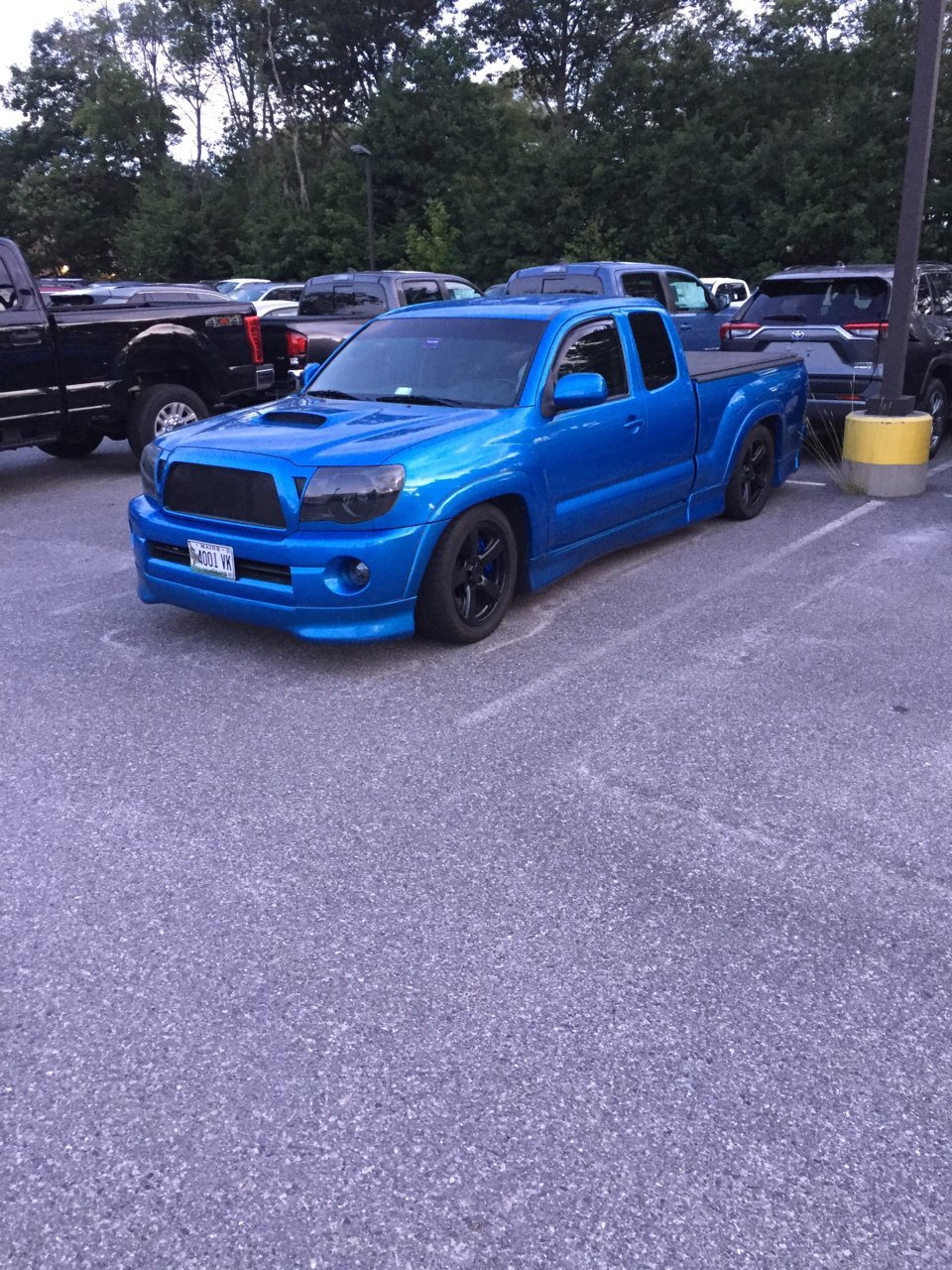

    Havnt updates in a while. Will just throw some pics in here.

    Curious as to how it turned out? Hows the power on it?

    The last picture was taken today lol. Still got a ways to go
