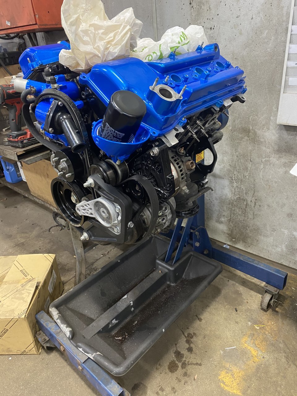

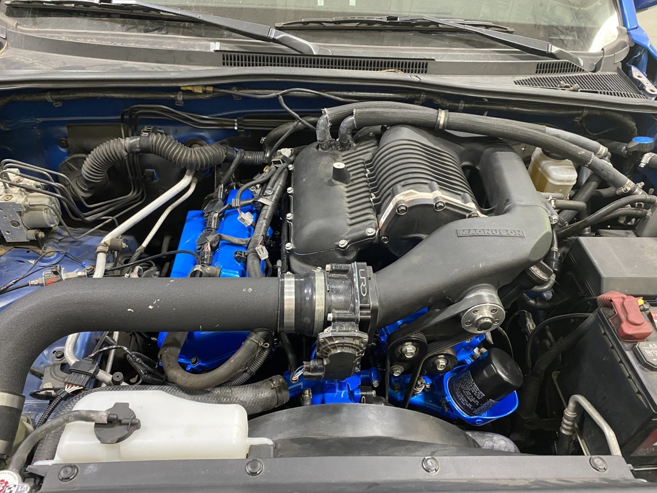

    Just have the tank in the bed with another pump right next to it. Run hoses from that right to the super charger. And then makes the normal loop through the intercooler up front and then back to the ice box. Got rid of the stock over flow. Also made it so I can disconnect the hoses to the ice box and loop them. So it’s just ice box to supercharger and back. And then the intercooler just loops back around cuz of the other pump out front.

    Okay. I don't want it in the bed, so my thought right now is to have it up front somewhere with solenoid valves so I can bypass the ice box using switches in the cabin.

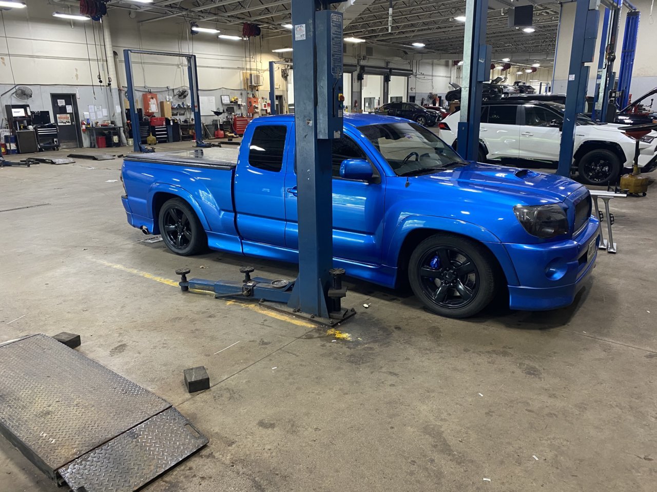

    Hopefully over 400. Yeah I don’t go south anymore. Use to go 236. I work in Portland now. So I get on the wells exit and head north. That’s where she broke. Lol.

    I see you got her fired up. Bad ass! Did you drive it yet?

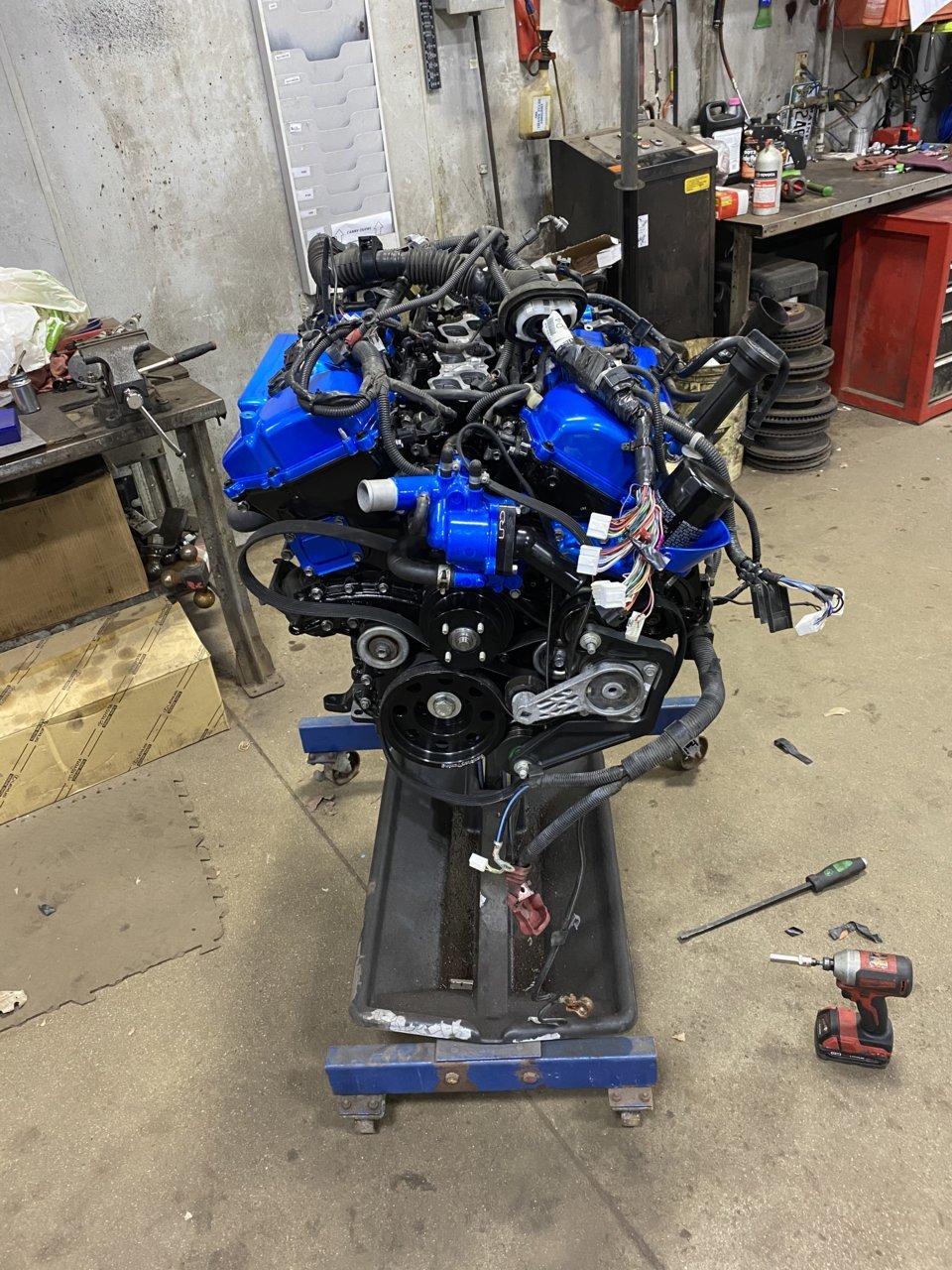

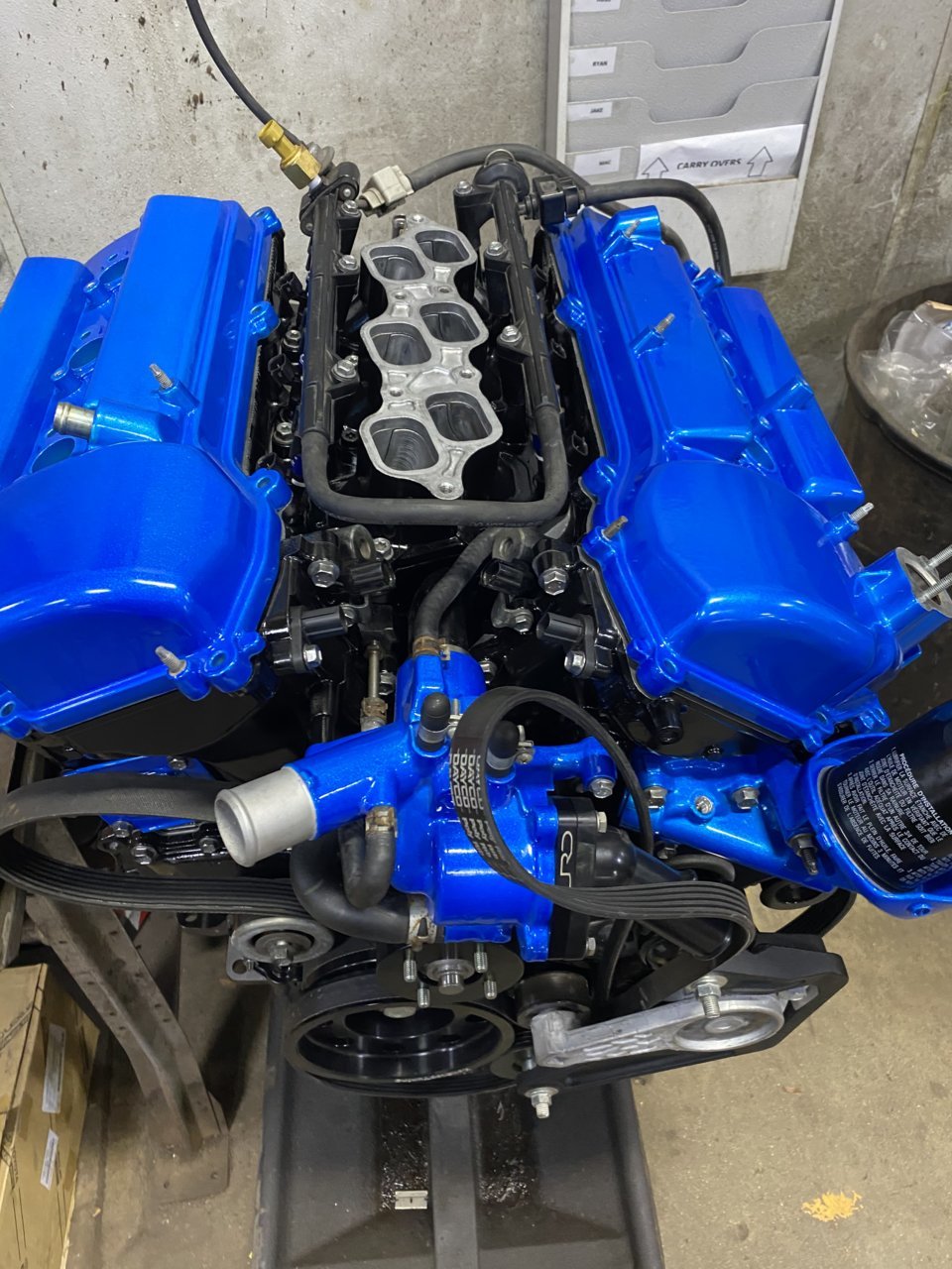

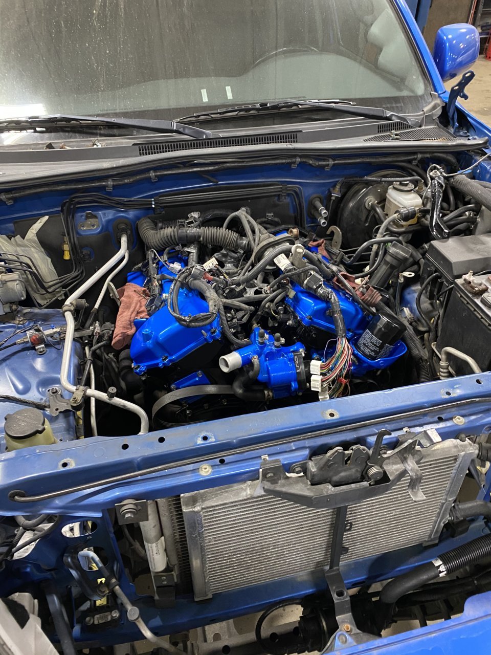

    Updated pics

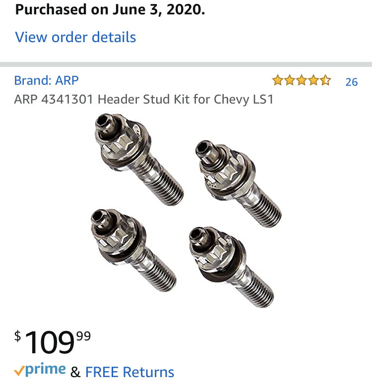

    What part number did you use for the Arp head studs, Arp exhaust manifold studs? Thanks in advance.

    Can’t speak to the head studs, but this is the set I used for the exhaust manifolds.

    I got the head studs off lc engineering. And then those are the exhaust studs I got ⬆️
