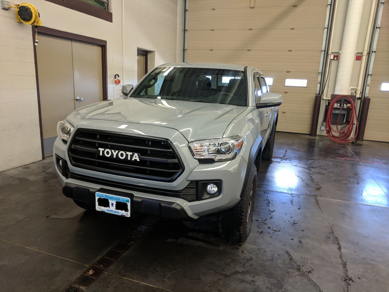

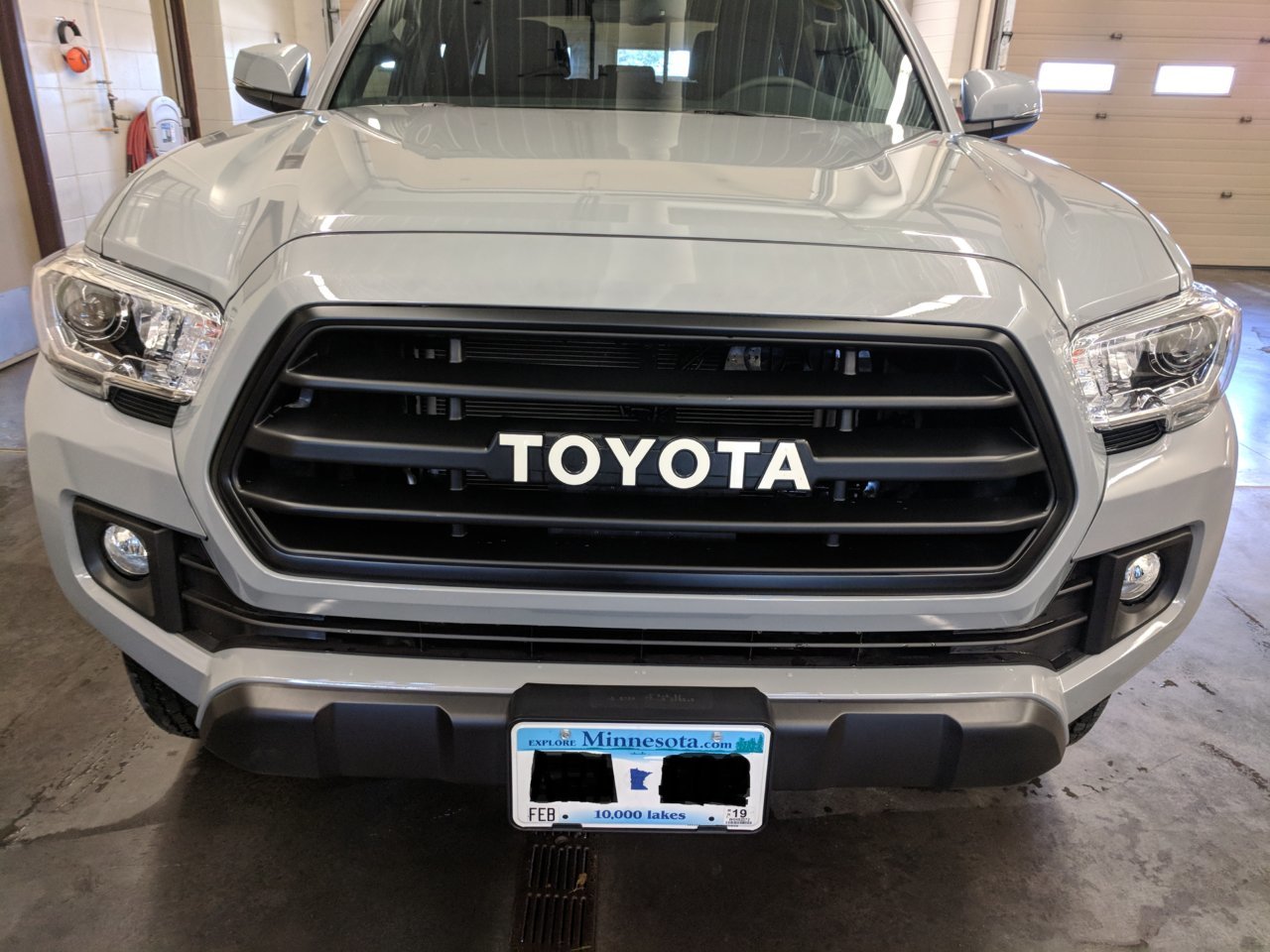

    Does this Toyota Emblem look familiar to anyone here? This is what I currently am using, but I am not sure what model Toyota this actually came from.
    It's not like any of the other Toyota emblems that are in this thread. I definitely would like to use the Vinyl Decals because this is actually already discolored from the sun and weather. [​IMG]

    That emblem does look slightly differnt than the ones i’ve seen. Looks like the same dimensions though so would probably work

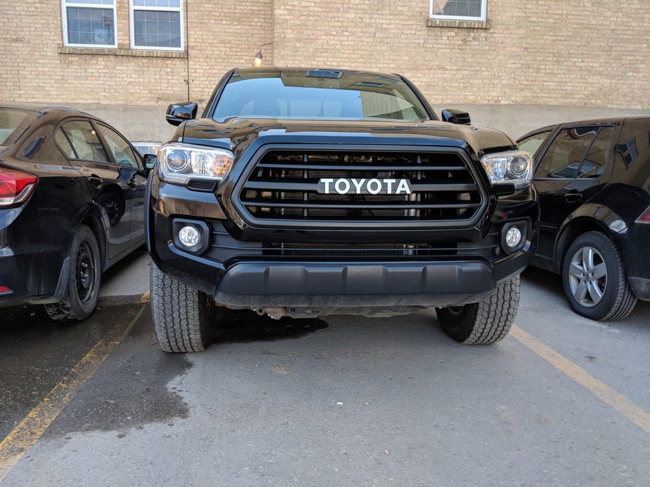

    Another satisfied customer!

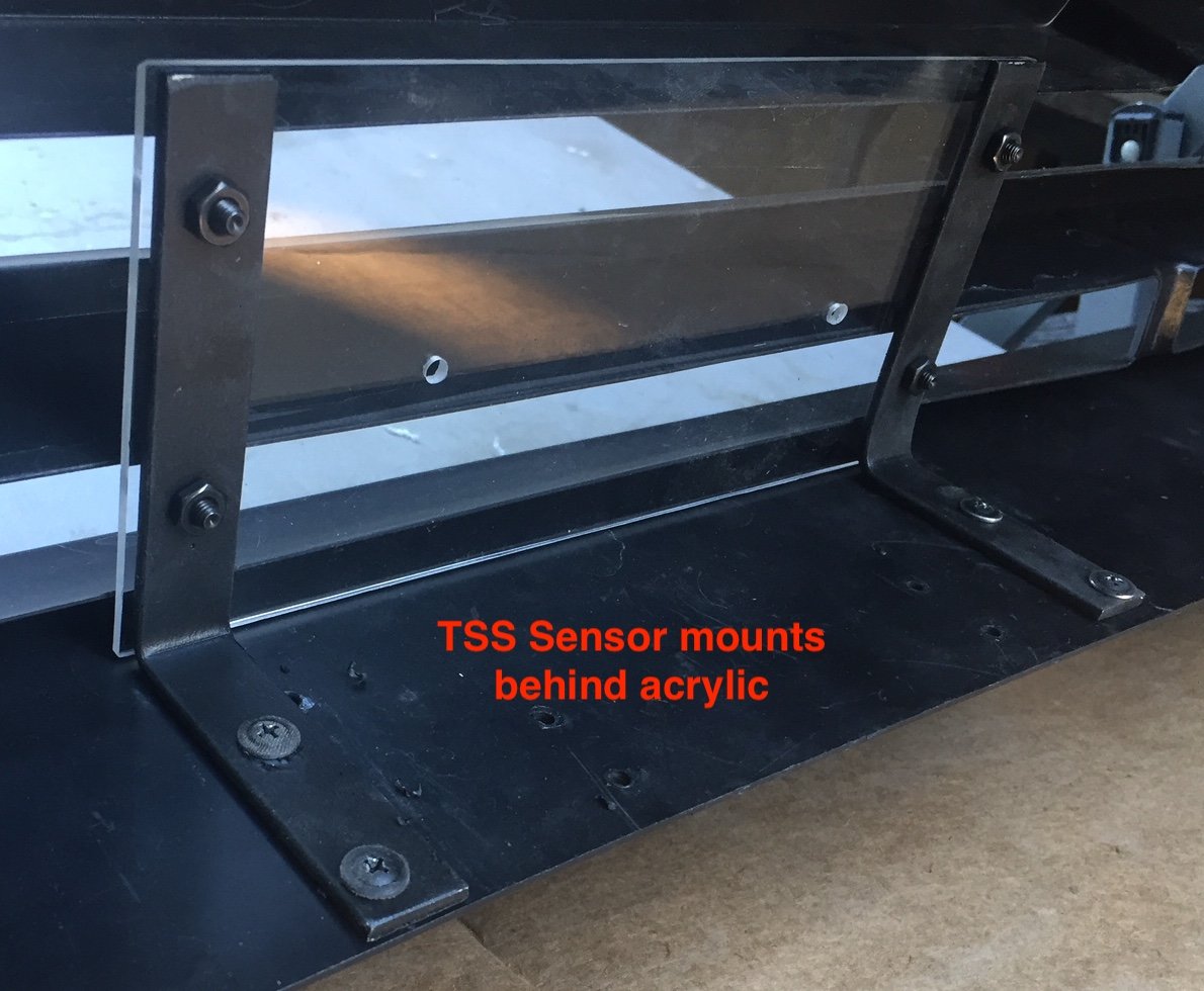

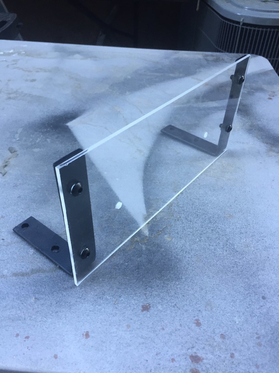

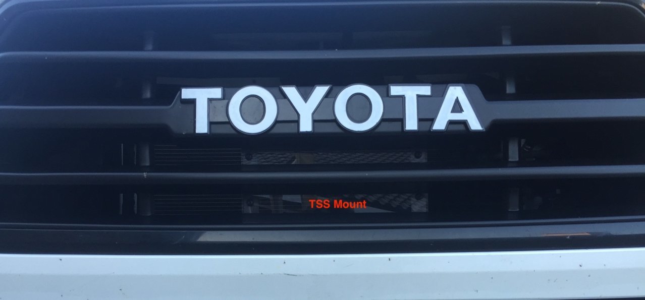

    My truck is throwing TSS errors after I installed this grille and bracket. After careful inspection I think there are three issues:
    1. The radar sensor is mounted really close to the lexan and water will collect between the two. Radar can't see through water so this is an issue when my truck sits after a rain.
    2. The radar sensor in the stock grille is angled vertically straight up-and-down as measured on the back edge. In the new bracket it is angled forward a few degrees.
    3. The valence that the bracket screws to is a very flimsy piece of aero plastic and it makes the sensor flop around quite a bit. This leads me to believe that #2 is done on purpose so when you are driving at speed, the wind pushes back on the sensor and brings it in line vertically.
    The grille itself looks great but it is pretty cheap ABS. It flexes easy and it'll rattle because it fits kind of loose. After I installed mine I took it apart again and used some foam tape on some of the outside tabs which stopped the rattle.
    So my recommendation to everyone out there is not to buy this grille if you have an '18 and want radar to work. My recommendation to the supplier is to redesign the bracket so it spaces the sensor further from the lexan sheet so that water can drain. The bracket also needs to mount to a more secure location. There is plenty of metal structure behind the grille area for this bracket to mount to. There is no reason it should mount to a flimsy piece of aerodynamic plastic.

    The tss mount I currently have is basically a piece of plexi glass (for added protection) and custom water-jet cut and bent L tabs. It is my time you are paying for. If you're crafty and don't want to pay that price then save yourself the $$ and DIY. Or you can do what some others have done and just zip tie it to something behind the grille. Others that have mounted it this way don't seem to have any issues. Until I have the mount perfected I'm not going to invest in making 100 of them, so until you'll just have to pay for my time. Would love to hear if anyone has a better mounting bracket system idea though.
    Also yes the grille is made from .120 abs UV resistant plastic, it is a little flimsy but It's only a cosmetic piece not sliders. But it will hold up, the plastic is automotive grade and is used by many many many other applications and has been tested by time.
    Something else to consider is that if the plastic were any thicker the sensor's radar would have a hard time passing through it.
