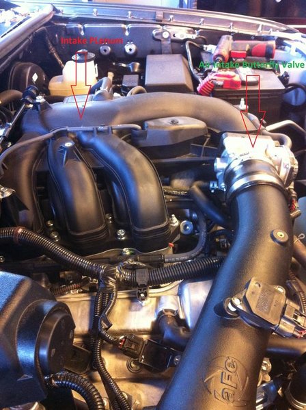

    One last thing. The IMS is designed to fit the intake manifold and intake runners/plenum. It is compatible with other performance mods, though fitment with aftermarket CAI is up to the buyer to make work. It was brought to my attention this weekend that when installing an AFE CAI that the intake tube is off slightly when trying to attach it to the air intake butterfly valve connection. This is of course due to the intake plenum etc. raising up the 1/2 inch from the spacer. Basically the whole black plastic thing all the way to the intake butterfly valve. See pic ( I know there's a better name, just couldn't think of it right off the top of my head) Raises up. Not a huge deal, as most of us are used to "modding" things. A longer rubber sleeve from AutoZone or even washers or spacers under the aftermarket airbox can raise things to make them line up again. (*note, in this pic, there is no IMS installed)

    obviously.
    Running stock intake here, i have no reason for a CAI... intake temps at cruising speed are about 1-2* above ambient with the stock intake.

    Throttlebody is the term you are looking for.
