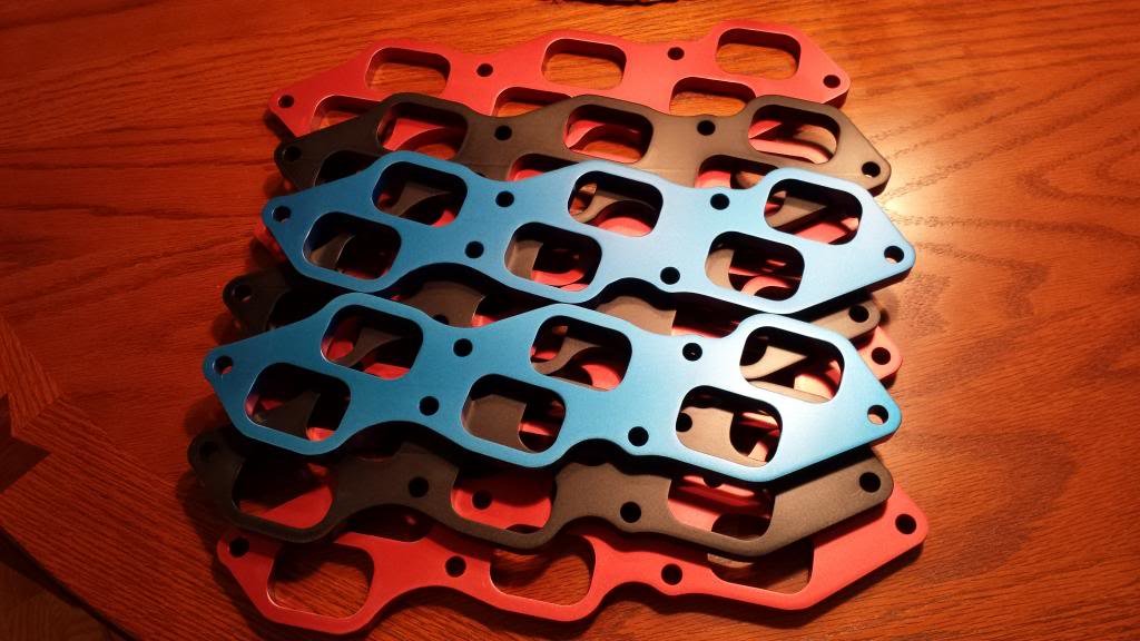

    have more ready when you are! 20130624_174830_zps1b4c9705_1f6b4d0b2ba91c2c68268d128dfbffdf808c41bf.jpg

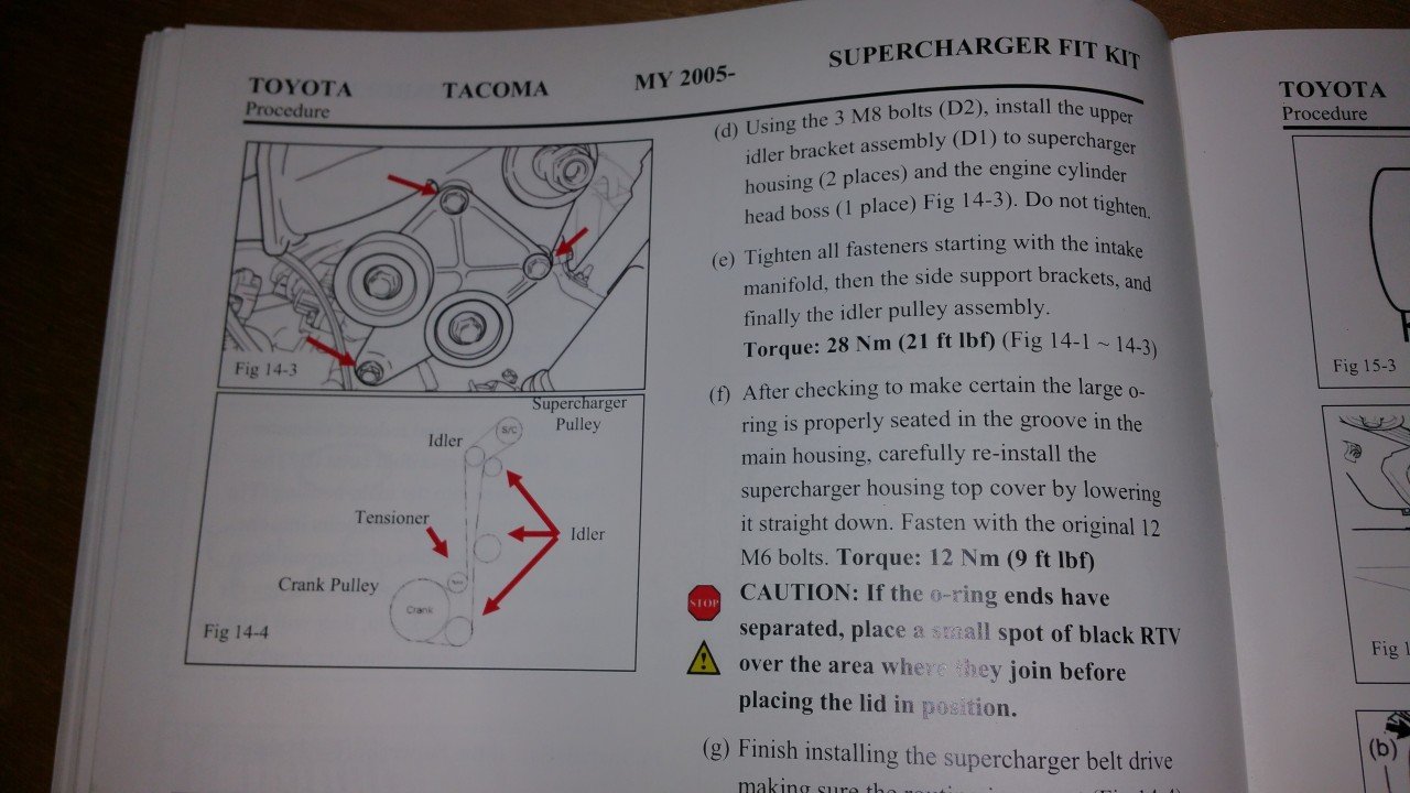

    skimmed through..
    any info on these with a blower?

    It would require a new idler bracket, longer belt and longer bolts to mount the SC through the spacer to the intake manifold. See the pictures below of the SC installation instructions about the bracket and bolts. These would need modification / replacement in addition to elongating the holes in the intake brackets. Not to mention, the clearance under the hood is tight with the SC and intercooler lines.

    you are absolutely correct. should have looked through mine.. :facepalm:
    thanks man.

    no wonder why those super charger belts dont last long, they run some weird ass tight bends on that thing!
