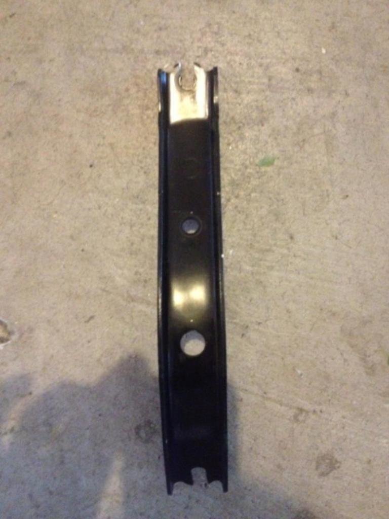

    * BTW the bracket doesn't need to be lengthened. Only notched out at the end.

    These are the bracket(s) image-22_zpsd1486ef9_380555bb3f8a319e7b88def333f1a63c8f95c000.jpg

    If I'm looking at that right, it appears that you slotted it top and bottom. Would that be all you need to do in order to make it fit?

    The bottom already is slotted all you had to do was make a slot in the top hole

    Oh wow. I don't see what the huge problem is then. People are making mountains out of mole hills over it. Lol.

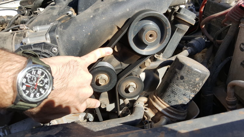

    Maybe make sure you are referring to the correct brackets before claiming its just a "mole hill"..
    This is the correct bracket..
    That distance needs to be lengthened. A new bracket with those two bolts, and another on the top right, would need to be made. It bolts to the motor, and supercharger snout.. So spanning across the intake manifold.

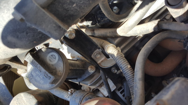

    This is the other bracket you guys are referring to.. Which I agree.. Isnt a big deal..
    Like I said, I've looked into this...

    I stand corrected. Mountain then. Well that sucks for us.
