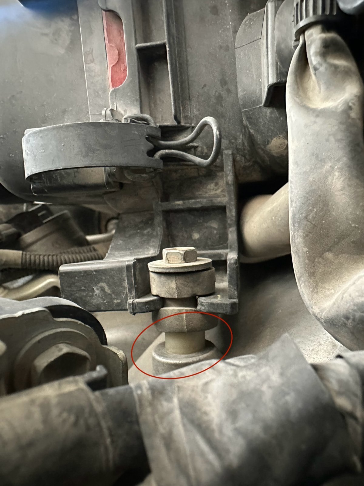

    just installed mine
    Can’t find instructions. Sent XTP an email.
    wouldn’t think it’s needed for something this basic though I’m curious to see their take on it.
    feels like more low end power.
    that being said this is not a complaint. Maybe not even a concern. More of a question.
    How do folks feel about the intake mounting bolts
    because it appears with the spacer, the factory bracket bolts don’t line up to work any more.
    Instead of 3 bolts holding down the lower and upper intake on the top and side (or more) you end up with a lot less.
    I’ll double check everything but as far as I’m aware due to the heightened position, for example instead of 3 bolts, my upper intake is secured with only 1 bolt now.
    edit: watching this to see what this guy did:
    -slotting bottom of manifold support brackets to make them fit
    -home made plastic spacer to allow for re-use of bolt at passenger side front corner of manifold
    ^video says IM spacer is 1/2" thick, so I'm guessing a home made plastic spacer for intake (above) could be chosen of also that size, 1/2"
    Maybe I’ll stack washers until it looks good there or take a measurement
    Then get a spacer of that size

    That’s my vid :thumbsup:I used a small spacer, maybe 1/4” because the oem bolt is short. If you get a longer bolt you can use a taller spacer and make it really level.

    Just got their instructions
    I see the part now about notch the bracket stays to fit
    will probably get a longer bolt from Home Depot and see if they have spacers of any kind
    hopefully the gap is easy to measure and not the intake wobbling giving a false reading
    If so, local hardware store sells small DOM metal tubing that if it fits the bolt, can be cut to length to be a spacer

    DOM? :rofl:
    Bro, if that’s not overkill idk what is. I just turned a rubber bumper down to size and used a longer SS bolt.
    I made my own brackets for the surge tank because my spacer is 18mm.
    Also have the retarded cam gears & OTT tune. I installed everything 4 years ago. The improvement was immediate, there’s no relearn for these mods.

    I just hope using DOM isn’t a problem because it’s straight metal.
    Should be $8 max. Maybe $5 or less.
    I’d have no issue using a plastic type of spacer from Home Depot but that’s if they even have it.
    The hardware section is generally jumbled or empty
    used the same thing on my IEDLS ford ranger poly carrier bearing to space it out; those DOM sleeves. Seems to work.
    Just wish I painted or powder coated them and the u shaped holder that came with it (bare metal) as now they’ve rusted and look ugly.
    Might just mark location, take it off, sand, spray rust converter paintable surface, black, and slap it back on.

    do you know what the spacer dimensions are and/or IM spacer?
    I think the IM spacer is 1/2” but not sure
    thought I heard 1” somewhere but after looking at the gap at my front bolt
    No way the gap is 1”
    1/2” or less
    anyway
    Saw plastic washers at Lowe’s but no spacers.
    then got the idea and tried something out
    See the rubber bushing?
    if you pull it out and slide it underneath
    -it becomes a spacer
    -squished
    -moveable to thread bolt in
    -sleeve still clears under the manifold
    so that might be another (free) way to do it
    Leaving just grind the passenger side brackets = total bolt fit cost $free.99 no trip to store
    For the “bushing” longer bolt will probably find one in my bolts bin

    I cut mine out of 3/8" delrin I had laying around. Used a hole saw the size I wanted. Cut plug out, heated outside of it with heat gun spinning on drill to make it nice and smooth glossy black.
