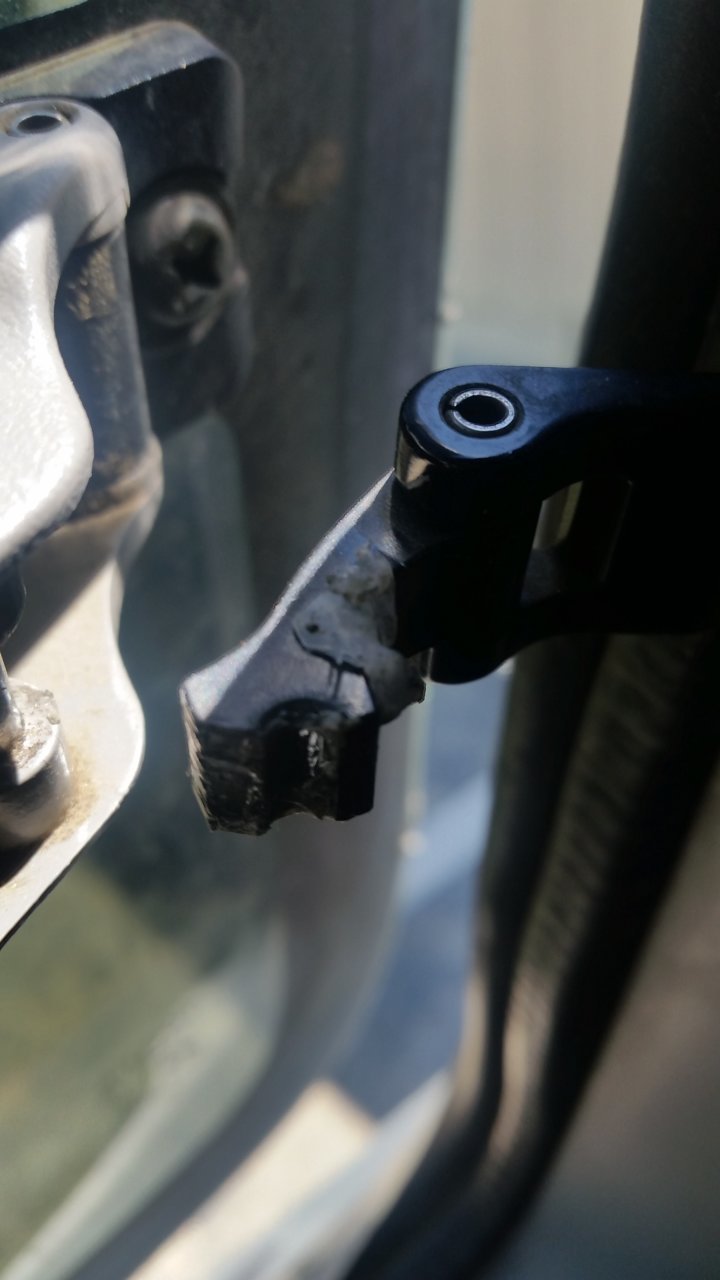

    The 1st pic is what is should look like, 2nd pic is it broken. Is that the same thing as these (being sold) that you guys are fixing yours with? It makes sense since they seem so damn easy to break, I'm sure everyone is breaking them and needing to replace them. But I just don't see that prong shape thing (that I broke) in the pics on these being sold. Is that because my truck is 1st generation & all you guys have newer ones that take a different part?

    The part connected to truck
