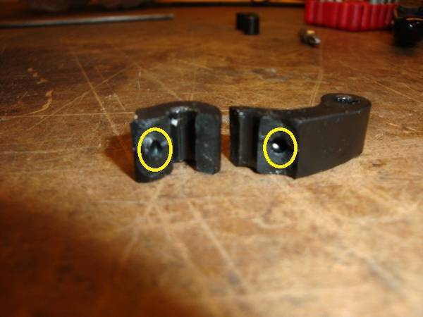

    Installed mine, too. Look great, work great. I painted mine black. Hint: put a shop towel on top of the vise/bench/whatever when driving out the pin so you don't mar the latch handle.
    I think I figured out why they fail: there was a huge air bubble in the plastic molding right in the middle of the failure point. There is only half as much plastic there as it looks form the outside! I got pics, and I'll post them when I have time.

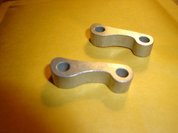

    Here's a bump for JJ for a great product, snug fit, and great service. And eveyone likes pictures...
    As-delivered billet replacements.

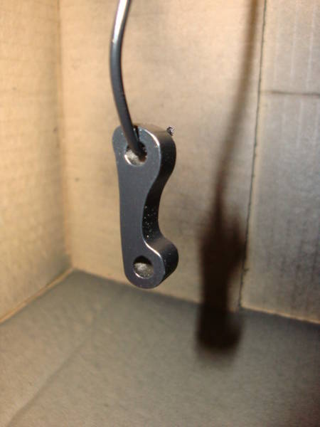

    Painted mine.

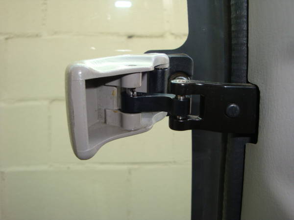

    Installed.

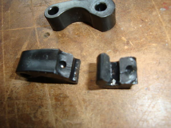

    OEM plastic, only one was broken...so far.
    And looky here: air bubble in the molding at the main failure point. Maybe this is why they all fail. Manufacturing defect.
