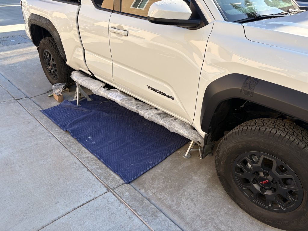

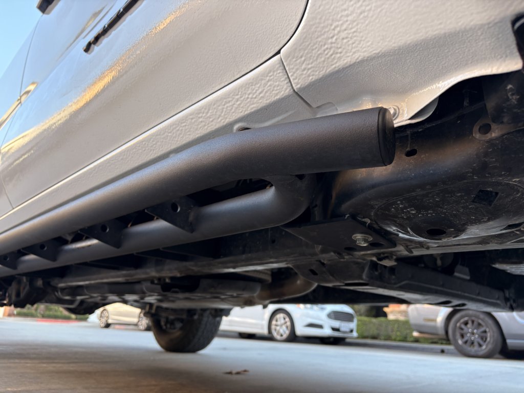

    Buy some used 2024 rock sliders remove one bracket at the back of both them on. Enjoy life way better than any aftermarket product. I can contest that it held the full weight of the vehicle as I was stuck on one rock and the rock slider did not yield.

    That's awesome! I can't believe you found this solution, very impressed. I purchased running boards that were listed for the double cab thinking I could find a way to make it work but the mounting points on the boards did not match the points on the truck at all and I had to return them. I did wonder about sliders though because the mounting points on the frame did seem more likely to be the same for both xtra and double cabs but the boards were cheap and easy to return (Amazon) and the sliders were expensive and the manufacturers had tough return policies and high shipping costs so I threw in the towel on that. I did end up finally finding just one running board aftermarket option (toyota itself doesn't even offer any) so those are the ones I have now haha.
    When you say remove the last bracket, how exactly did you do that? Did you just not use that last bracket or did you have to physically remove it somehow? Removing it seems like it would take some serious work (the whole thing is one strongly welded piece of steel isn't it?).

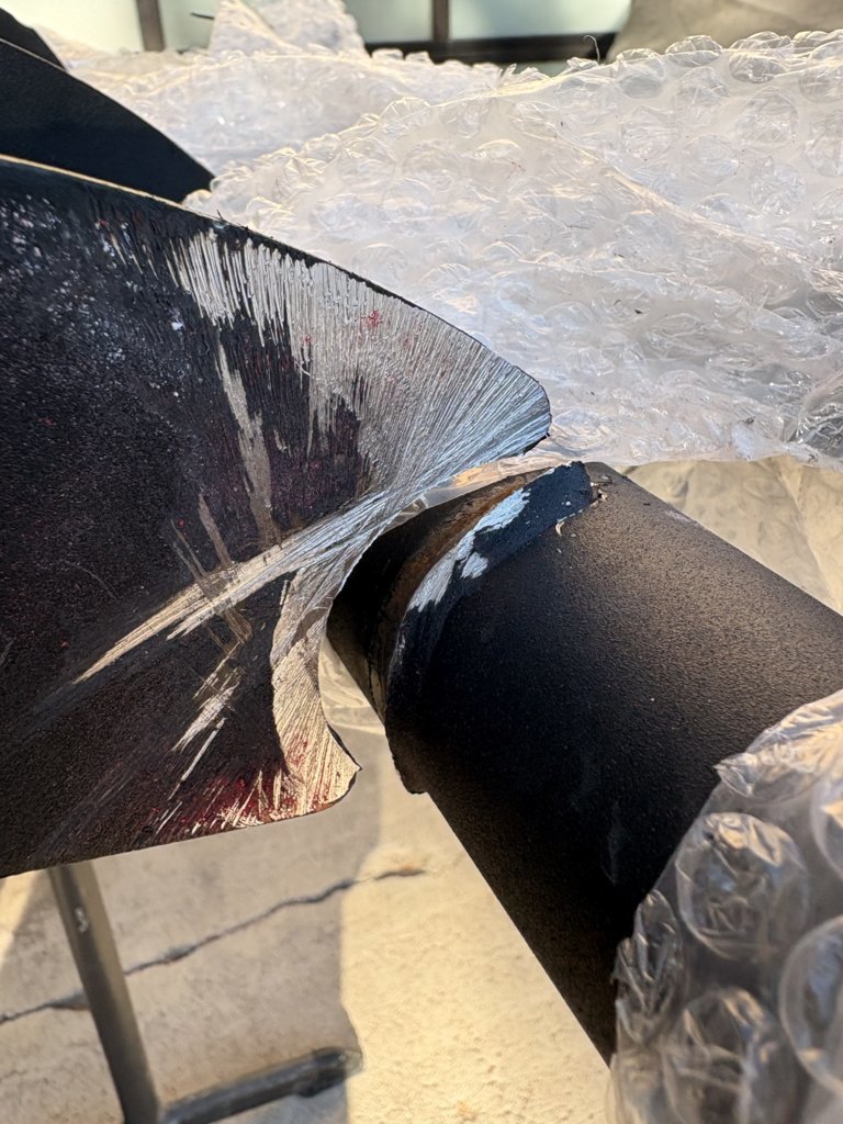

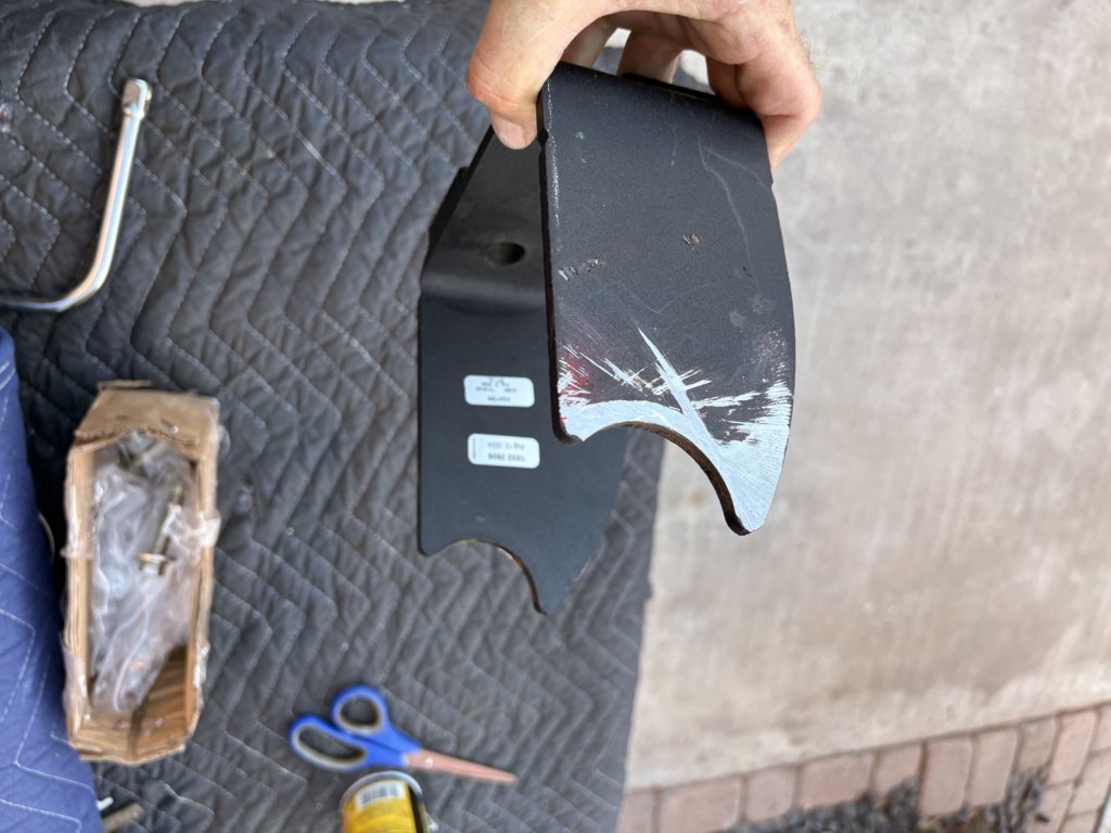

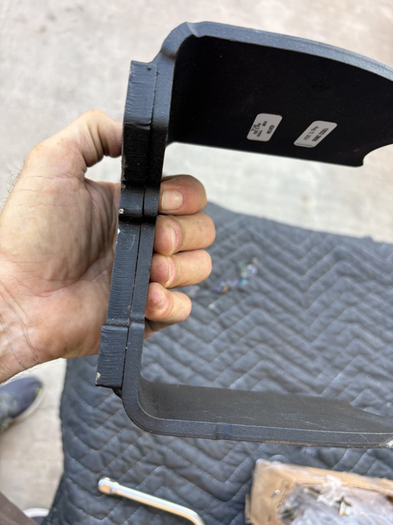

    I’ve used my Milwaukee sawall and cut the weld next to the bracket remarkably enough the bracket came off cleanly. This was a pretty easy step and then they bolted into place have no doubt the factory rock sliders are better than any aftermarket product. Just take a look at the factory bracket, I think it’s 5/16 and even thicker where the bolts go through the back plate.
    You could leave the factory bracket on the rock slider in place, but you’d have to modify the truck, which is doable. I just didn’t take the time to do it that way because I was going out on the trail to thrash..!
