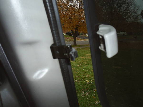

    Ok so I have a 2003 Tacoma extracab and the windows in the back will not stay clamped when i open them. Heres some pictures to better explain what i'm saying.
    I want to know if i can fix this, need to buy a part or it is just how the back windows are.

    actually, i think they are supposed to stay together, and the clamp acts kinda like a hinge when you open the windows, that way, they will stay open, but they will be hinged together.

    Its supposed to work like a closed hinge (not coming apart) mine did the same I had to replace it with a new one. Its made out of diecast something. Took me about 20 minutes to replace it. I think the part was like $15-24 bucks.

    After buying my truck the same thing happened not more than a week of owning it. The drivers side window hinge broke off. I took it to the dealership the same day and they fixed it in like ten minutes. I thought I just opened it up too hard but now I wonder if its just a cheap piece on a window that doesnt get used often enough for people to be busting em like that.

    Yup, its a cheap part..........looks like diecast metal. Feels like plastic.

    yea its definitely not supposed to do that. And i recommend replacing it asap because if you open it like that you're probably hyper-extending the hinge.

    I've been driving around with it like that since i got my tacoma and its fine when i keep it closed. I just cant open the window and keep that part connected.

    what a koinky dink this was brought up. the other day i thought i should open my extracab windows. open the driver side one and the hindge snaps. i superglued it and left it in the open position. I open up the passenger side window and the thing snaps too. Obviously the superglue didnt hold up on the driverside window cause when i closed it it snapped off.
    I call up Precision Toyota service dept and they admit its just a crappy piece but I have to go thru parts department to get pricing. Supposedly the whole hindge has to be replaced. Each runs about 30.29 What a bunch of shit. 60 dollars to replace em. All because a little black plastic piece snapped off.
