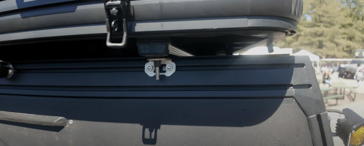

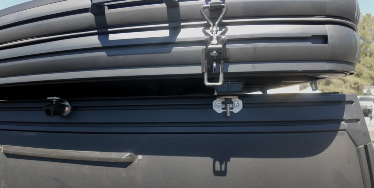

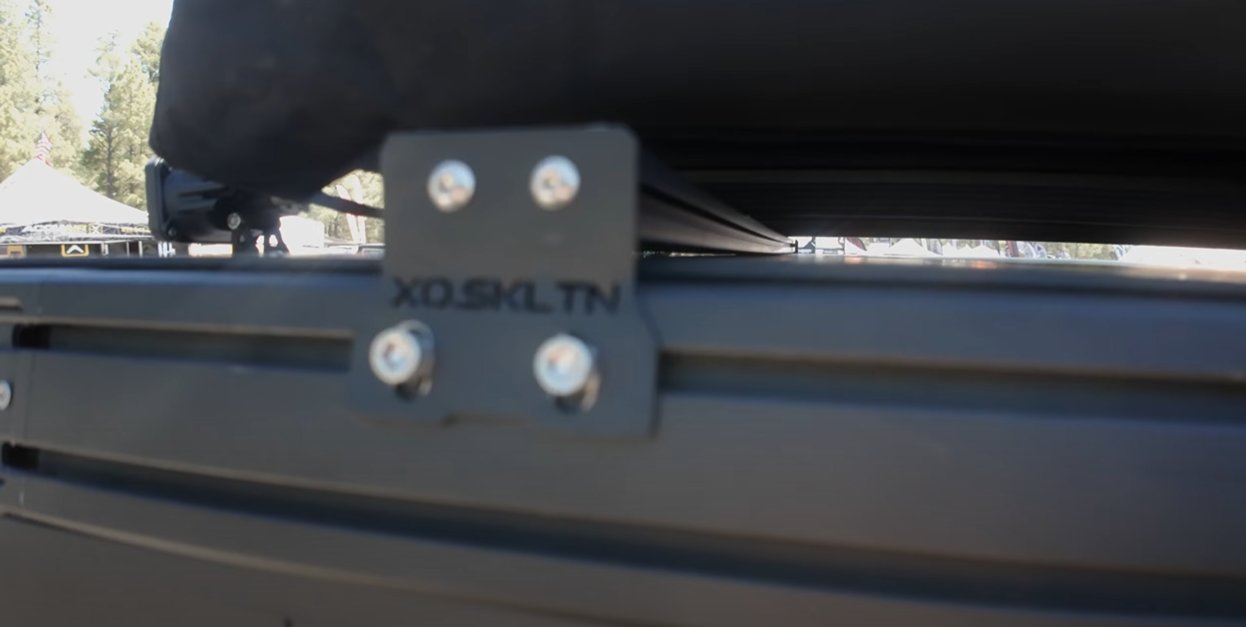

    Yep, I watched this video and screenshot the setup

    Looks good. I'm curious how strong those flush mounts are when clamped at either end of the topper like that with just one bolt on each rail, though. Since it looks like there's horizontal T-slot on the topper roof itself, it would be nice if there was a way to do some sort of lateral support at those locations.

    I am pretty confident on the rigidity of this flush mount method since I have had their rack over my Tundra's softopper before, mounted many things this way and never had any problem, although none of them were over 130lbs in weight. The vertical weight should not be any problem since the entire top of the topper mode has basically 4 horizontal bars sharing the load, evenly since its just sitting on top of them. For lateral holding strength, I think it maybe a good and simple idea to just add more plate/bolts to either side of the flush mount brackets on the rear/forward facing side of the bars so they are doubled up in terms of preventing sliding sideways.

    Totally agree about those mounts looking great if they double up on the hardware. How far do they stick out front to back from the extrusion on your setup? My main concern is the tent being too close to the cab and OEM 3rd brake light at the 15" height, since theres no way to standoff the tent a set distance like with a typical bedrack (I think I have mine set about 1.5" back at the closest point on my 14" Yakima rack). Less so for normal use than hard wheeling with bed flex, of course.

    I'm just hoping they offer a longer crossbar so that I can mount my 270 awning with this flush mount bracket.. I have had my FTT secured to my current rack with only 4 bolts no issues so far. but with the addition of the 270 awning I may want to see a larger 4020axtrusion... or add a second set of wider rails on my RTT to spread the load,, see how that raised mount/crossbar extrusion flexes and touches the top? that will wear through any coating quickly... luckily the system is modular so you could easily remove it, and get it recoated without having to rebuild the entire rack...
