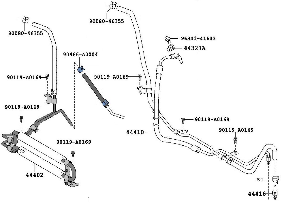

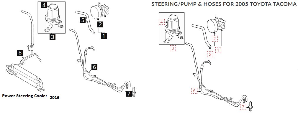

    Do I read this right that the 2016 Tacoma has a PS cooler that can be bolted onto 2nd gens?

    Why is that? Looks like just the return line is different?
    I need new R&P rack, lines, resi and pump anyway... Trying to make whatever replacement last with 33's and lots of off-road use

    For just the piece labeled #8 in the OP above? A wrecker would have it much cheaper...
