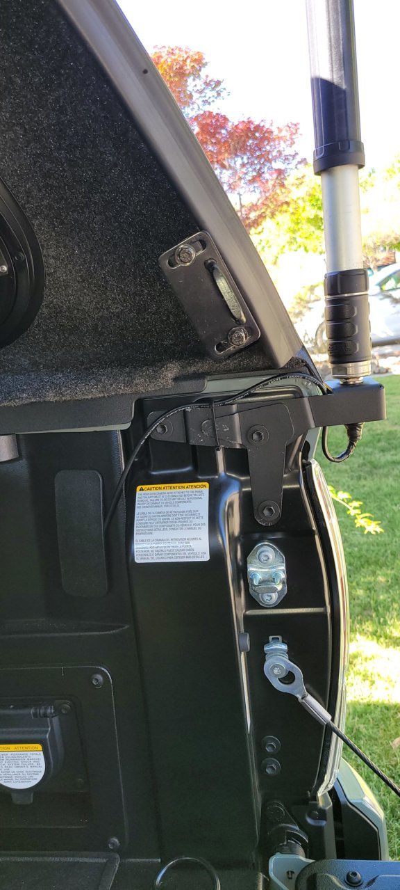

    So how much of the fuel pump noise did you get rid on 20m? I don't have any noise on UHF just on HF.

    I would say about "half". Without bonding, a 20m signal at +20 or better would be completely wiped out with the engine on. I can hear a +20 signal and about a 2 after bonding. Still completely unusable. Everything north of 20m is fine with engine on, driving down the road, etc.

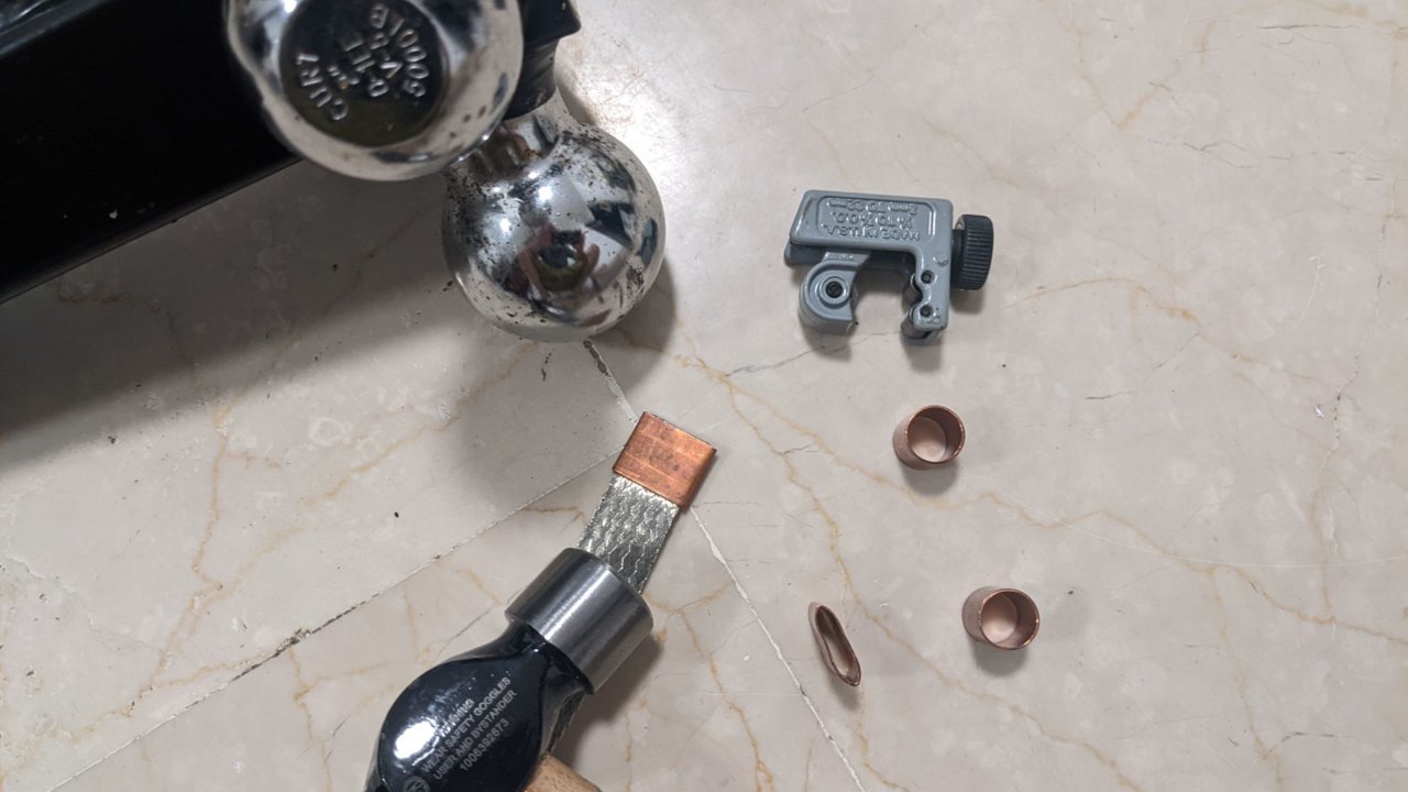

    Whoa you totally one-upped with the copper bolt washer idea. Those are amazing, how can I do that?
  4. Jul 19, 2022 at 3:27 PM
    #24
    pmoore4321
    pmoore4321 Well-Known Member
    Jan 29, 2021
    #354414
    66
    San Juan, Puerto Rico
    2021 Tacoma OR
    1/2" water pipe for the braid ends. It fits .75" braid perfectly. If you don't want to cut off you're own pipe, just buy the copper 1/2" couplers at Home Depot. Smash them onto the ends of the braid using your trailer ball as and anvil. Trim the excess flush with scissors. Drill a .25" hole and attach with stainless hardware.

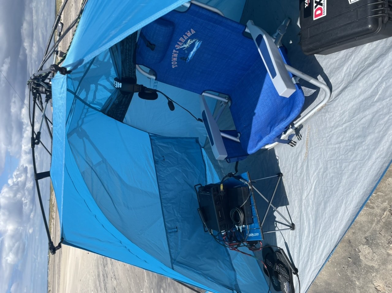

    I found this to be a bit more fun operating anyway. Did some OSV this week in VA
    absolute Zero noise floor

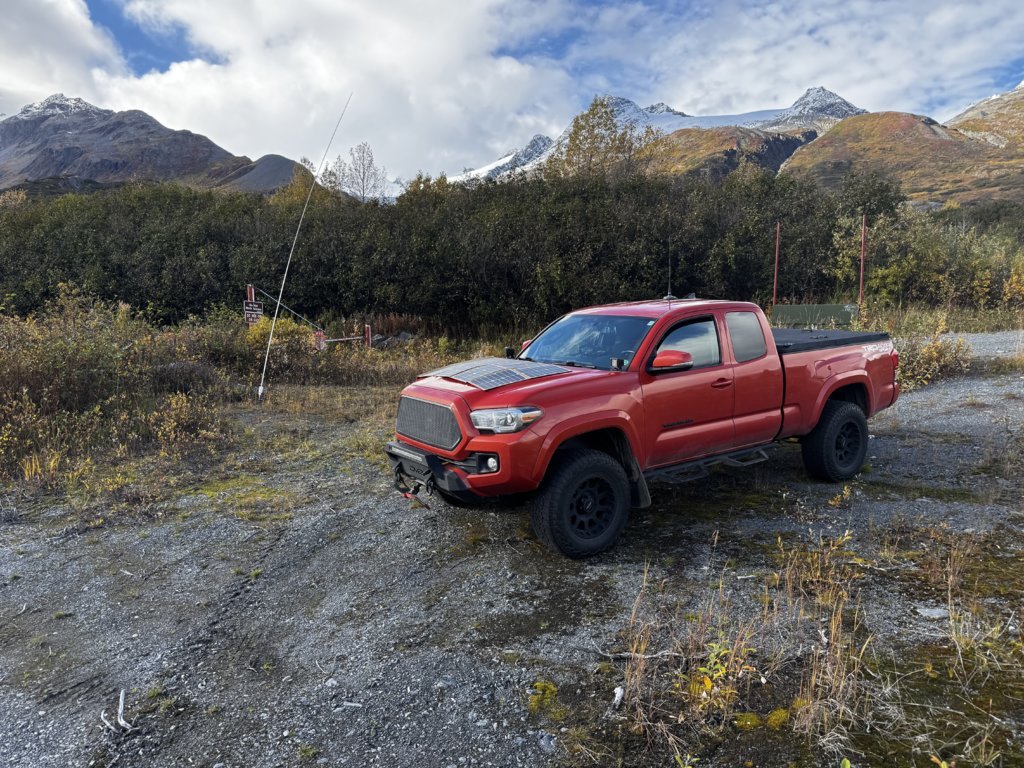

    2016 TRD Sports Access Cab
    How did this setup work for you? I need something for a quick POTA activation and I have a spare FT-891 not used right now.
    de KL5PF
  14. Jan 1, 2025 at 10:46 PM
    #34
    USAsvensk
    USAsvensk Member
    Sep 18, 2021
    #377407
    10
    Alaska
    Alaska POTA, zero Noise.
