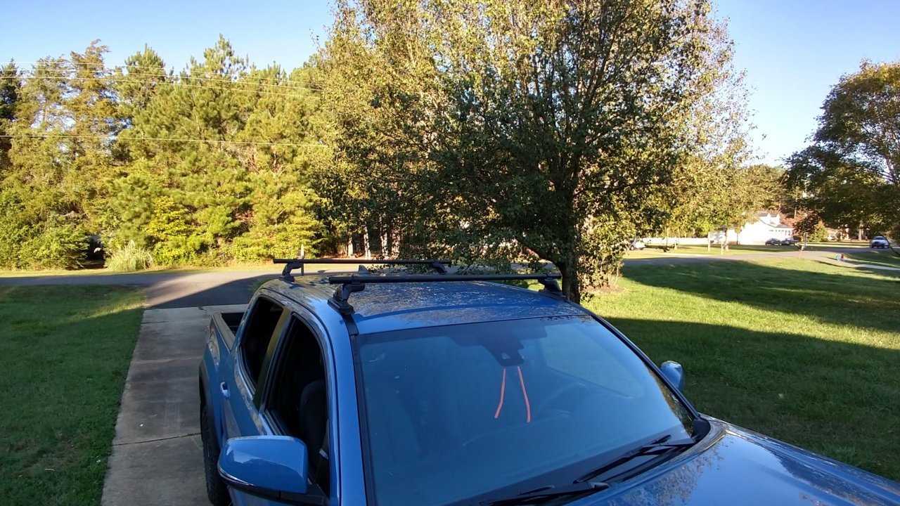

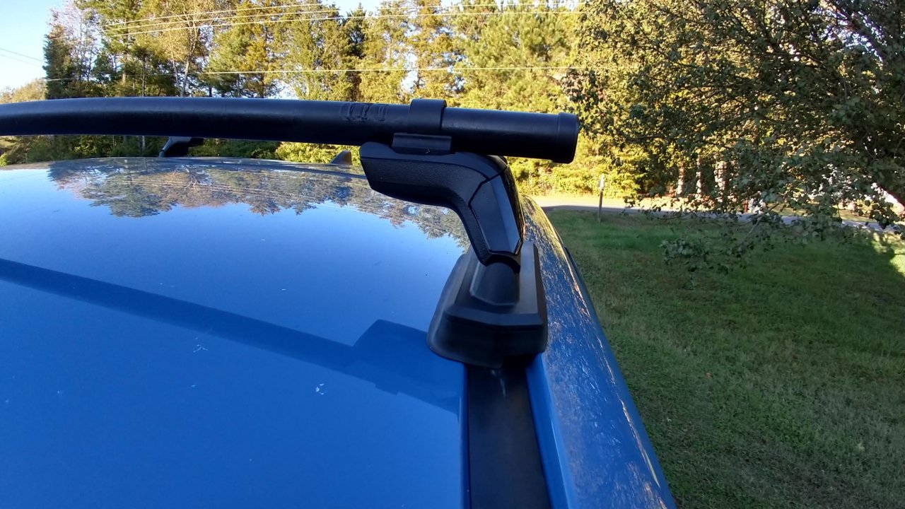

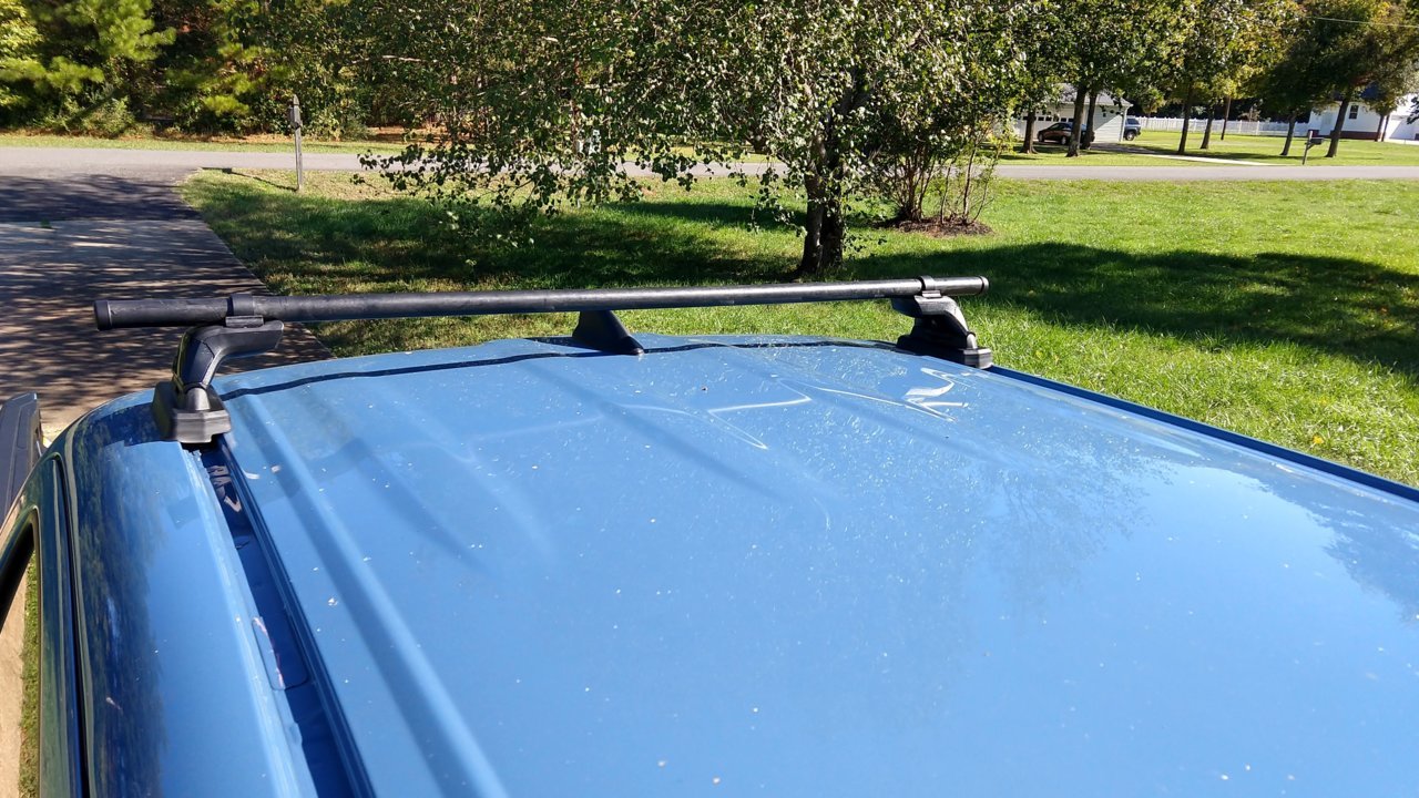

    UPDATE: Installed everything yesterday; everything went very smooth. The Landing Pad 22 fit VERY well, IMO. The landing pads did come with M6x28 and x35; I did have to get some longer M6x50 bolts to make it work. Crossbar spread is a bit more than my other cars; approx. 42". Not a bad thing, as long as all my bike trays, skybox, etc. will go that far, and I think they will just by eyeballing them. Drilling the weatherstripping wasn't a big deal; I just eyeballed where the threaded holes were and marked them. I did forget there is a piece of steel in the weatherstripping itself, and removing that from the section of weatherstripping (using some snips) ahead of time makes everything a lot easier. Silicone added around the holes I used. Note: the front bar does sit about 1" lower in height than the rear. Doesn't bother me, and I don't think it will cause any issues with attachments, but it may bug some folks with OCD. The only reason I can figure Yakima/Thule/etc. doesn't sell something like this is the fact that you have to modify the weatherstripping, and maybe they want a 100% plug and play install. Either way, this can be done, very easily, and it works really well. Cheerz.

    Did you get a chance to test your sky box and bike trays? I like this option but the spread seems to be at the max for a lot of the attachments.

    When the rack was installed, I never did get a chance to install bike trays on it. Per their manual, they should have been able to make that spread. My skybox would NOT spread that far, and doing a quick search with newer Skyboxes, I don't recall finding one that would fit. Kinda sucks, because I really hoped it would have accepted more accessories.
    Unfortunately, I ended up pulling the rack off the cab, using what components I could to make the rack for the camper shell I bought. I assume I just didn't use enough silicone to seal things up, but began getting water in the cab during rainstorms; mostly in the front passenger side. I didn't like the possible long-term effects of that; especially if there was another leak I didn't know about. So I pulled the rack, sealed up the holes for the rack, and installed new weatherstripping. I know that sounds like a chicken-shit thing to do, but I'd rather have peace of mind than an electrical problem down the road. There's plenty of other people running various brands of cab racks with no apparent leaking, so I guess it's just me.
