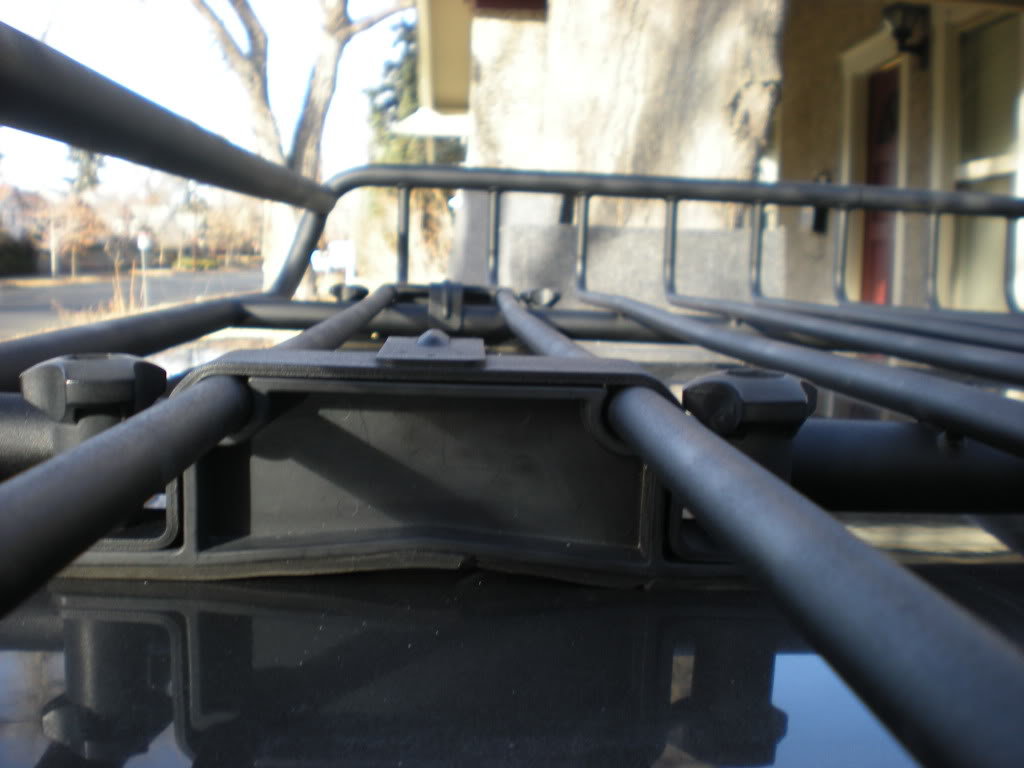

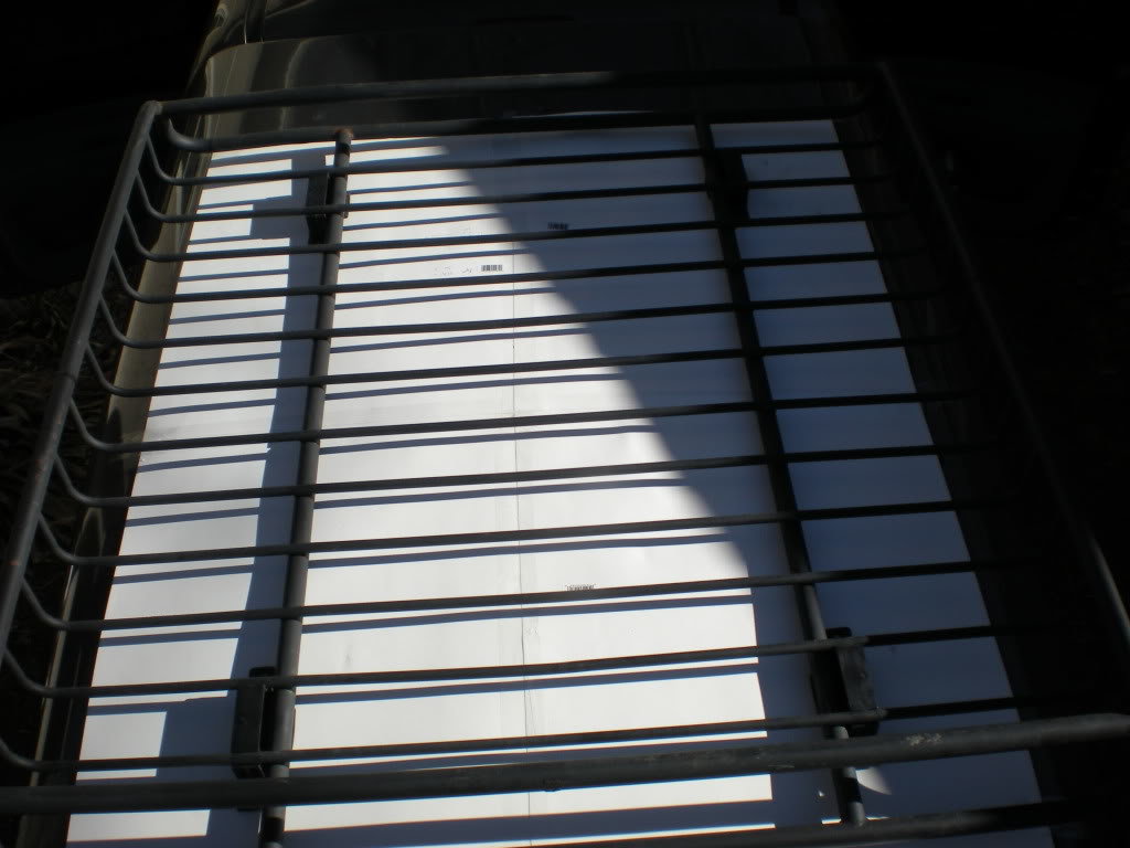

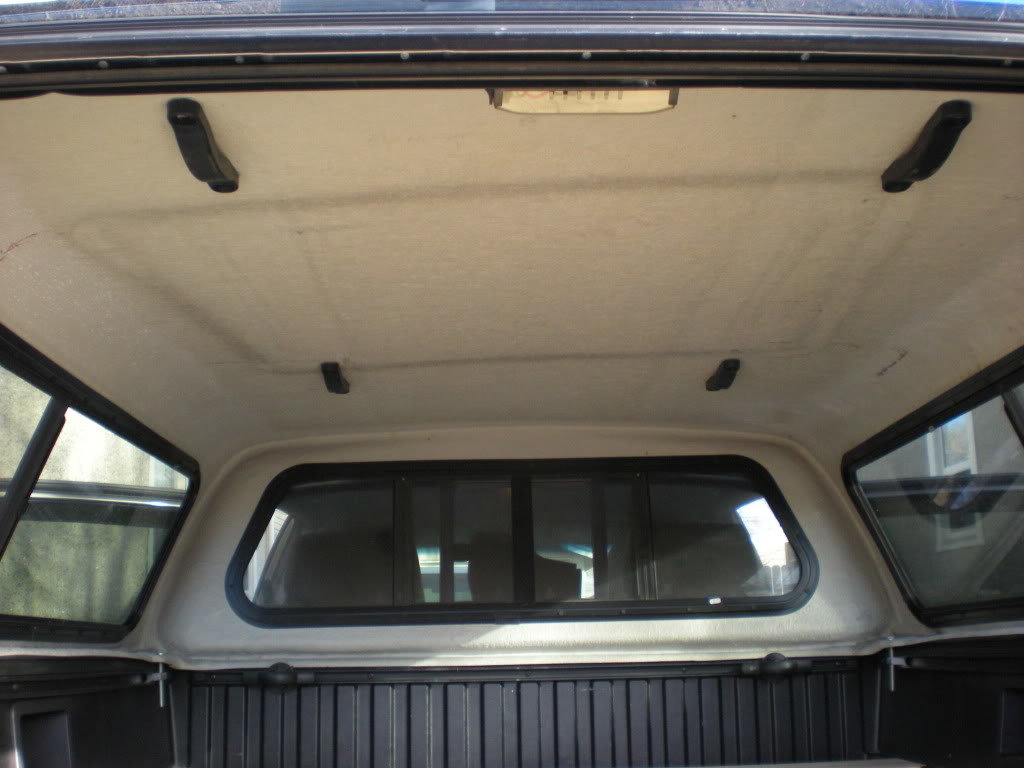

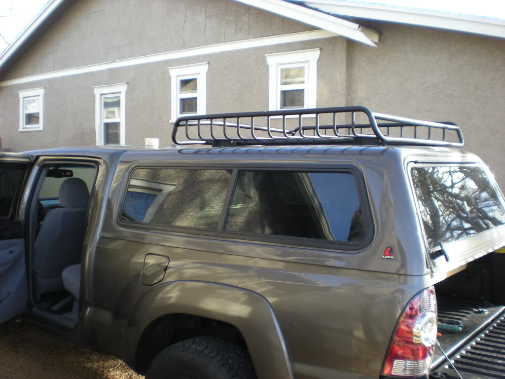

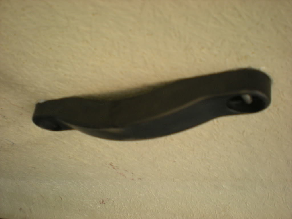

    Here was my project today. I couldnt see spending the money for a THule Tracker system or similar for my topper. So, I found this yakima basket on craigslist for cheap. I bought some stainless hardware from Home Depot, Rust Oleum Black texture paint, and clear silicone sealant for the holes. Anyways heres what I did.
    Made a template in the house for the holes on poster board. Made sure it was centered on the topper and taped it lightly so it wouldnt move.
    Drilled the holes and used the cross bar clamps to mount inside and out of the topper to spread the load and not crack the fiberglass.
    Final product, pretty happy with it. Now it wont sit as high as it would if it were on crossbars and I can strap down my kayak to it and any other gear. I kept the fairing off for now, gonna see if its needed. Maybe put some lights on it later.

    Interesting. I've had load warriors for almost 10 years and they perform really well. I would make sure you distribute the weight accordingly and NEVER exceed the weight limit (140lbs) of the Load warrior. The load bearing bars are meant to distribute the weight relieve some of the stress on the shell. Let us know how it works out for you.
    Also you may want to buy the locking brackings otherwise you can screw the load warrior off the truck in less 3 minutes without much effort . The locking brackets run 60.00 for 2.
    Nice job!

    I understand that the bars disperse the weight. However, what is the difference between putting it on bars that have four mounting spots on the cap, or the four mounting spots on the cap direct to the basket? I'll update on how it holds up, for now it'll just be camping gear until spring when I get the kayaks back out. Thanks for the replies.
