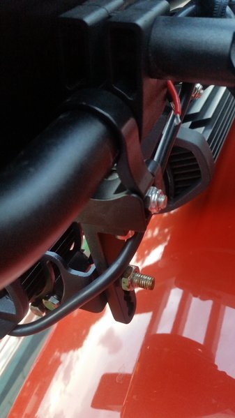

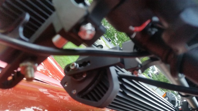

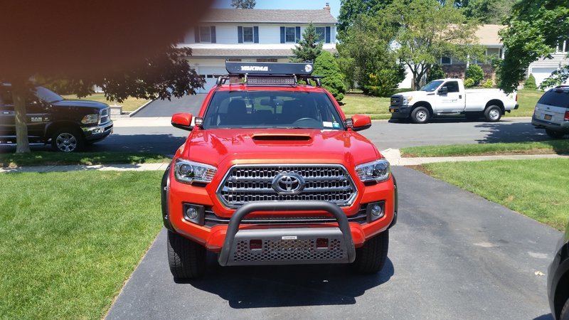

    Just a quick DIY that I'd figure I'd share with everyone. I know a lot of people, me included, are cautious about drilling holes into brand-new or warrantied trucks. So if you run a Yakima roof rack, (I use a LoadWarrior, but I'm sure a MegaWarrior would be fine) these 1'' Bull bar mounts fit damn-near perfect on the larger bars.
    https://www.amazon.com/gp/product/B0175W0NCA/ref=oh_aui_detailpage_o01_s01?ie=UTF8&psc=1
    I've used two pairs already for a 20'' Light bar and two pods for about two months now and noticed no movement down. However, I have noticed and increase in wind noise, but I think that's because I mounted mine lower towards the cab roof (the fairing gets in the way)

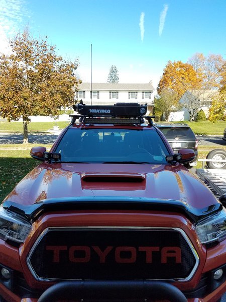

    @Hellvillain ...that maybe the solution I've been searching for!! Could you provide a picture where you're standing at the hood looking back over the windshield at the light bar/pods?

    Sure, ill grab you those pics tomorrow. And actually I switched from the 22" bar and two pods to a 32" bar, but I'm pretty much using the same set-up.
    Off the top of my head, I ran the wires under the drivers side front tower, and down the channel between the windshield and the frame, and then just spliced it into the wires running from my ditch mounts. The pressure from the tower keeps them secure and with the negative wire above the positive in the channel, it hides it. But you do see wires running from the light towards the tower.
    I had them sitting up there for a while unwired lol because i couldnt figure wiring out either, but once i convinced myself theres no way to fully hide the wires without drilling, I just went with it.

    oh here we go, i dug up this picture from a couple months back, (excuse the finger). not the best, ill get a way better one tomorrow. if your going to go lower bar of the rack, a 44" definitely wont fit, as I contemplated putting my 42" there. upper bar you may be good, i havent done any measurements cause of the fairing

    That helps a lot! Thank you!
