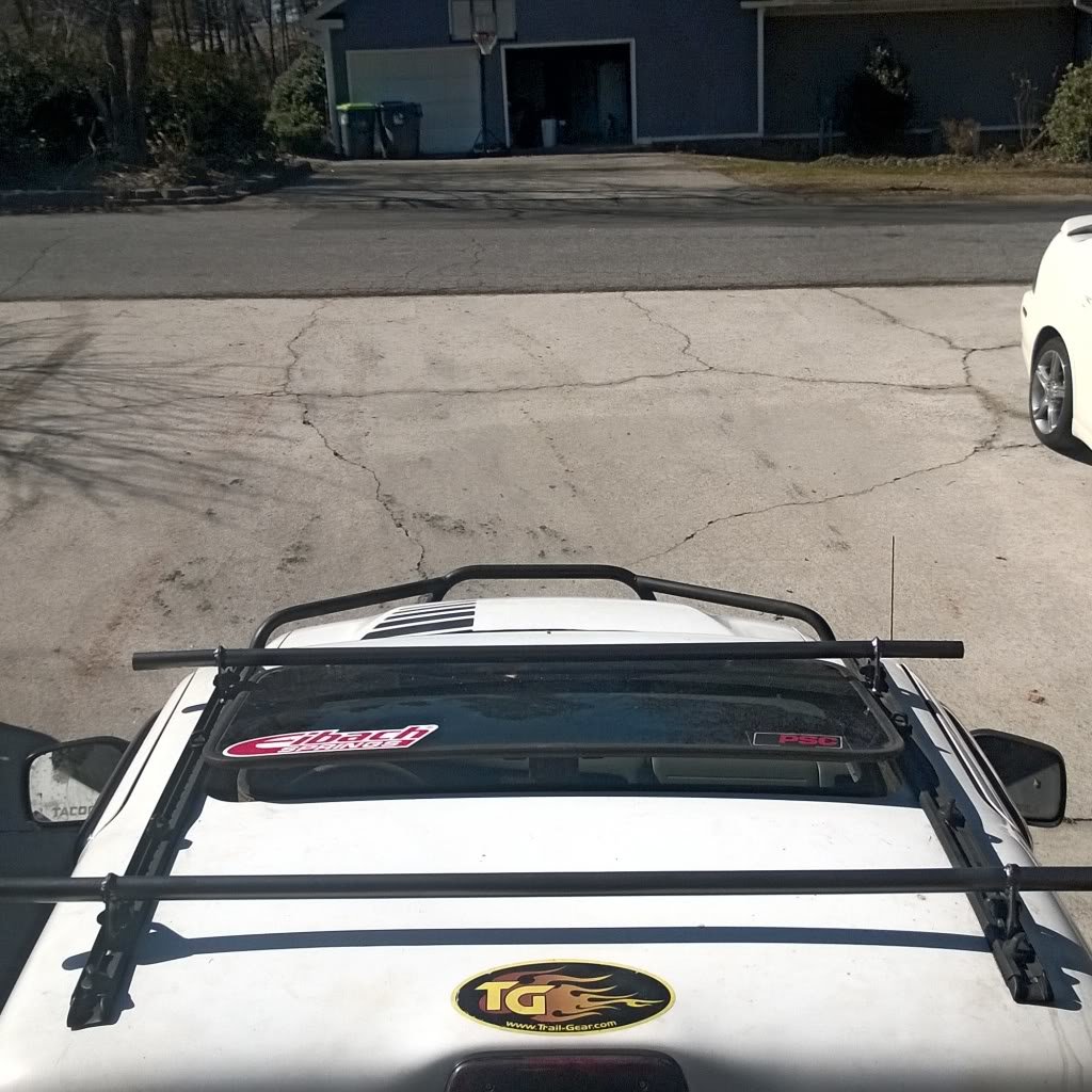

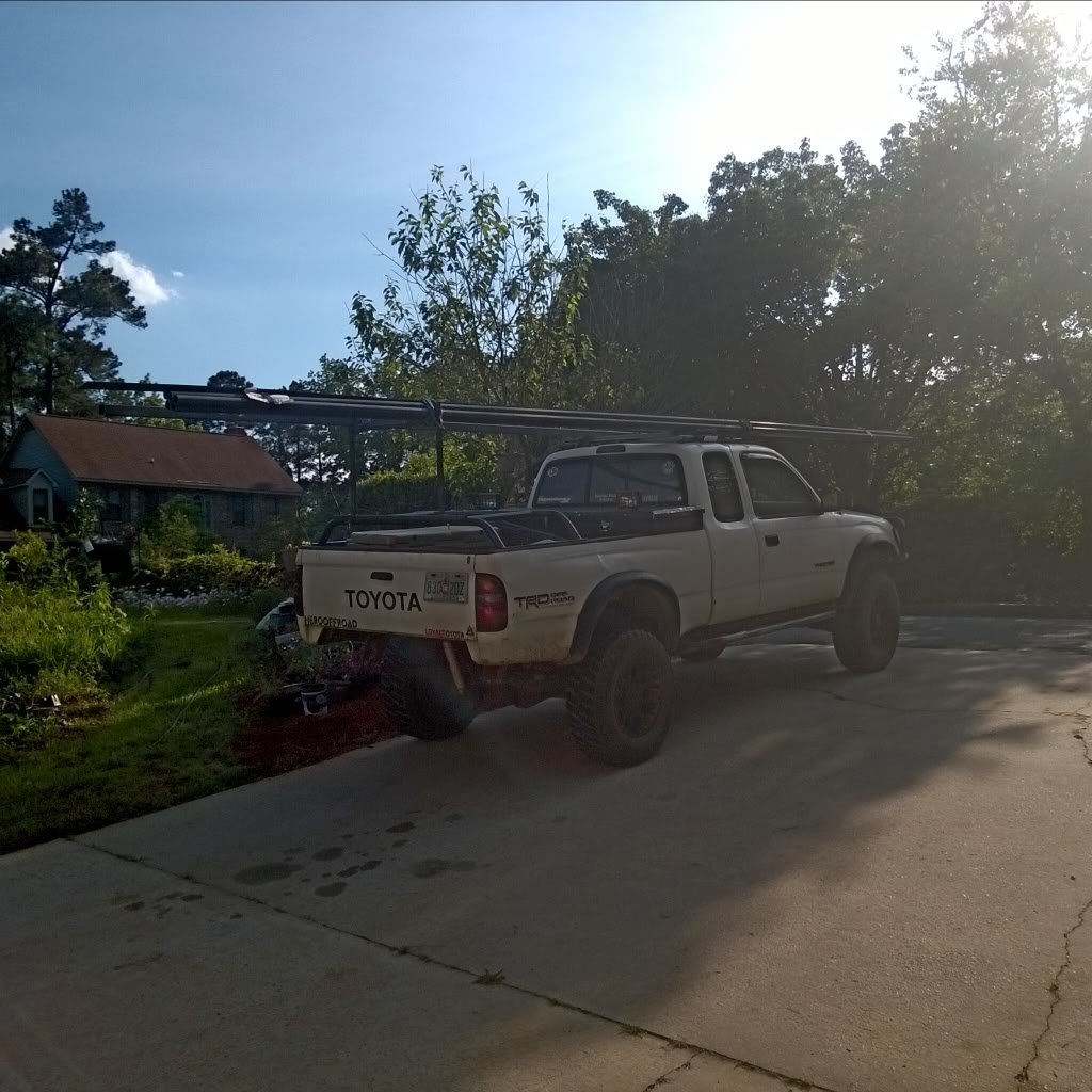

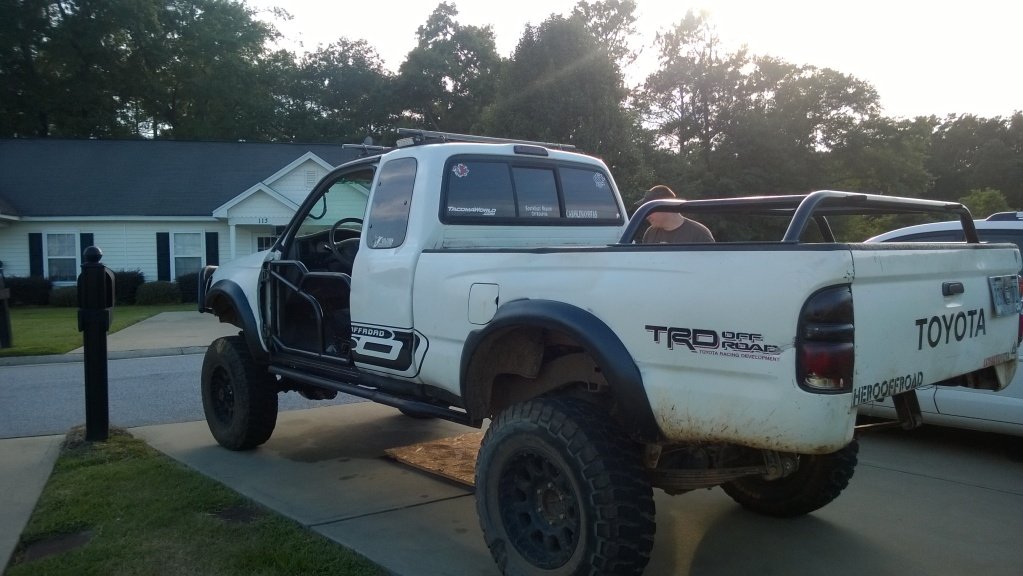

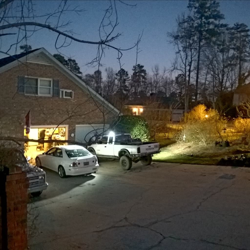

    Look at build!
    Thanks man!
    OP you can always sell it :D
    As Tim mentioned I used factory T4R tracks and crossbars on mine as well as a few other trucks and its sorta been picked up as of lately by some members and it only cost me around $25!
    I soon changed out the factory crossbars as they weren't wide enough to fit with my factory sunroof so I made some from 1" OD steel tubing that support over 350# per crossbar though id never put that much weight up there.
    Here are a few pics just in case you decide not to use the Yakima kind and mine looks very similar to Yakima if a wind deflector was added up front but I plan to sometime put a single row 40" led bar there
    And I also mounted side facing lights to the tracks
