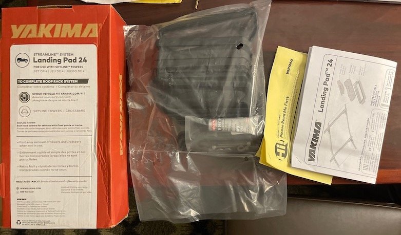

    Hi - It was Mountain Sports in Arlington Tx, But I think I just bought the last one they had there. I've Looked for hours today and cannot find proof that the AC's do not have mounting holes from the factory. If you can show me definitely that the 2021 tacoma AC's do NOT have factory mounting holes like the DC's - I'll sell you mine (+ a New York Style Cheese Cake and a doberman puppy...)
  19. Feb 17, 2021 at 3:44 PM
    #19
    o30mike
    o30mike New Member
    Feb 17, 2021
    #356456
    3
    2021 Tacoma Off Road Access Cab
    Yakima Overhaul Racks
    New in Box...

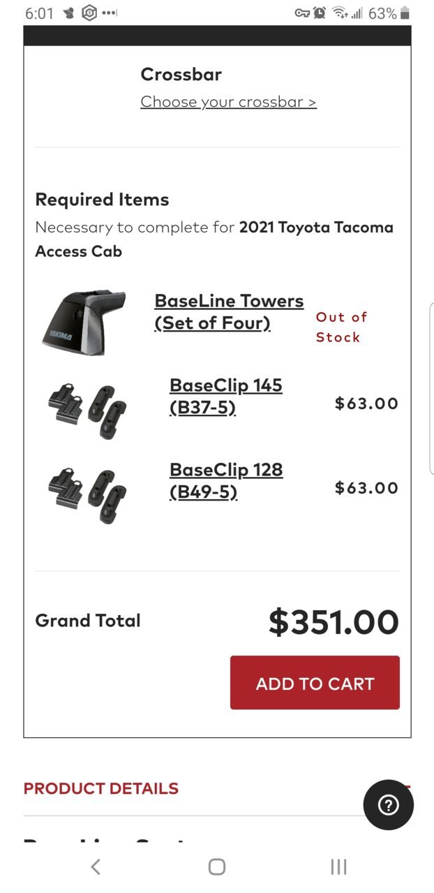

    So from everything I've researched and known about all 3rd gen AC's is that they don't come with the pre drilled holes. On Yakima's vehicle configuration tool and installation notes, they list only the BaseLine System as the only compatible roof rack system and not the Landing Pads. I was reading a forum post from Victory 4x4 earlier saying that their rack works on AC's but you have to drill also.
    "BaseLine System – Yakima" https://yakima.com/products/baselin...56.1694217511.1613606085-779941899.1613606085
    I've attached a screenshot of what Yakima says works with a 2021 Tacoma AC. I'll keep doing some digging but just wanted to pass that information from now.
