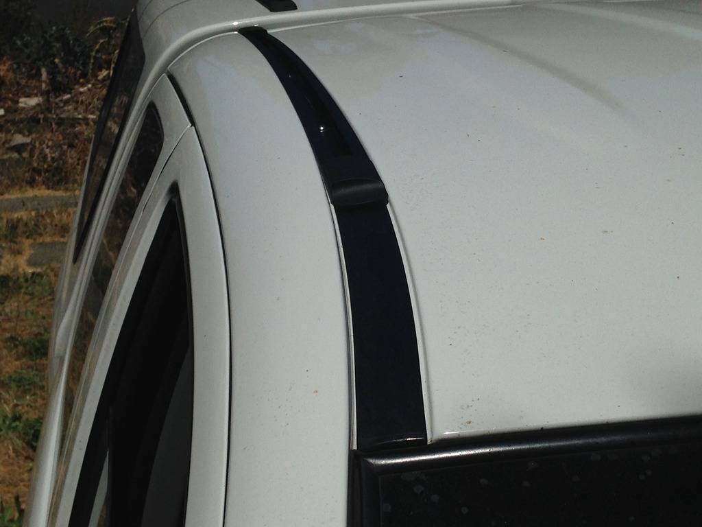

    Ditch Tracks go in the oem roof slot correct? So clip / door interface not involved, right?
    I am talking clip to door frame install.

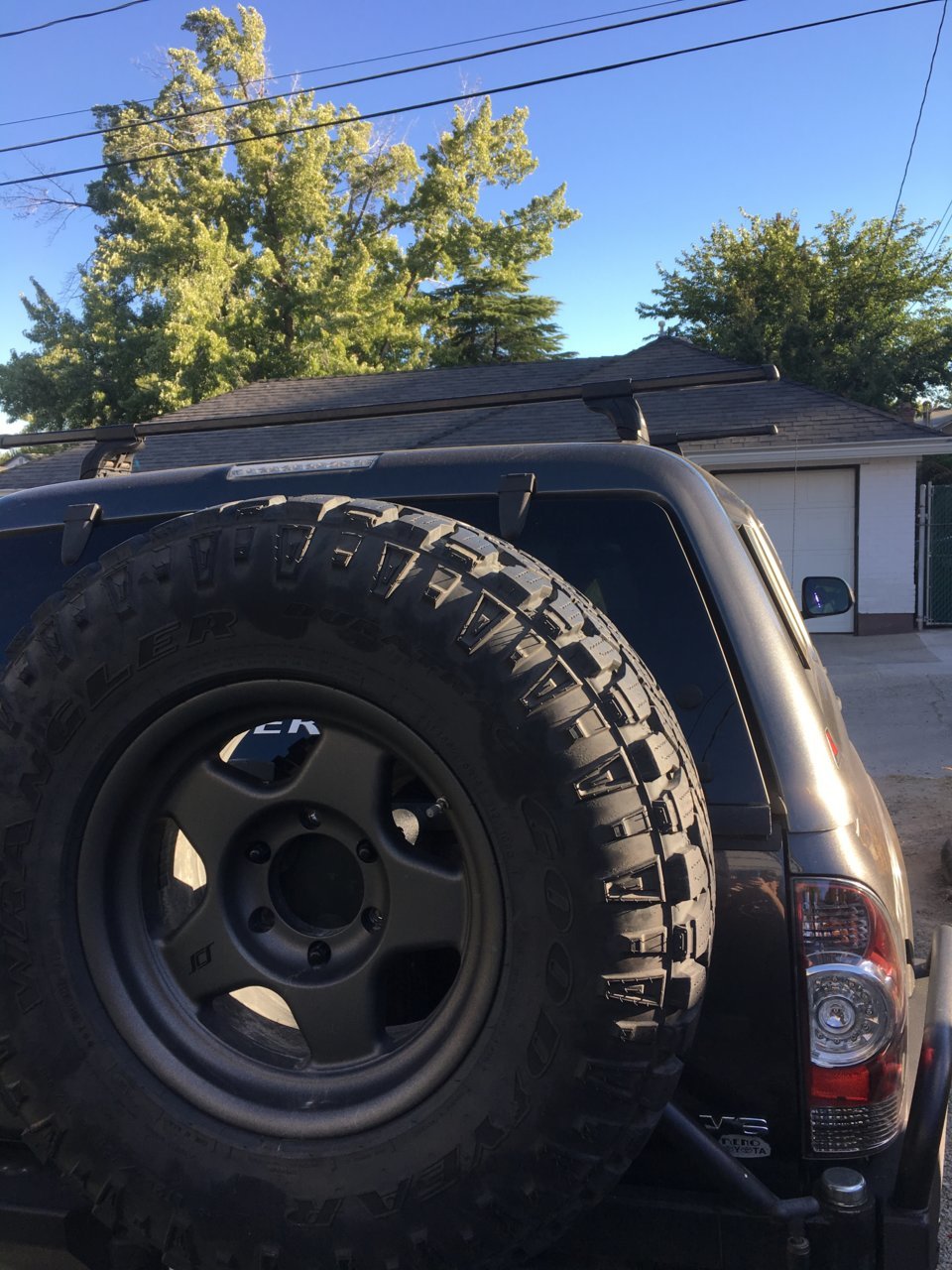

    Correct, no clips, just the towers held into the tracks with t-nuts. Unlike the oem racks though, drilling is involved no matter which cab style you have, even the double cabs for which they are designed. Just about any rack style can be added or removed pretty easily including baskets or prinsu types. Being in construction I seem to be less intimidated than most by the thought of drilling and adequately waterproofing my roof but I still have a healthy respect for the risk involved. I just fell for the look (or stealth of it really) and decided it was just right for me.

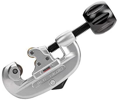

    I would use a pipe cutter if I was you.
