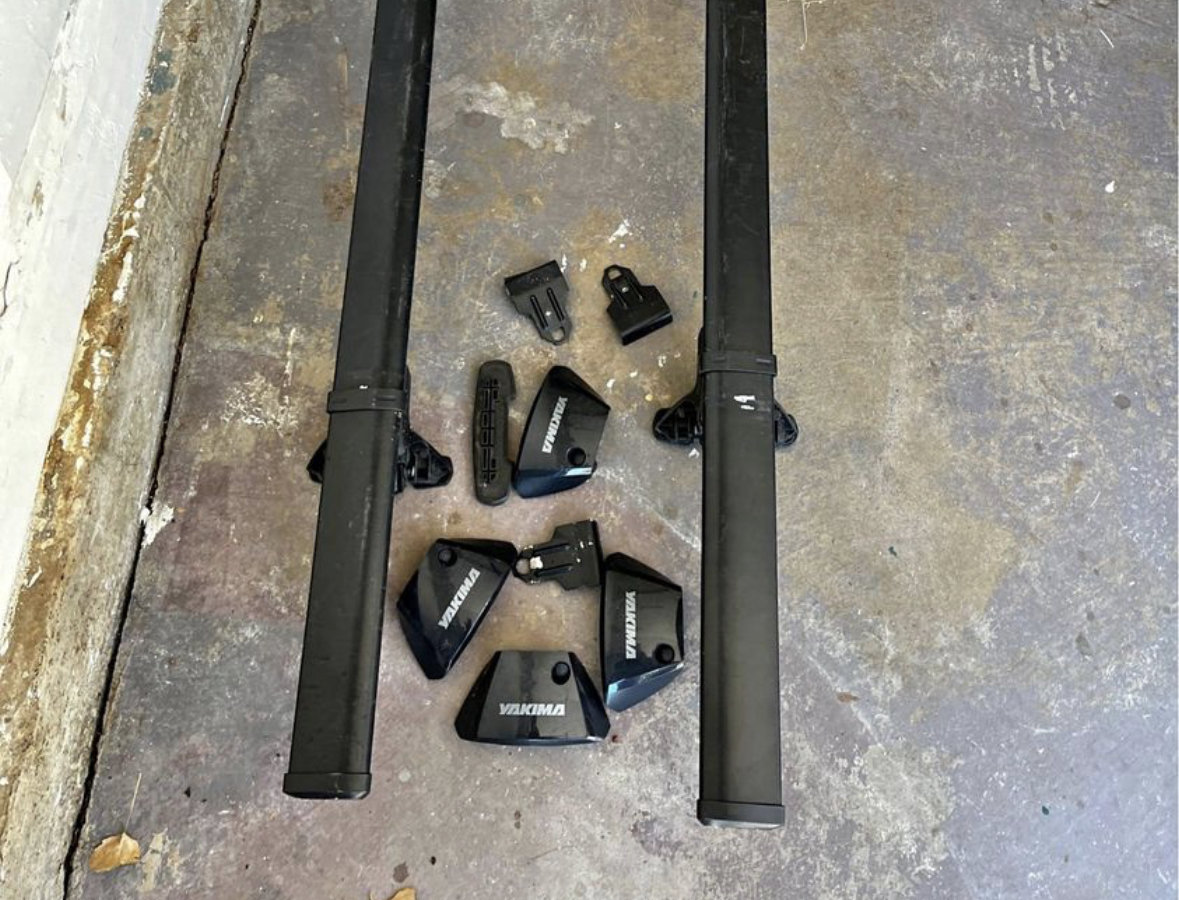

    Will these fit? Little experience with racks on shells.

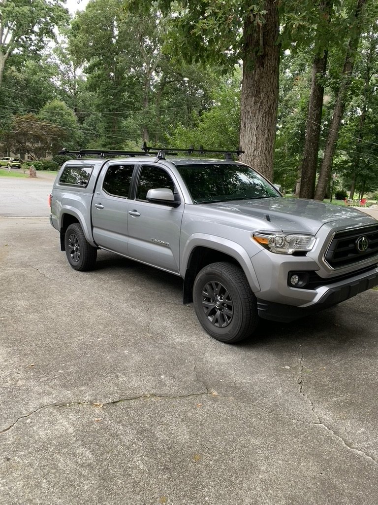

    ARE Shell with Yakima Racks
    These racks will require changes for mounting on ARE roof tracks. The towers that are attached to the Core bars need to be changed to Yakima Baseline with the correct landing pad. Basically, the crossbars are the only parts that can be re-used. Go to the Yakima fit page for details on which landing pad fits the ARE shell track. I have Yakima HD bars mounted on an ARE shell with Baseline towers and landing pads.

    Thank you! Seems no way to avoid spending a few more bennies to get a rack. Great info - Tyler
