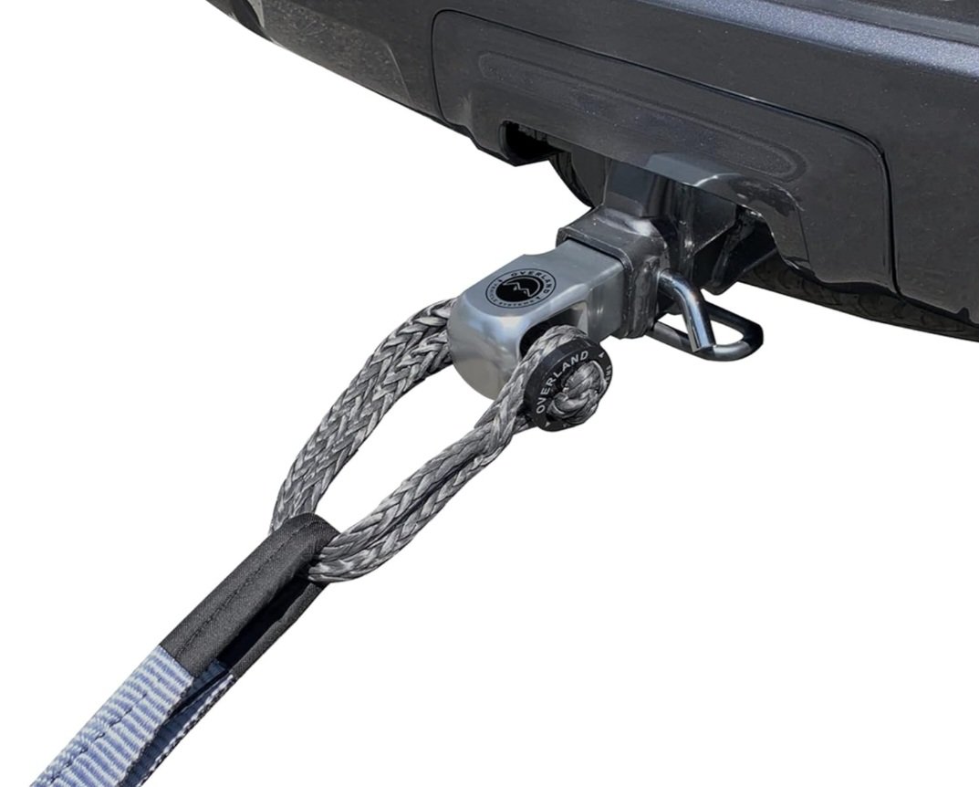

    I think you have it pretty well sorted. The only other recovery item I recommend is a soft shackle hitch recovery point. I have this one and it's a solid bit of kit. It's also ALOT cheaper than the Maxtrax equivalent.
    Aluminum Receiver Mount for Soft Shackle https://www.amazon.com/dp/B08KY7YJPD
    https://maxtraxus.com/products/maxt...KumqVLNS2LzRclgCLWOErm6R0LVLW6awaApGwEALw_wcB

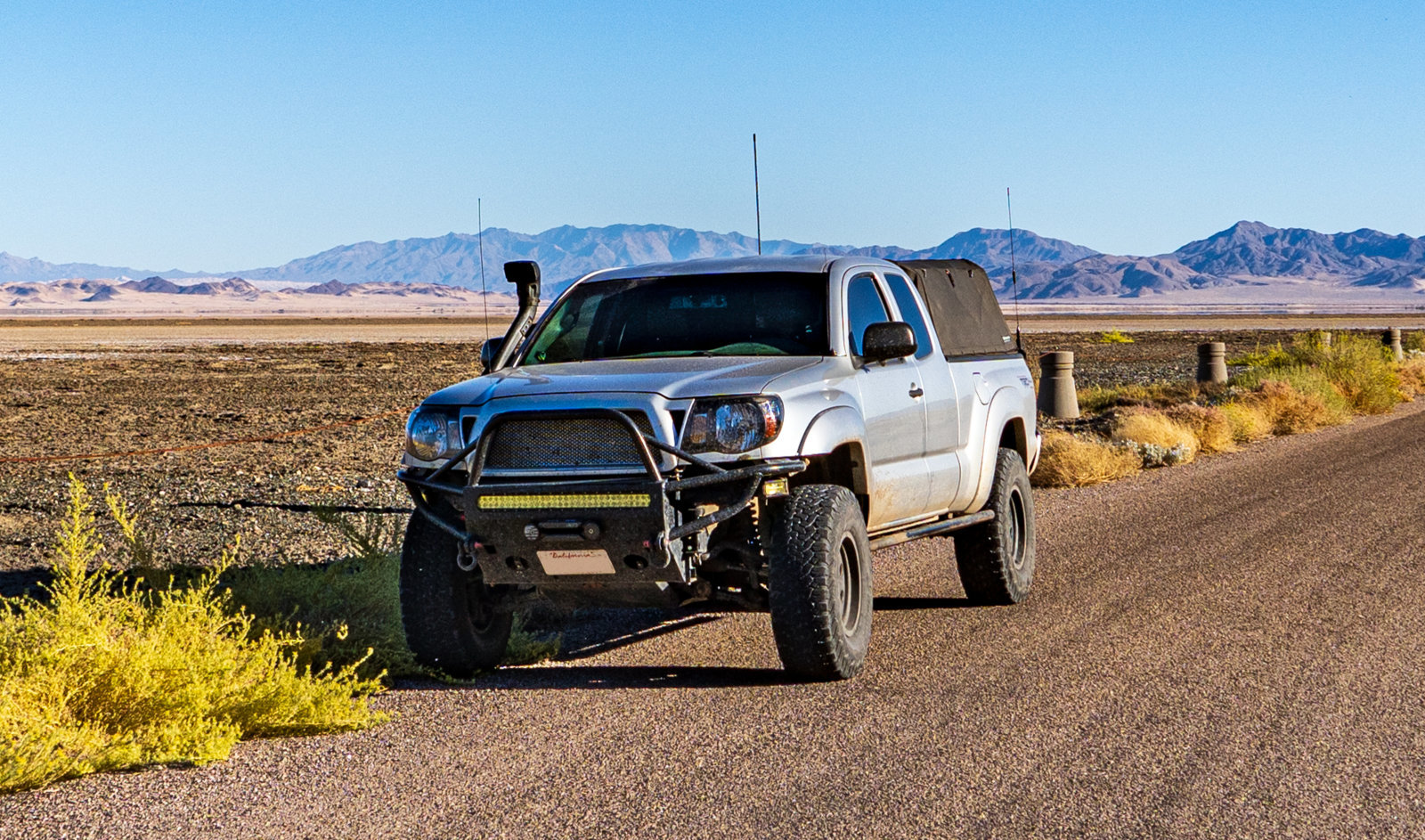

    For what it's worth, I wound up buying and installing the overpriced Yankum fairlead on my winch the other month.
    That's because I nosed the truck into a rock ledge and utterly destroyed the original hook at the end of my line. Then I ran over it a few times for good luck. Lost a couple of feet of line due to damage, but decided it would be easiest to resplice a loop and reuse the line with the fancy overpriced fairlead. I plan to eventually 3d print a cap that'll snap over the fairlead to protect the line from sunlight.
    I have since nosed into several more rock steps without damaging the line, so the fancy fairlead works! Of course, I have still never actually used the winch, or any other recovery gear, except as improvised weapons when fighting over front-row parking spots at shopping malls.

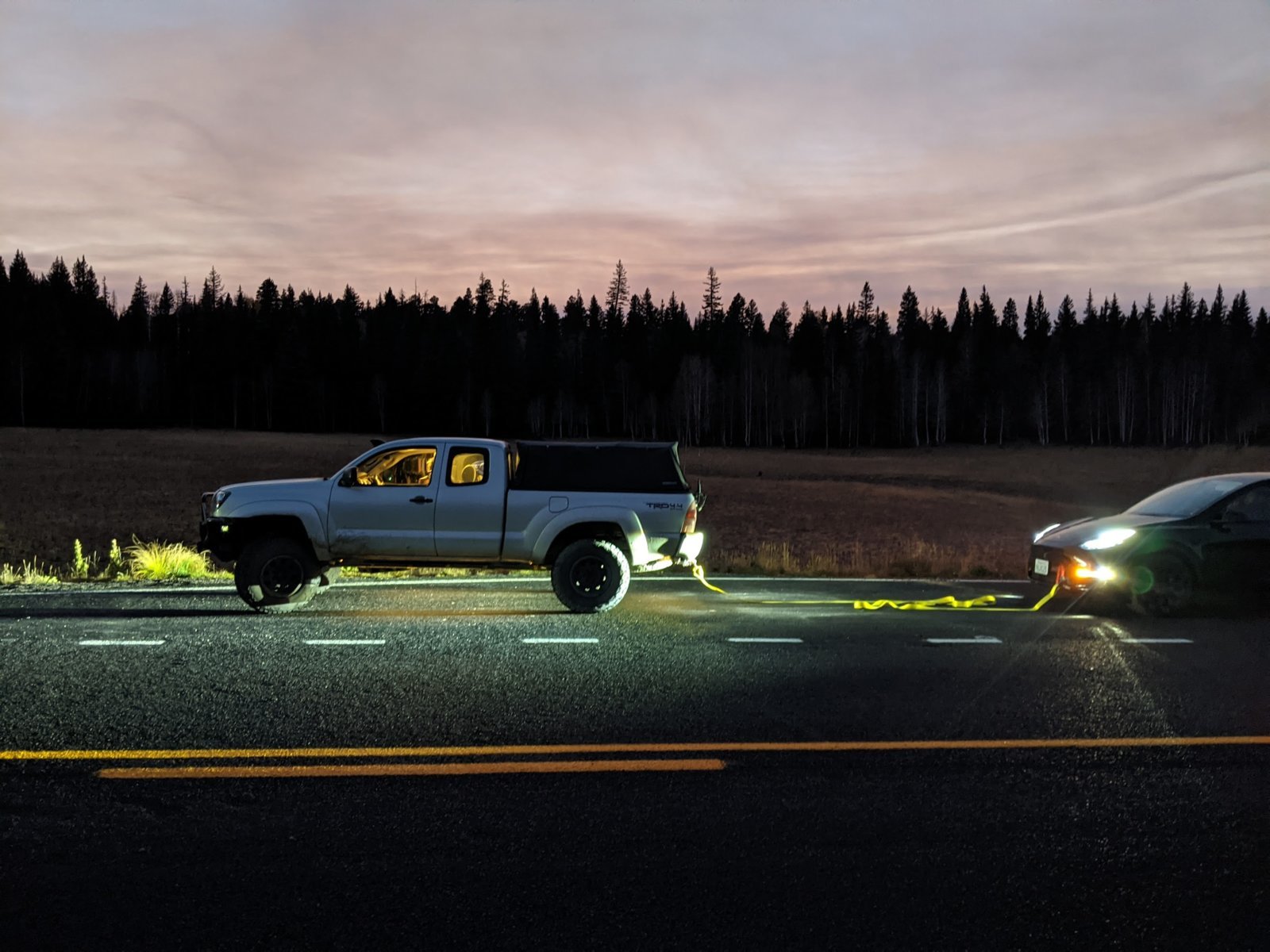

    Wait, actually I did use my tow strap for the first time last week... 10 years old and was still in its plastic wrap. Found a stranded Tesla and towed him to safety! But now the tow strap doesn't fit in the tool drawer any more :(

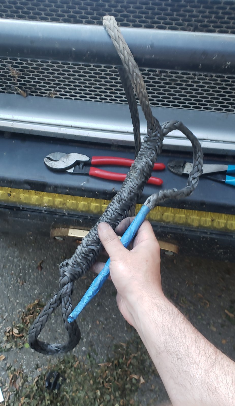

    Editing to add some pictures:
    I tried to do a braided splice first, but that was a laughable failure. Whatever kind of splice they tell you to use in the instructions... I forget what it's called... but do that one!
    Random shot from recent trip, check out that bling!
    First-ever use of tow strap! And shackle receiver hitch thing. Oh, and that's a Yankum soft-shackle hooked to the vehicle in tow... couldn't get the fairlead and not get a shackle, right???
    I have some cheaper ones too -- them's for throwin' -- but that Yankum shackle is 100% USDA Grade-A Beef.
