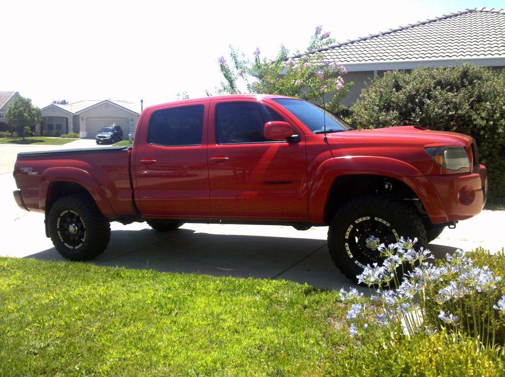

    So I finally got my Icon 3 pack in yesterday. I replaced my single AAL that I had before. I thought for sure that the single leaf I had wasn't very much lift at all, but I guess I was wrong. When I let 'er down, it was obviously I had some serious bro lean going.
    So theoretically, I should be at 2.5" up front, and 1.5" in the back with the Icon pack.... in most cases that should be level or close to it.... but my rear tires are sitting in the fender wells, and I have the extended shocks in the rear, which look like they only have a couple inches until they bottom out. Did I miss something and maybe I got the wrong pack, I never had the TSB done... the instructions call for removal of the overload spring, which I did.
    Suggestions? I love the way this pack rides, REALLY nice with the Fox's, but I'm not a big fan of the lean.
    Should I throw the overload leaf back in? Maybe put the AAL in with the Icons? New pack? There are 5 leaves in my pack currently.

    I'd throw the overload back in.

    Taken in the driveway just now. Its not on a level but its still very obvious. It rides soo nice, but I just don't know, especially with the extended length shocks.

    Seriously, I'd try throwing the overload back in and eyball it. You also have the option of a short 1" lift block.

    The overload should have no effect on ride quality, and only lifts the thickness of it right?
    Not too keen on blocks, I've spent the money to get rid of the cheap stuff, don't need to add more.

    Overload leaf does not touch the spring arch unless it's, well, overloaded. It prevents the leaf from flattening out too much or making a w shape. The icon 3 leaf should prevent that from happening as well...so in theory...it shouldn't make a difference in ride quality unless loaded. :notsure:
    I'm clearly just theorizing and trying to logically think through it (i.e. talking out my ass). Centering pins are cheap if you have the time to try it out.

    Understood. Yeah I was gonna get a couple. Should I order them through Toytec at 7 bucks a bolt, or do you think the local Vato Zone might have the right size.

    Toytec will rape you on the shipping I'm sure. If it was me I would try local first. You are in sac there has got to be a 4x4 place close that will have pins.

    Rgr, just haven't heard of one yet. Maybe I can find one at work. What size is it, do you remember by chance?

    Fuck me I can't believe I'm suggesting this, but iirc there is a 4 wheel parts in Sacramento. Also inchworm gear is in Cameron park and they are helpful to talk to for Toyota shit (but a rock crawler shop). You could call and ask them. I don't know the size of the bolt.

    I just ordered a pair from Summit Racing, $4.66 five inch long Superlift brand, 3/8" with $4.95 shipping. Superlift part no 38500. Less than 10 bucks and superlift quality.:)

    My UCAs bottom out very easily because of how much preload I've got. If you think this is fine then Ill give it a shot, but I only have like 2 inches down travel, so its very easy to bottom them out.
    I still need to get some though.
