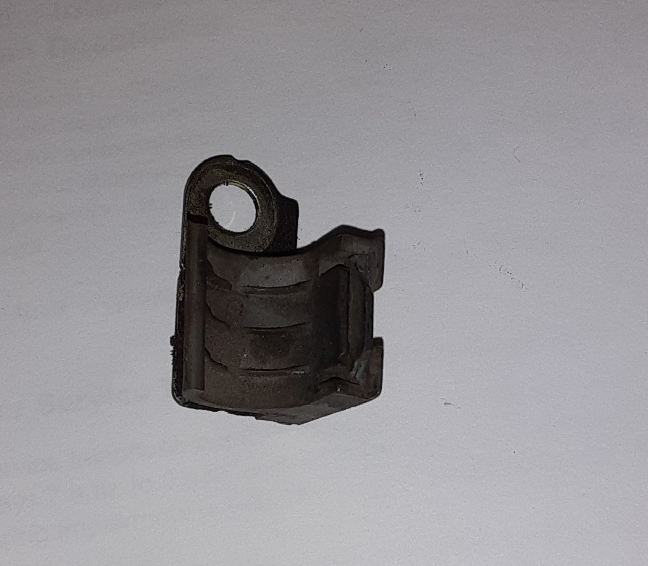

    I DIDN'T PUT THE WIRE HARNESS CLAMP BACK ON! I got the car back together, started up, did not break any wires, does not smoke or leak (yet). Now I put my tools away and there is the damn wire loom bracket sitting on my table!!!!!!!
    Please take a look at the picture of the bracket, and of the orange wire loom that runs along the left side of the head. The bracket I'm guessing is to keep the loom from melting and burning against the hot engine head, but when you look at the bracket, it doesn't hold it very far from the engine at all, just maybe a quarter of an inch.
    I do not want to tear this air filter junk off to put the bracket on. In your opinion will the wire loom be okay like it is now, or do you think it may rest against the head and cause it to melt?
    Big thanks to everyone who took time out to help me. I am a lousy mechanic. No wonder they charge $90 to $120 an hour. I couldn't do it, and I move so slow it took 5 hours to change a valve gasket.

    You'll be ok. That plastic can take a lot of abuse. Plus the valve cover valley isn't that hot relatively speaking. (I had one lean up against the exhaust and it only melted halfway and did its job protecting the inner wires lol). As long as its not like clamped against it I wouldn't worry.
    But now you'll know what to do next time!
