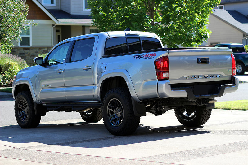

    I'm guessing they used the stock ones. They never said anything when I picked it up.

    That is correct. 5100's using factory springs that came with the truck and Deaver AAL's in the rear. Ride is super nice. very similar to stock but just slightly firmer. No bump-steer or wandering like I experienced with my previous two lifted tacomas.

    How much of a lift did your setup give you? I'm thinking I want about 2" when it's all said and done. Getting the same truck as yours except long bed.......and those badass wheels!

    1.75 front 1.5 rear. You can buy 1/4" spacers if u want the full 2" but it wasn't needed to clear 275 tires.
    You won't be disappointed with the wheels. I love them.

    What kinda off set do those wheels have

    FN Wheels Model Name: ƒ(x) Pro
    Diameter: 17"
    Width: 8"
    Offset: 0mm
    Backspacing: 4.5"
    Load rating: 955KG (2,100lbs+)
    Weight: 23.88lbs (approximate) (vs. 27lbs +/- for the OE wheel)
    Certification: JWL-T, VIA, SAE J-2530, DOT approved
    Colors: Matte gunmetal*, dark gloss gunmetal, matte black* and matte bronze - *Matte gunmetal available June 2015, matte black currently sold out until July 2015.
    Toyota specifics: 106mm hub centric for Toyota hubs, lug holes drilled for 12mm Toyota wheel studs for a snug fit,
