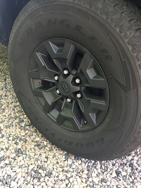

    Well I got some bro points today. Plasti dipped the wheels lol! They look good and should hold up until I can bite the bullet on the F5s!!!

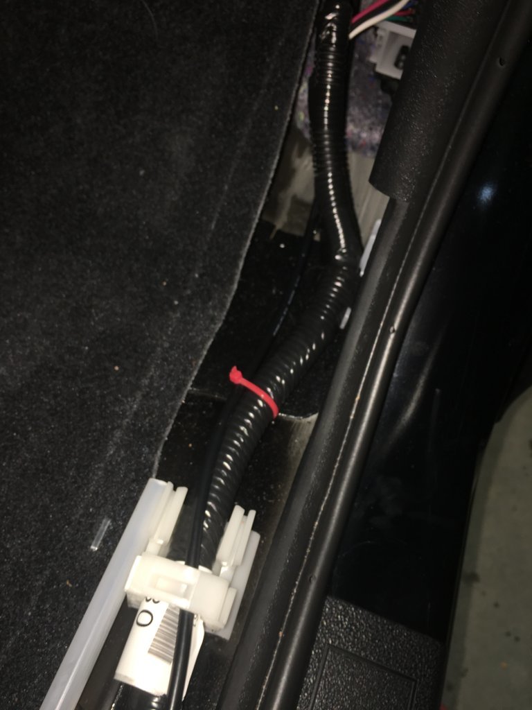

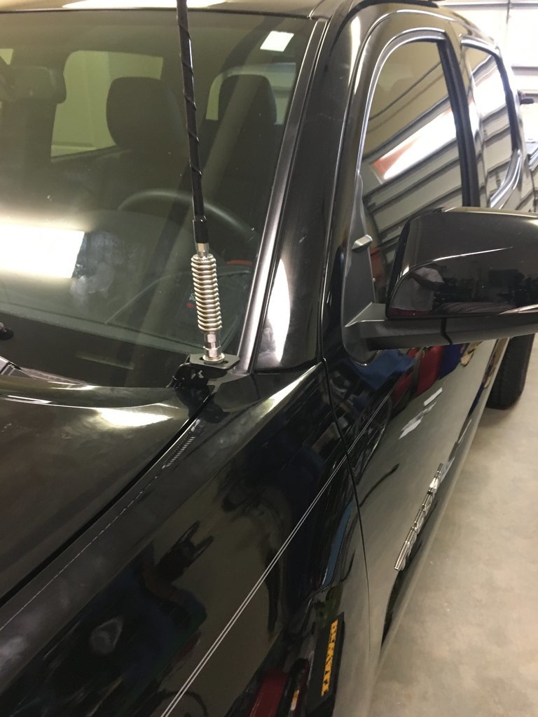

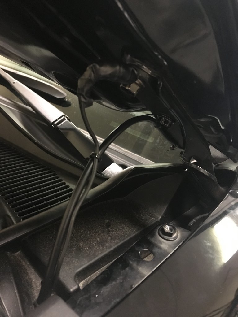

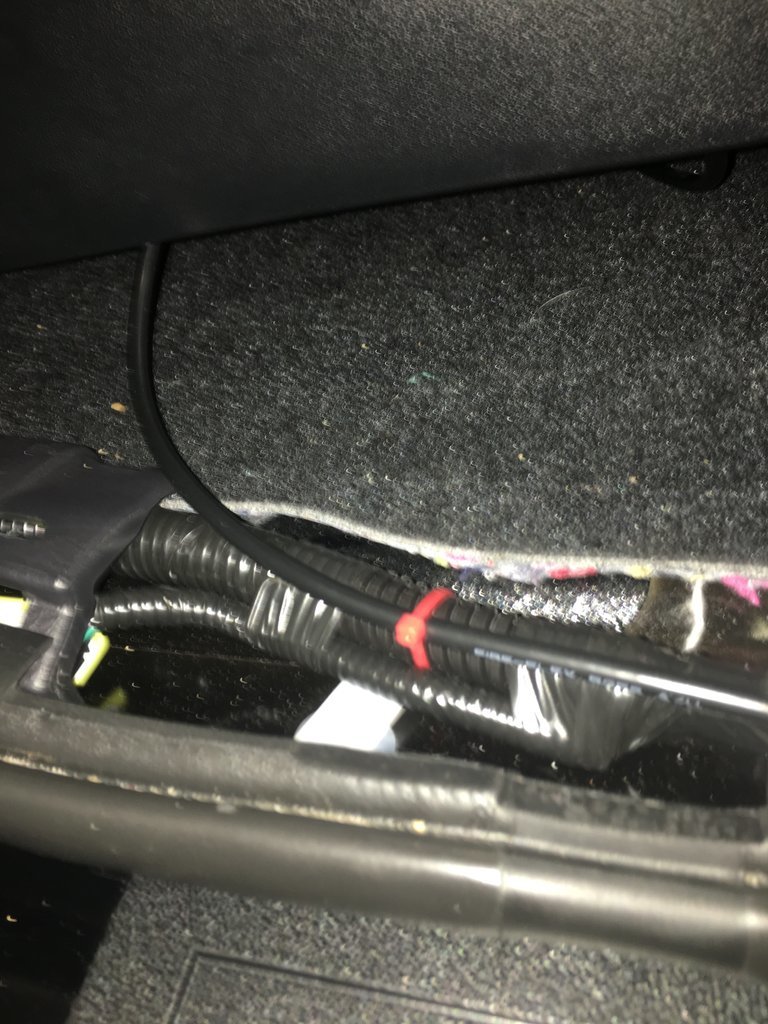

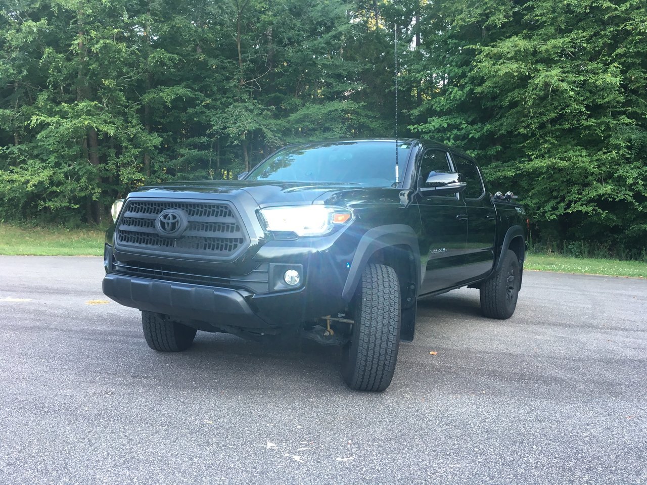

    Started with my CB install. I already had a Midland 75-822 Handheld, and had a 5' Wilson 1000 in the past and it was just too obnoxious. So I decided to run a 3 ft firestik on a Rago Fabrication ditch light mount. Ran the Coax through firewall on passenger side and underneath kick panel, step rail,and finally under driver's seat. The best I can get my SWR is 1.9 on both channel 1 and 40. I will try to work on that lol.

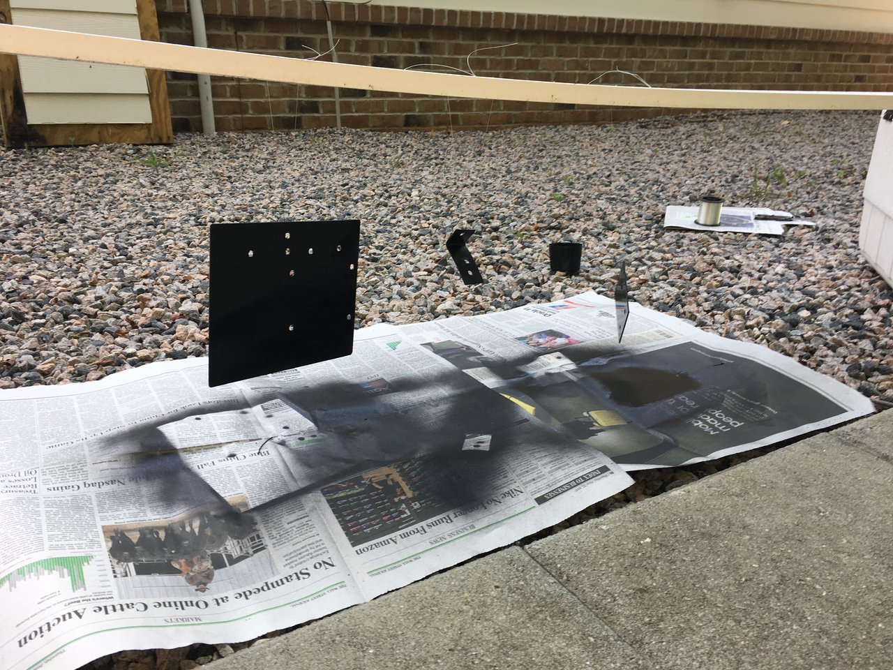

    Finally, worked really hard on my HID install. I chose the TRS Morimoto 35w 5500k kit. I bought off Amazon so I didn't get the 9006 to H11 harness adapter(had to run to NAPA to get one). They look awesome but a lot of work making the brackets which I made of 16g steel sheet metal.

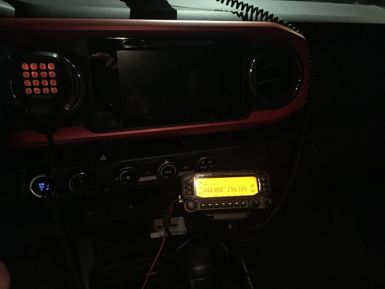

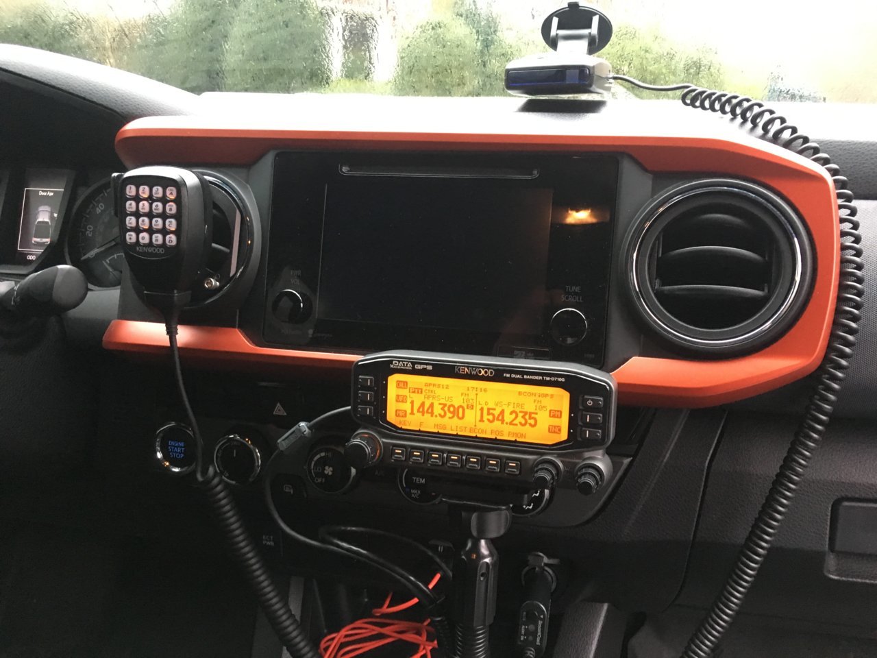

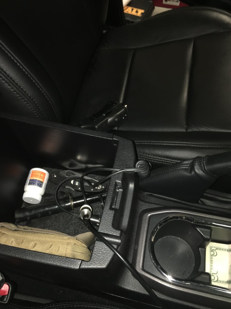

    Been a while. Dropped the cb, installed a Kenwood TM-710ga with a Larsen 2/70b antenna. It’s late so I only have a picture from the inside. Will add more photos tomorrow.

    Realized I never posted an updated photo of my 2m/70cm head unit install!
