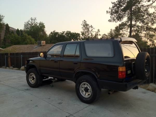

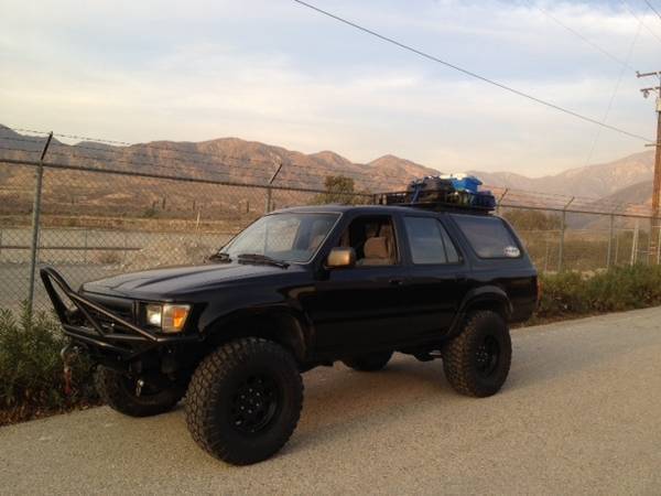

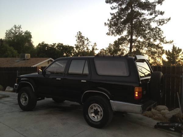

    Well..
    Woke up one morning and decided enough was enough, tired of beating on a $30k vehicle that I was still paying on.
    Parted out the FJ and traded in for a fun DD & was on the hunt for a new weekend beater/camp vehicle
    After looking at multiple Jeeps and a couple SFA 4runners, I decided that I wanted to find an all stock 4runner and make it my own. This will be a long term project and something to keep the A.D.D under control for awhile :p
    Started as a 100% stock
    Picked it up for $1600 bucks and she needed some love
    info:
    1990 4runner v6 (3.slow) 5 speed 4x4
    4.56 gears-open open for now( soon to be 4.88's and locked f+r)
    1.5" lift
    285/75/16 BFG KM2's w/ kmc enduros
    black widow roof backet with axe/shovel/60" hi lift
    hardwired on board masterflow 1050
    Cobra 75wxst with firestik
    Trailgear tube bumper with XRC8 winch
    removed the front sway bar
    Aisin manual hubs
    Ford Taurus electric fan mod with adjustable thermostatic probe
    More to come, Just want to keep a log and share my new weekend beater. :thumbsup:
    washed it up and gave the interior a good scrubbing and it felt clean enough to drive now lol

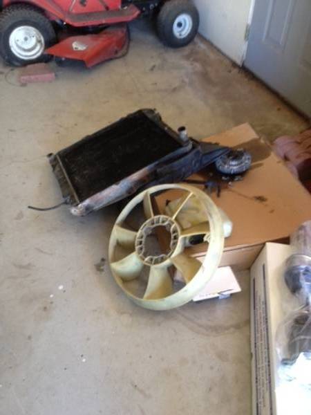

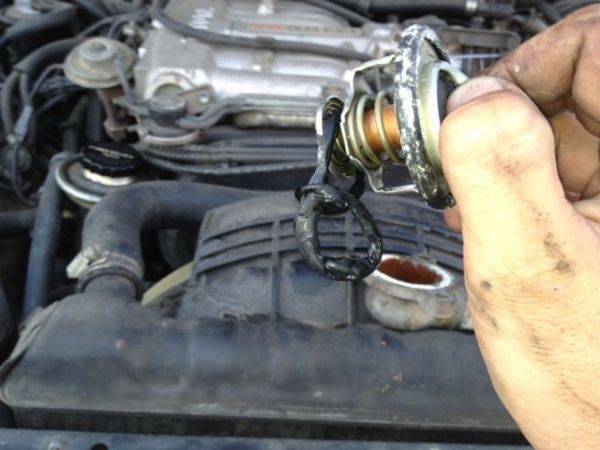

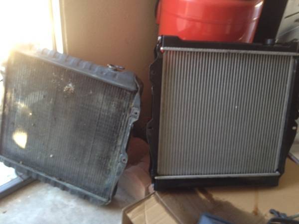

    Shortly after taking ownership I started experiencing some overheating issues so I tore into it and replaced the thermostat, radiator, and converted to an electric fan with an adjustable thermostatic probe
    ditched the old clutch fan set up
    mayday approves of the new beater lol

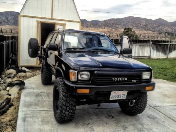

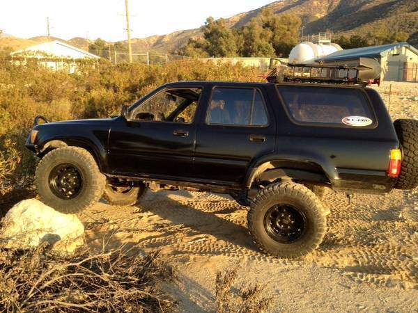

    still had my 285/75/16 km2's with enduros sitting around so I threw them on and added a rear coil spacer I also had laying around.
    also started going crazy with blacking out the chrome trim

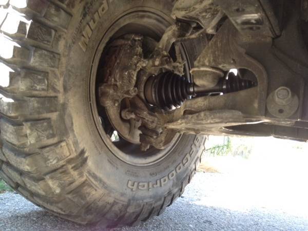

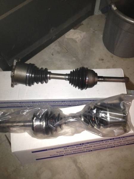

    took it to the trail behind my house and heard some clicking noises when I was in 4wd...checked...and the cv's were toast.
    replaced both cv's

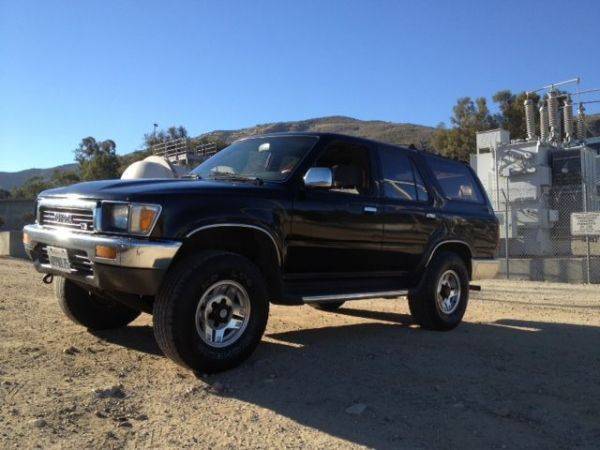

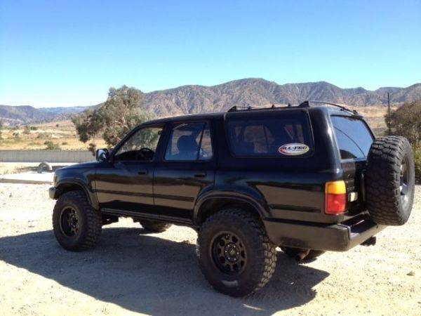

    Was pretty happy with the 4runner

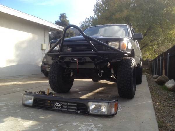

    and then ...yupp...mod bug bit me again

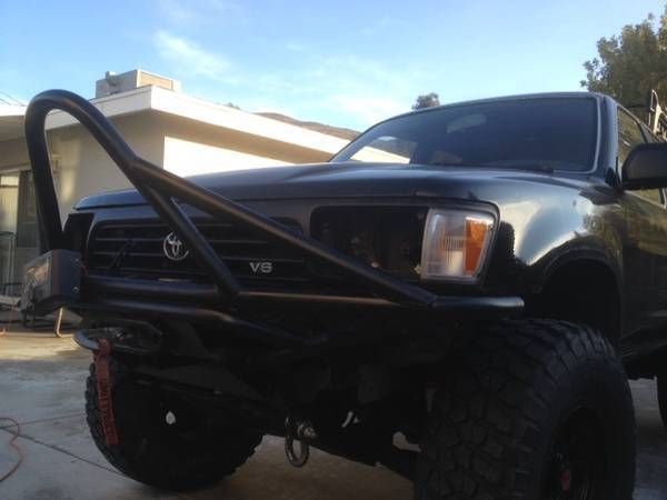

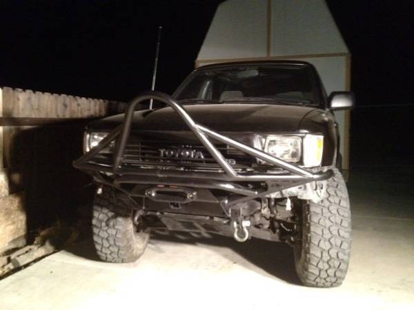

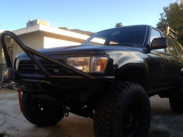

    Trailgear stinger bumper... must have been a swarm of mod bugs hovering around me ...because I immediately went back to the laptop and started ordering more :(
    1.5" lift with new (rancho shocks-eh...they will do for now) roof basket, mounted my xrc8, roof rack goodies, hardwired my masterflow 1050, installed the cobra 75wxst and fire stik and removed my rear bumper & hitch for better clearance.
    Aisin Manual hub swap... time for some traction mawdz :p
    BUT
    have two money pits sucking me dry
    Rmoreno1 likes this.

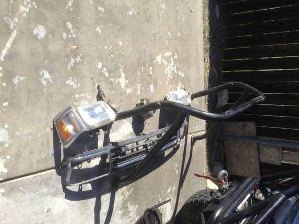

    haha. yea I need to stay away from pick a part :p

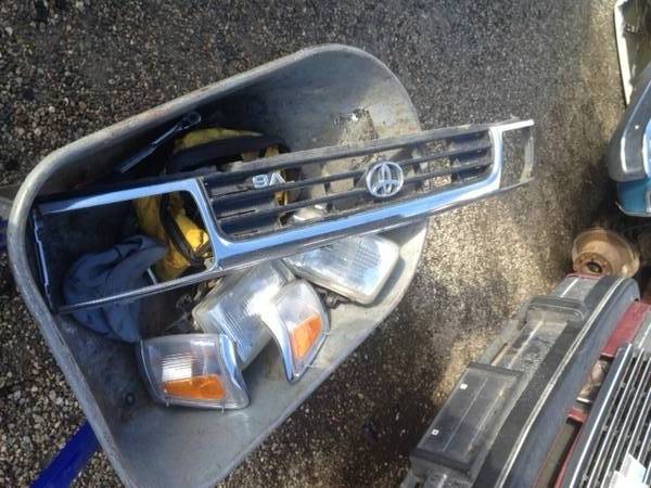

    scored a 94 front clip, rear roll bar from a 1st gen 4runner(need to trim 2")and a cs130 alternator for my swap. This dinky 60amp alternator is a joke lol
