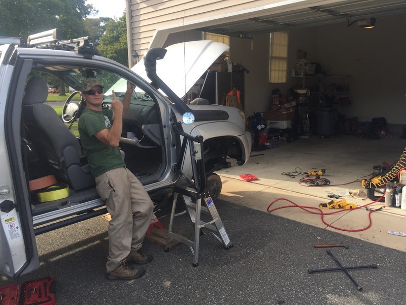

    Stopped over PSU taco85s place yeasterday and did a snorkel install

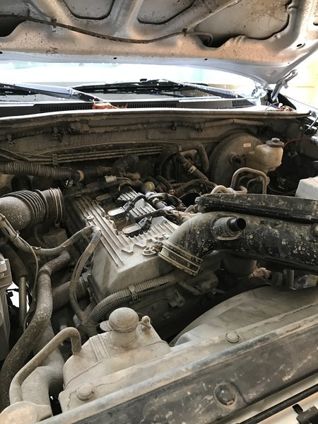

    At 76.7k miles today I decided it was a good time to clean the throttle body and hange the sparkler plug things. Idk they make the engine go boom...

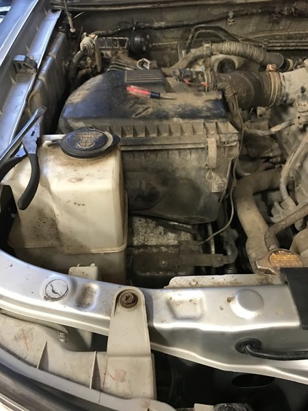

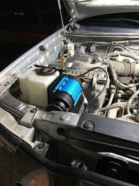

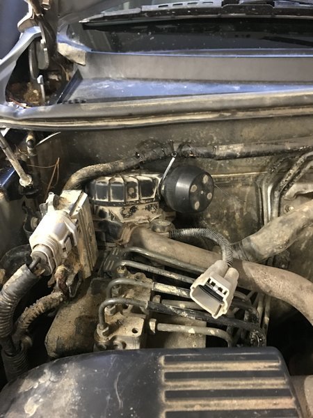

    Also due to my recent purchase of a kinetic rope and soft shackles from south east overland I ordered a Molle panel that replaces the back seats. So tomorrow I will be removing the back seats in preperations for that. I also purchased a dual ARB air compressor and the SLEE offroad mounting bracket... problem is that on the 4 cylinders the secondary air pump for the exhaust gas recycle emmisons BULLSHIT is right where the compressor is going to go... so I unbolted the pump and bracket cut the wires and the bracket and relocated it behind the ABS stuff... used some butt connectors to extend the wires and it works great!

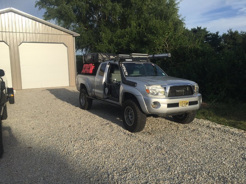

    After doing the fender bender mod I bought TRD sport OEM headlights on ebay slightly used. Looks better now
