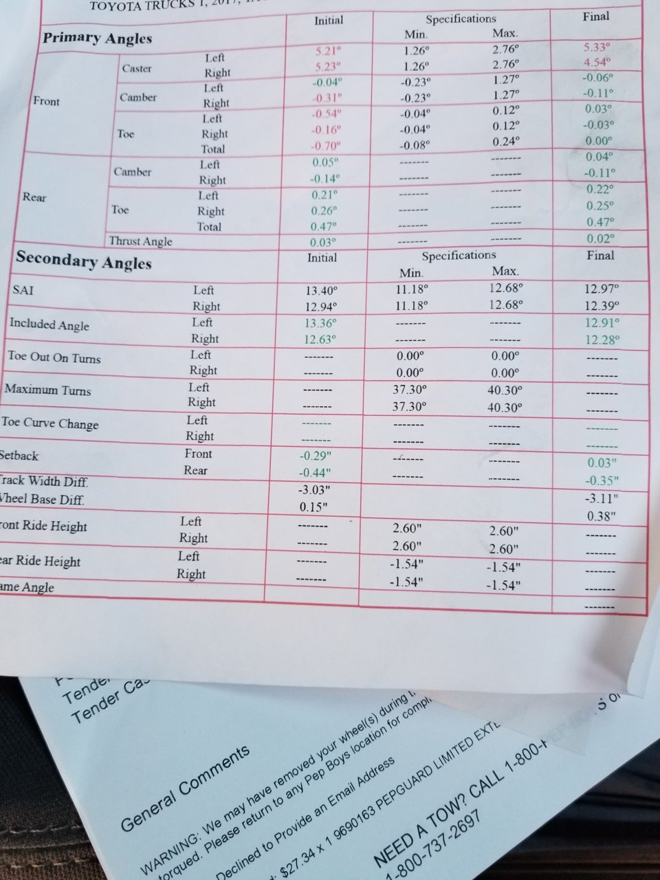

    Here are some numbers from an alignment I got a year ago [​IMG]

    That's probably the problem, they are tuff country, they were recommended from a group at work that run them with their lifts, I'm an old school 60's cars restorer guy and have aligned almost all of the cars and trucks I have restored over the years and like what I like on my alignments,, I realize price is exactly what you get and these were not extremely high cost :) I am looking for recommendations, I appreciate your thoughts on

    Heres numbers from this week.
    I apologize for telling you to go find someone who knows what they are doing. My fault. Just used to people complaining about alignments who take then to techs that don't know.
    I have JBA high castor ucas.

    I can appreciate those numbers, I guess my concern is that to get even 1.26 degrees I'm just at maxed and camber is 1.0. I know those are (in) but there is absolutely no room for any future adjustments,, I appreciate the thoughts though.

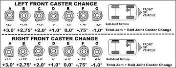

    These were teh arms I was looking at, what is the caster range on these?, I saw +or- 2 on camber but didn't see any other settings listed but know they do from what they say.

    Here ya go. I had some negative camber before my SPCs and I’m just right at about 0 camber now.
