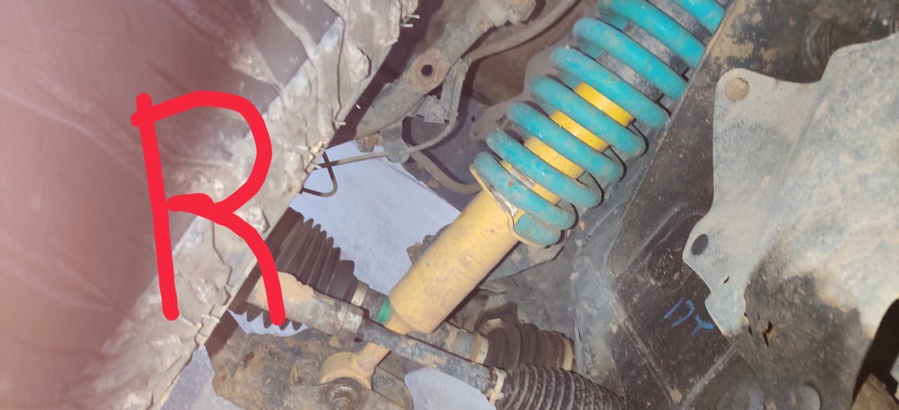

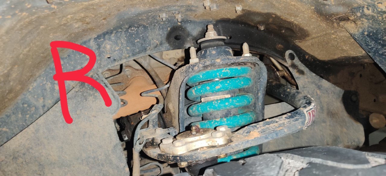

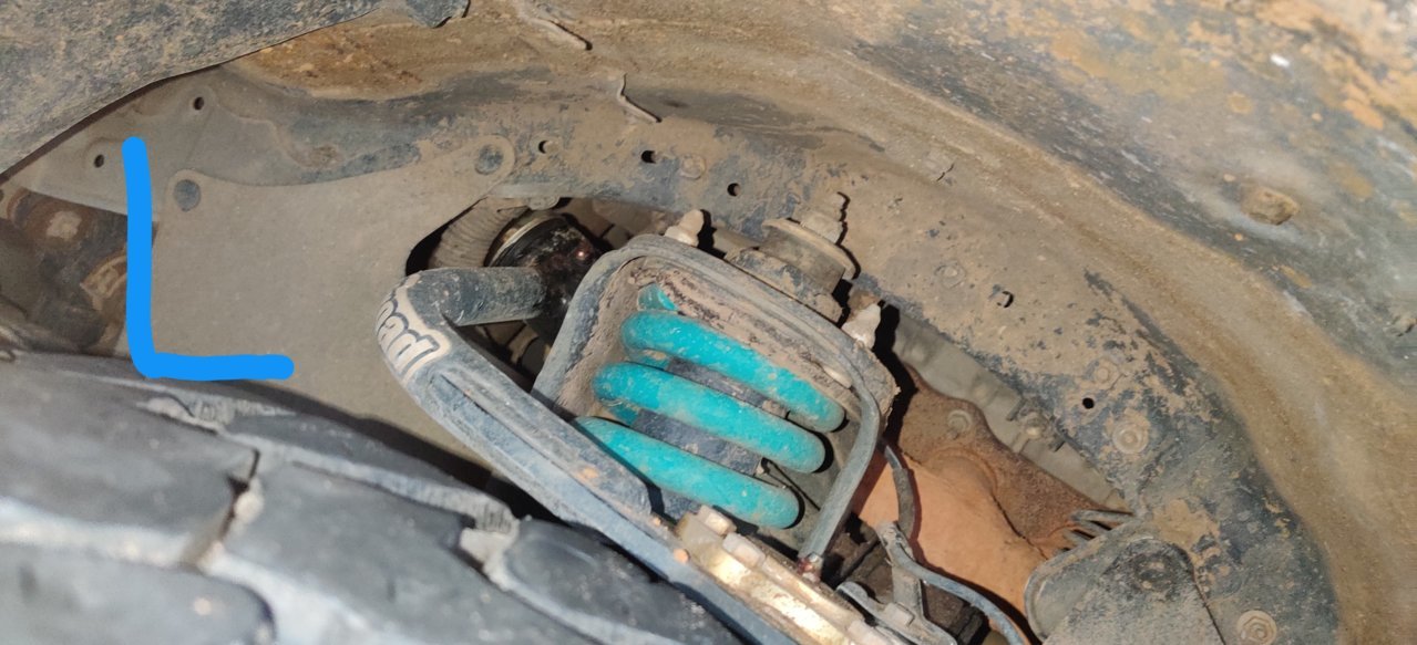

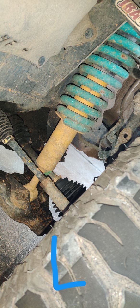

    From the coil.seat of the strut, to the top strut mount, they both show 11.5, or 12" depending on which part of the coil seat you're at. Important thing is, theyre both the same. Not sure where else to look.
    Yes, it's dirty. Hasn't been cleaned from the weekend.
    IMG_20210126_181435__01.jpg IMG_20210126_181425__01.jpg IMG_20210126_181402__01.jpg IMG_20210126_181350__01.jpg
