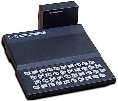

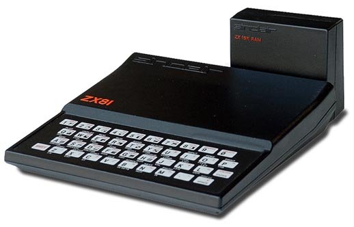

    Thanks! I think it represents my attitude sometimes.
    I can do one better than that.
    I still have a ZX81 in my attic which was later re-packaged as the Timex-Sinclair 1000. This little powerhouse had a whopping 1K of RAM which was expandable up to 16K with the 16K RAM pack shown in the picture above. It used a TV as the monitor which reduced the cost down to $150. This thing even had graphics and yes, you could even save your programs to a cassette tape.

    That is awesome ,I can remember when 4k of upgradeable ram cost as much or more than the computer you were installing it in. It really amazes me how much our Generation has gotten to see and how fast life has progressed since they popped off that first pair of nukes. If your avatar reflects your outlook then I'm sure you built an emulator and knew how to write simple hex programs and tested them in a sandbox, that were used for deciphering certain signals!!! Plus we get to drive Toys, I finally got the vibes my 2nd gen (69k miles) has had since new out!! It was missing some of bearings in one cup of one u-joint!!! Go Figure was like that since new!! Have a great day and Thanks for memorys!!
