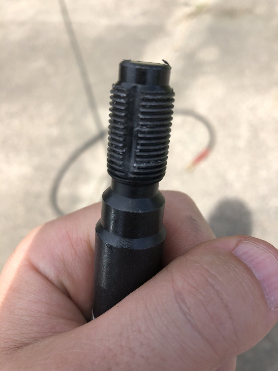

    3292D590-690E-46E1-80FB-B17491C7012E.jpg 2nd pass, went all the way through smooth. Will make a few more passes to see if it cleans up.

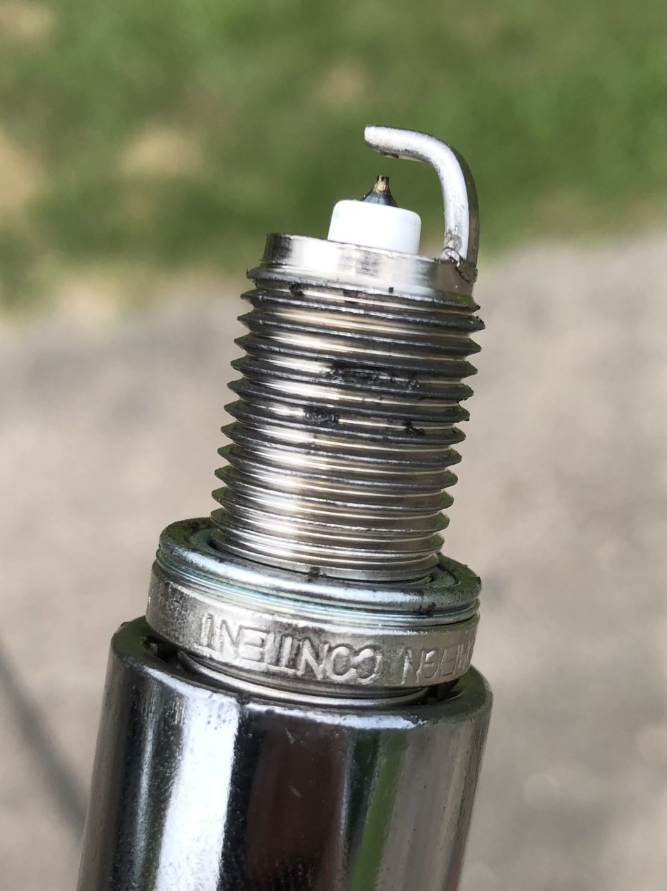

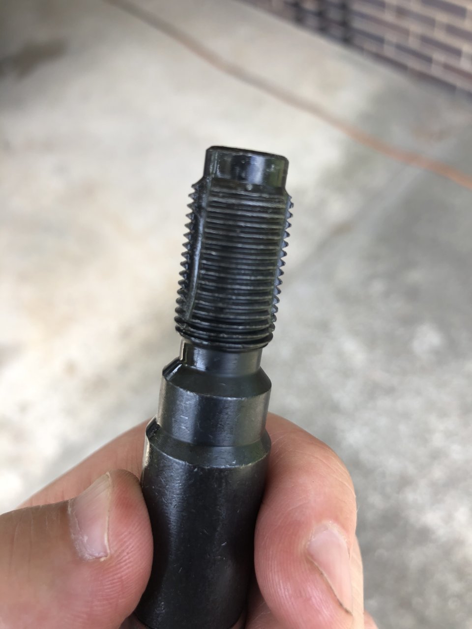

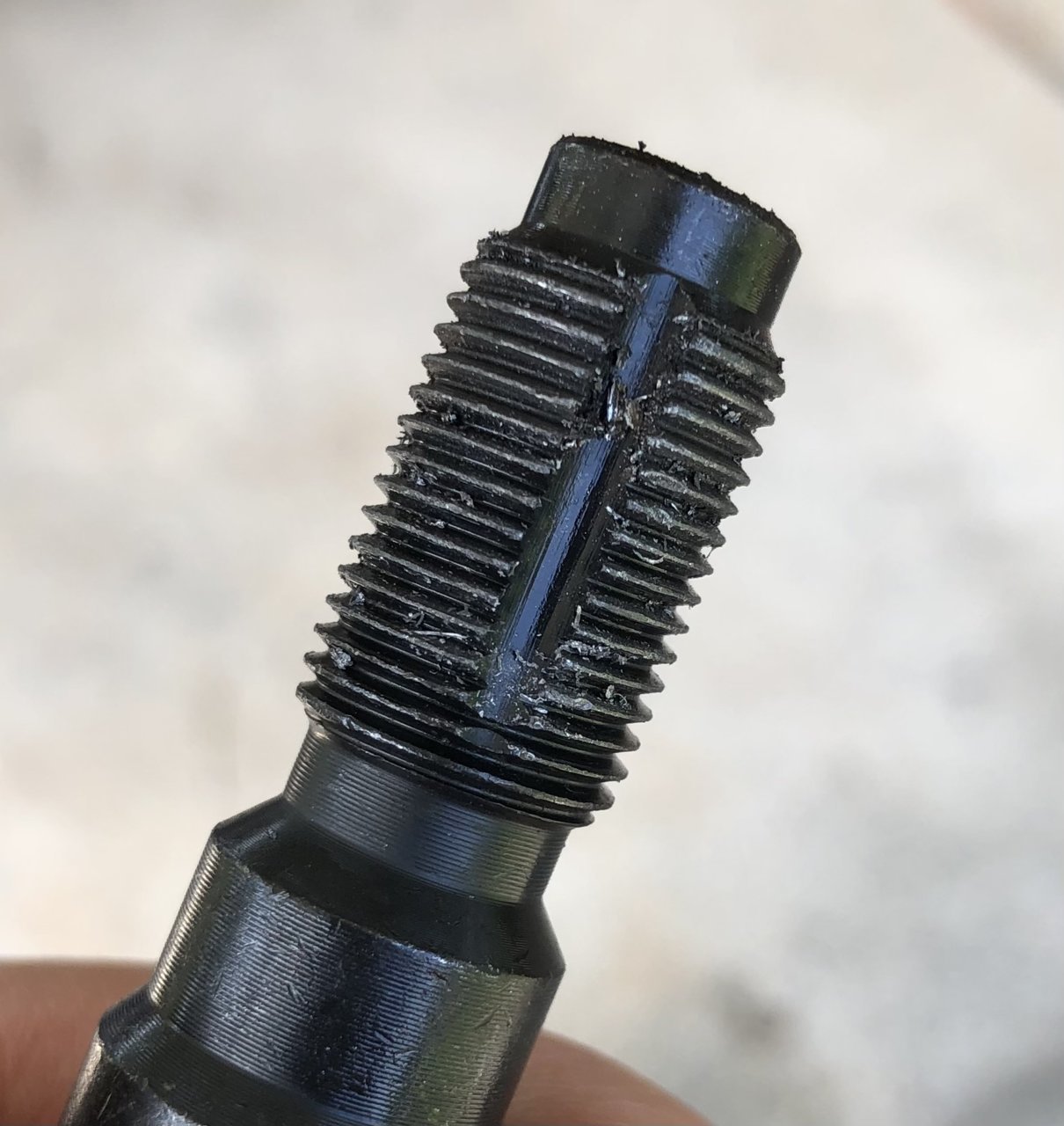

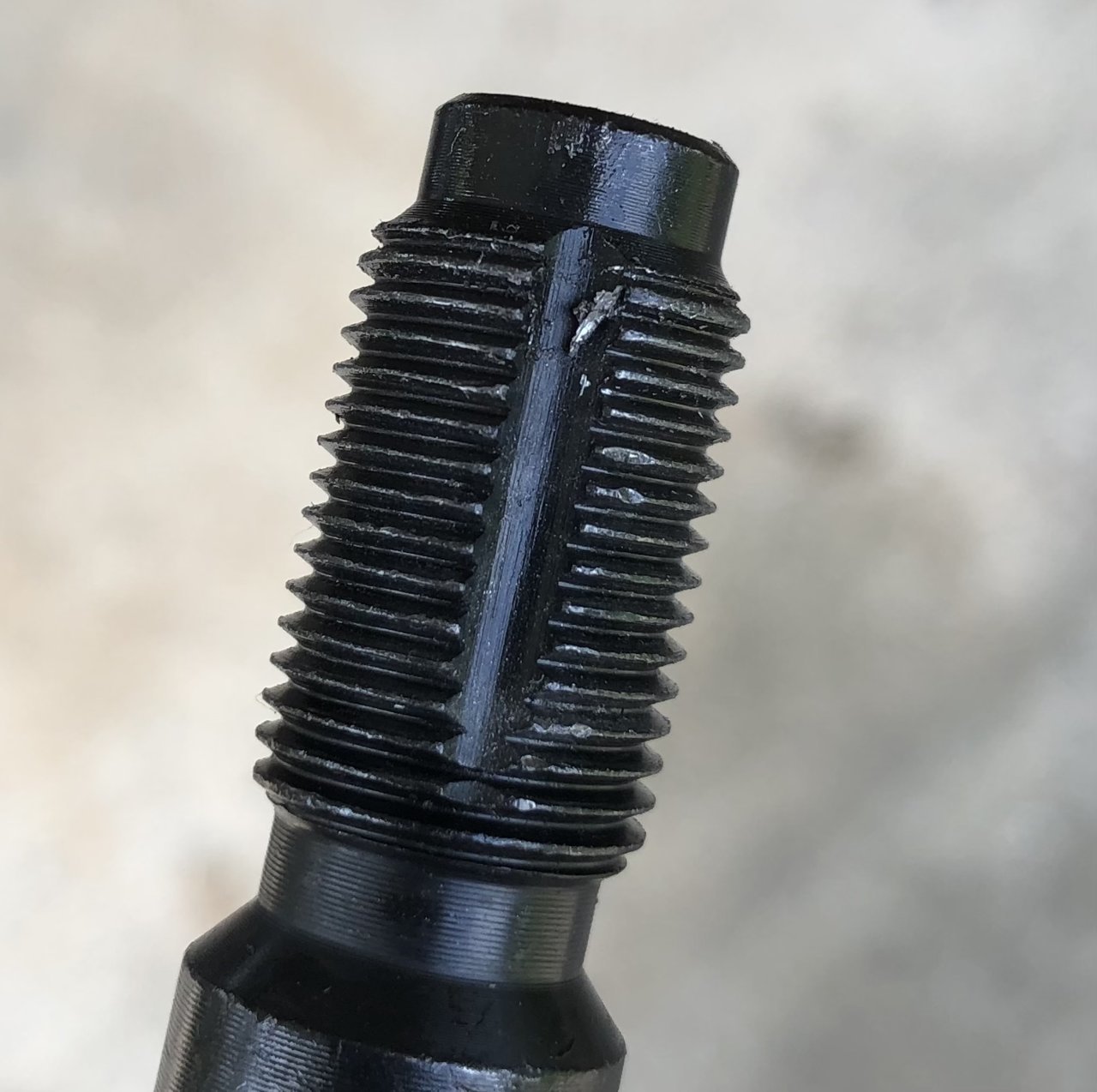

    Thanks man. I don’t know what I’m doing. I just tend to have good luck with things, even when things go wrong. It usually works out. I used the search function to find what a Heli-coil was. Went to get one and saw the thread cleaner tool next to it. Decided to get both and try the cleaner tool first. Here’s the 3rd, 4th, and 5th passes, then I put the new plug in. It went in easy all the way and torqued down to 15 ft-lbs. Then it came back out like normal with threads intact. Now I can carry on. I was getting worried for a minute.
