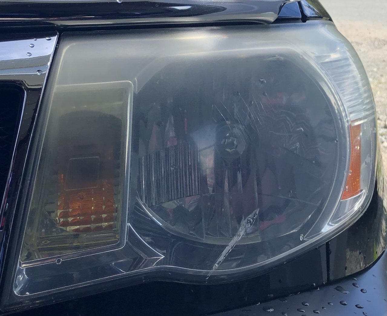

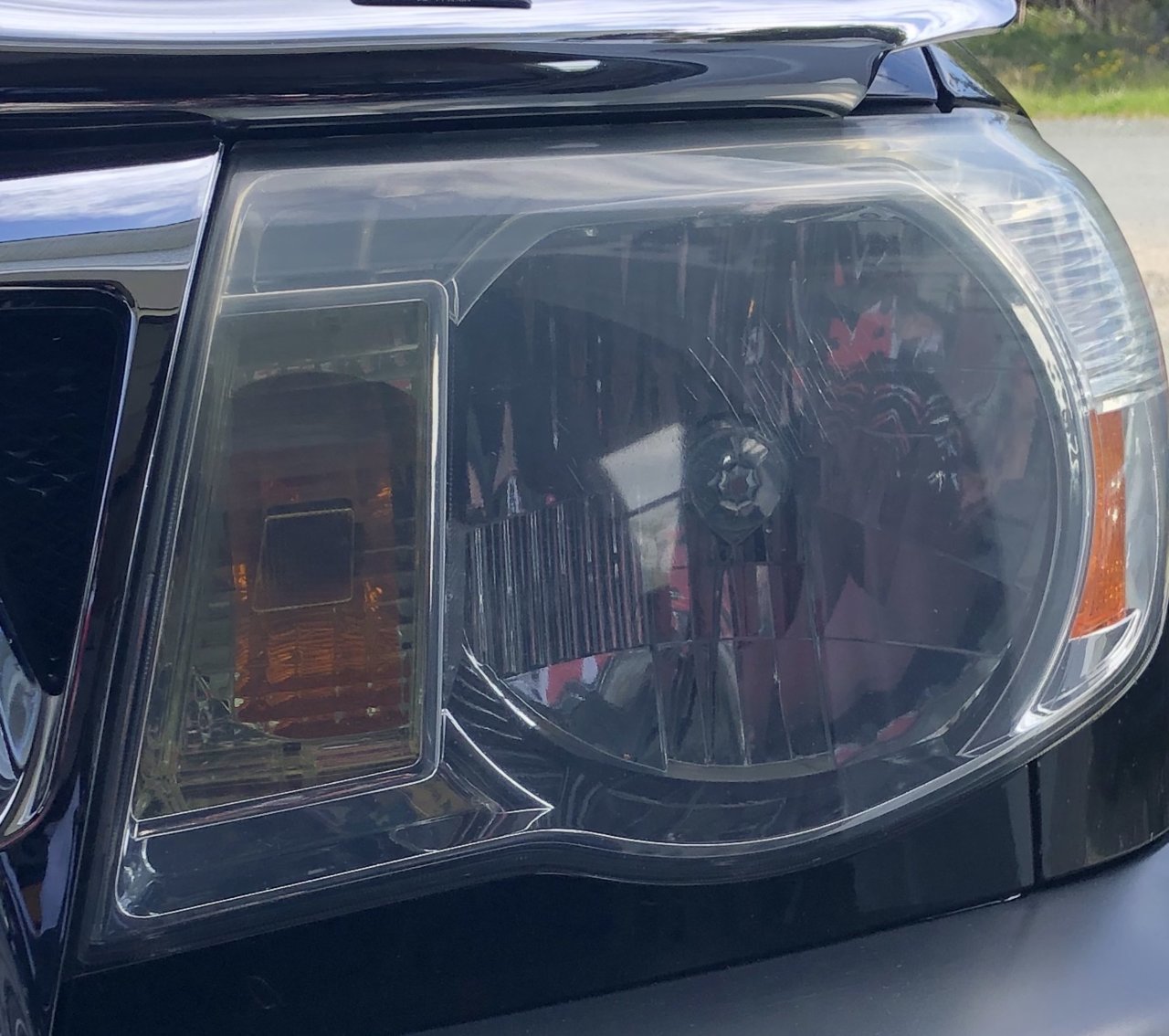

    Hey guys, I’m wondering if you know any good ways to seal the headlights after a polish. I’ve been doing the polish / wax method but it’s doesn't last too long. Here’s a pic of today, couldn’t find my orbital polisher so it’s about 10mins per headlight by hand

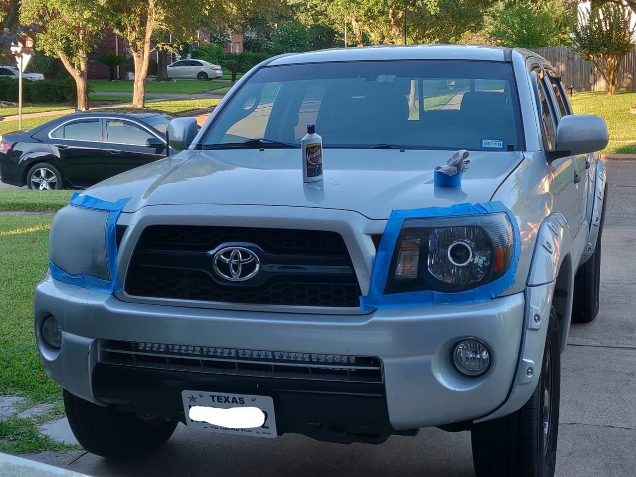

    Here's a picture I took after the plasti-x buffing and before wax. The wax really helps in keeping your newly polished headlight nice and clear.

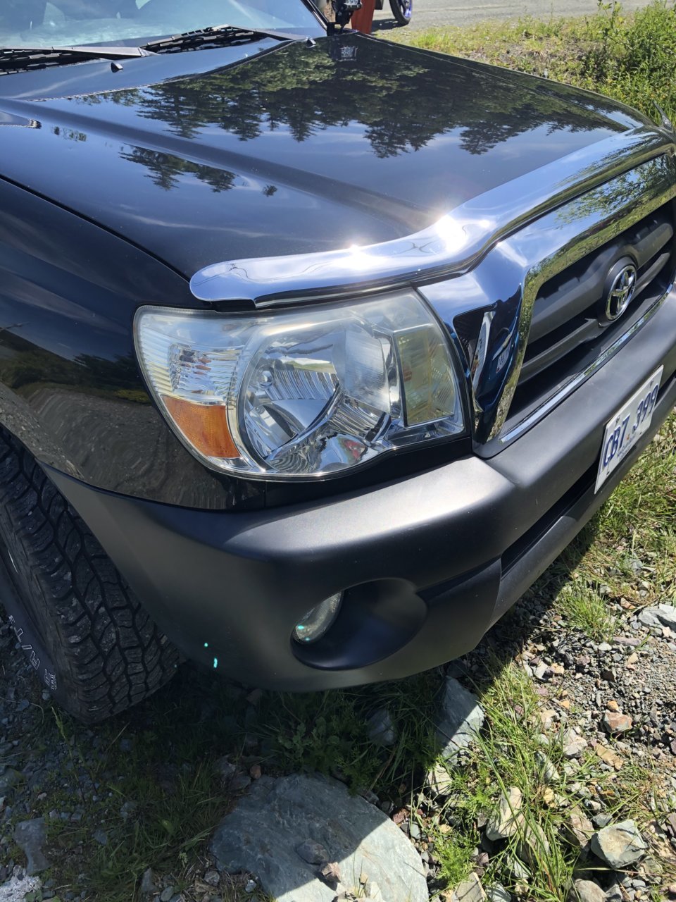

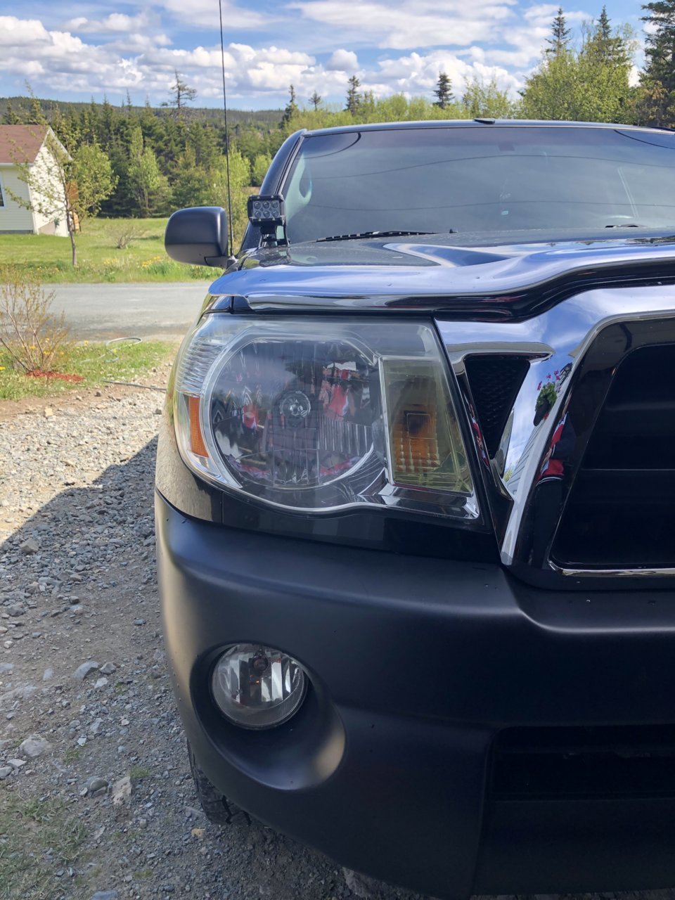

    Little update: decided to try plastx, the reviews don’t lie.
