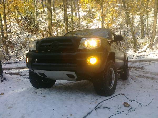

    I did the Hyper Yellow bulb replacement last year.... I run those lights and the DTRLs all the time....I only use my super bright aftermarket headlights when I need them.... These 4 lights are on ALL the time..... NO issues.....
