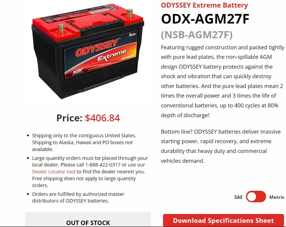

    That's one of the names I saw digging around in the search function results. I'm unfamiliar with them but I'll do some research for sure. Thanks for the testimony on both!
    Edit:
    I wonder how much this supply-line nonsense is going to affect my options...

    Odysseys are good batteries. If you look up "Expedition Overland" on Youtube, that is all they run. They definitely put their rigs and equipment through their paces. One of the reasons I chose to go with General Tires (coming soon).
    The supply line issue will definitely affect your options. Some off the shelf battery with a decent warranty will do nicely for now.
