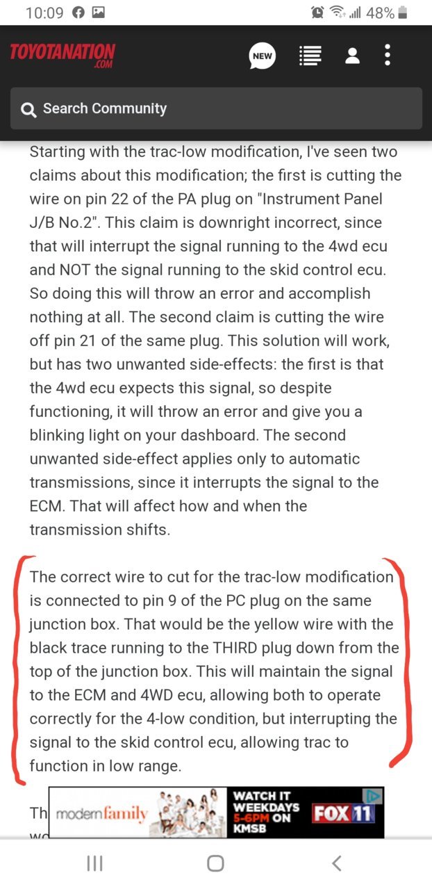

    Hey everyone... I'm looking into the yellow wire mod and came across this article. Seems straight forwardbbut just want to see if any of ya'll have gone this route with it. I have a 2012 trd sport. I would really appreciate your thoughts on this. Thanks.

    I added a switch (traction) so I can cut it in and out. I can’t say its magic, its easy enough to do, another tool in the kit.

    That's a sweet switch.. Haha. Did you do the updated mod or the original that has the light flashing?

    Do a search in TW for “yellow wire mod”. The yellow wire with the black tracer is the one to cut.
