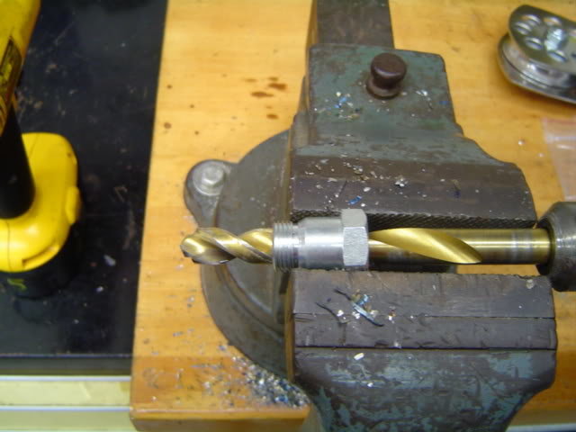

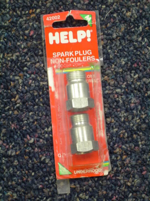

    An exhaust leak can cause this code. There has been some success with using an anti-fouler. It's basically a shroud that screws goes over the end of the O2 sensor. It's cheap and worth a shot.
    You have to drill one out with a 1/2" bit, then screw the sensor into it. The non-drilled anti-fouler then goes over the drilled one. Then the go into the exhaust.
