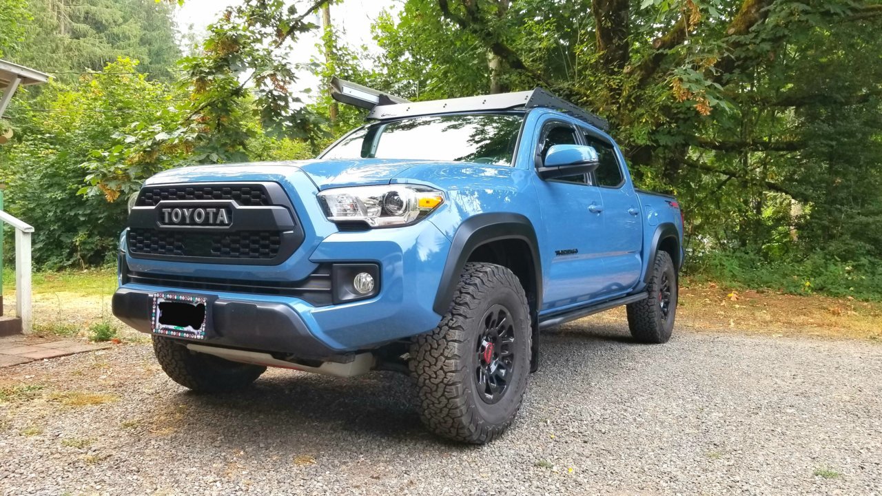

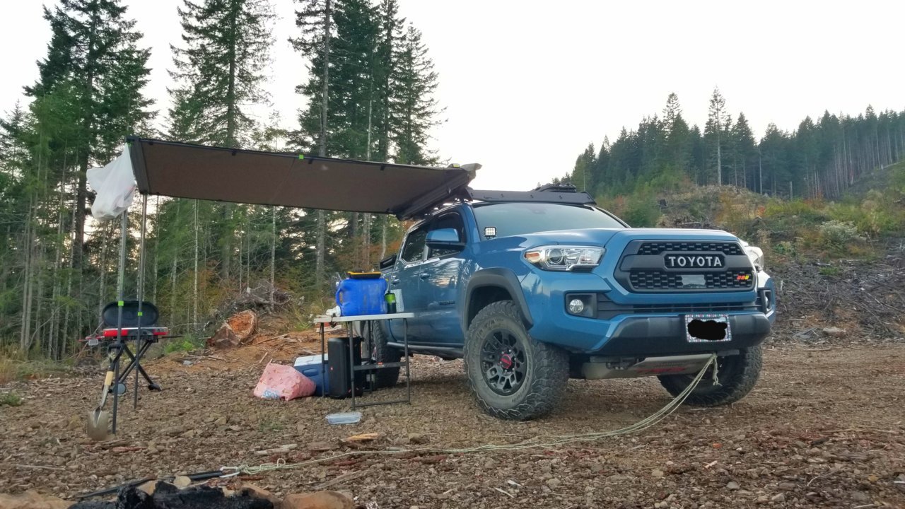

    So I'm looking to do a suspension lift for my truck. I'm wanting 2" front and 1.5"-2" rear. I don't plan on going bigger in tire size, currently I'm running 265/75r16 E-load KO2s. This truck is my daily driver, but I'm also very big on adventuring and offroading. I'd probably say the truck spends its time about 60% on-road and 40% off-road. I hit some pretty gnarly tails when out wheeling, though not much if any rock crawling. I do haul a pop-up camper that's around 2700lbs every once in a while and only during the 3 months of nice weather we get in the PNW.
    I don't plan on adding metal front/rear bumpers for a couple years, and I'll worry about making the necessary changes for those then, but I want to put it out there to keep in mind for possibly picking something that'll "upgrade" easy for those.
    I'm up for any and all suggestions to suspension kits that'll get me the 2"/1.5"-2" lift with my type of driving in mind. I do like the idea of a full kit in a single purchase as to not miss anything I'll need for the job, but a comprehensive enough list would most likely do as well.
    I would say my budget is around $1500 but willing to fluctuate some if it's worth it. I know I could save longer for "better" but I just personally can't spend upwards of $3k on suspension even if I could.
    A couple concerns I'm wondering about with a 2"-2.5" lift.. Will/Do I need new UCAs? And will I need to worry about the needle bearing issue?
    Currently I'm eyeing these options. Feel free to talk me into or out of them.
    This GTS set is apparently made by Dobinson's, but tuned by MLO. No hiding the truth, the biggest reason I'm into them is the color scheme. But I've heard great things about Dobinson's, just haven't heard anything about MLO and this kit.
    https://www.mainlineoverland.com/co...gts-suspension-kit-3rd-gen-2016-toyota-tacoma
    ARB OME set. Another brand I've heard great things about. I do like the color scheme too.
    https://www.bilsteinlifts.com/shop/...QSS1I_YI4AEEFMG0FO33U2HCPK1SZKl8aApGgEALw_wcB
    And then the Ironman4x4 kit. This one I've heard fantastic things about their foamcell pro suspension, but I hate the color scheme, like I really do :(
    https://ironman4x4america.com/toyota-tacoma-2005-foam-cell-pro-suspension-kit-stage-1/
    Lastly, pictures of the truck for attention

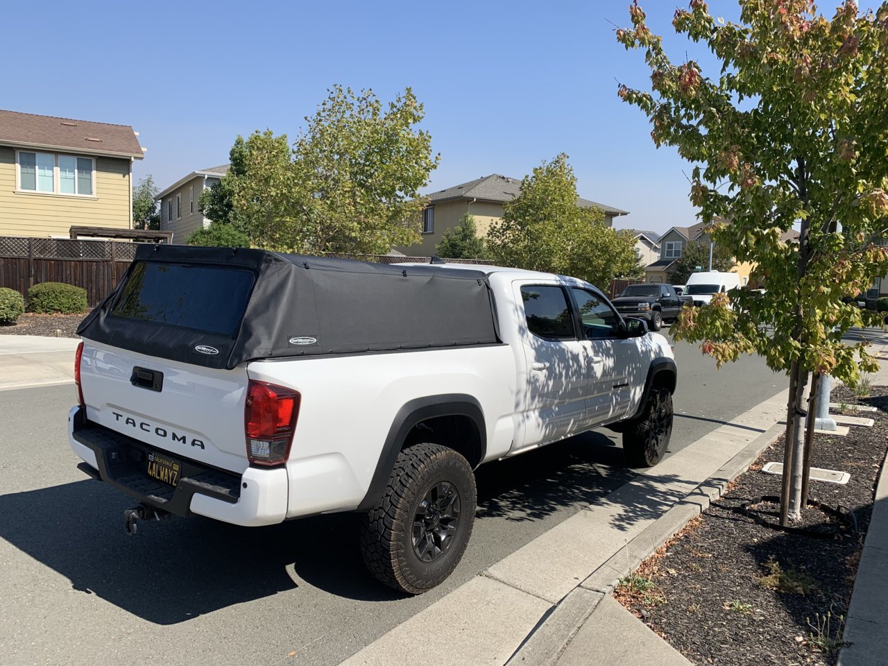

    265/75/16 on Bilsteins 2” front 1.5” rear aal IMO great budget lift. Eibach is also a great lift. Good luck OP.

    5100’s all’s round deaver aal in rear. For me it’s perfect.
