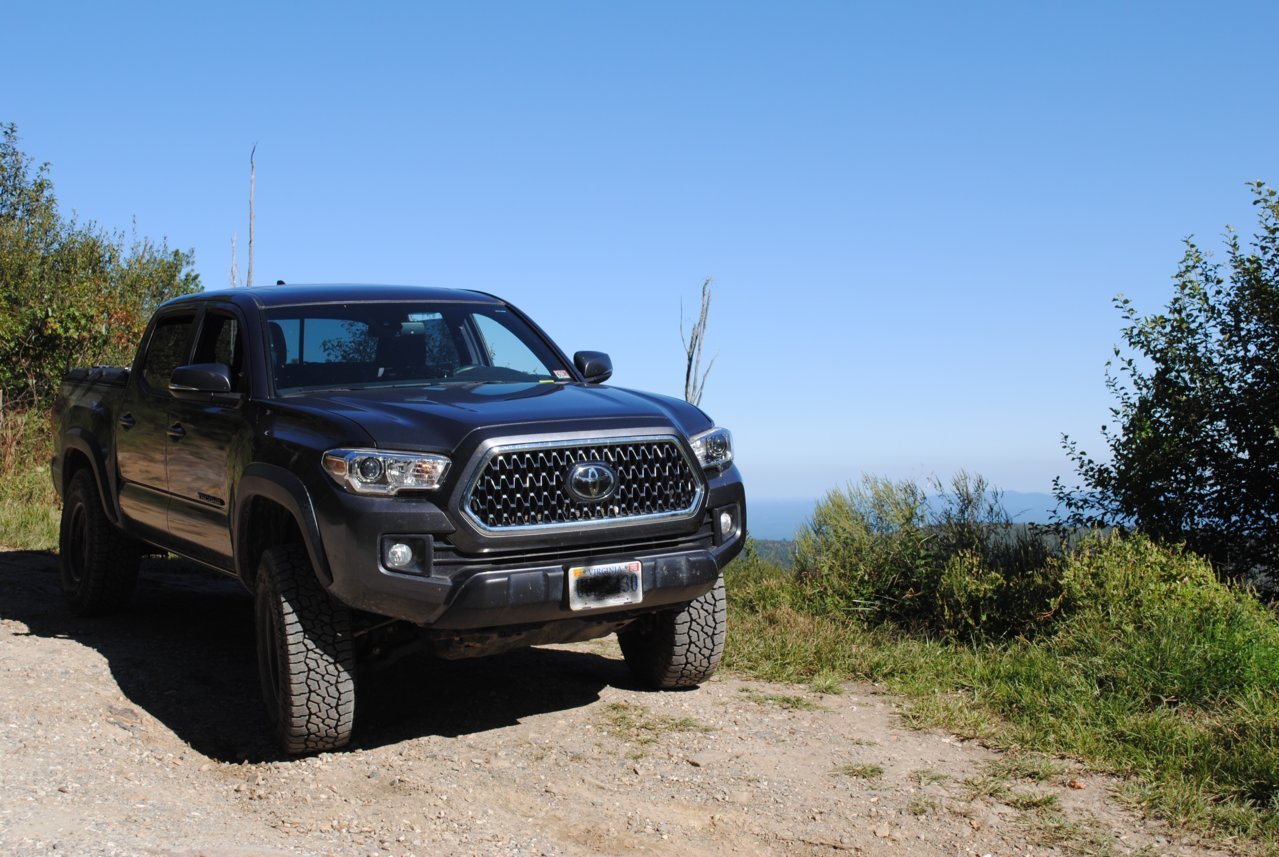

    OP - I have this custom kit with SPC UCA, Ext travel Icon coilover, 2.0 rears with a 2" block (for now). Can't say enough good things about this setup. My truck is the magnetic grey that's linked. I was on the fence about spending more and going beyond a budget (5100s) setup but wouldn't do anything differently if I could do it again.
