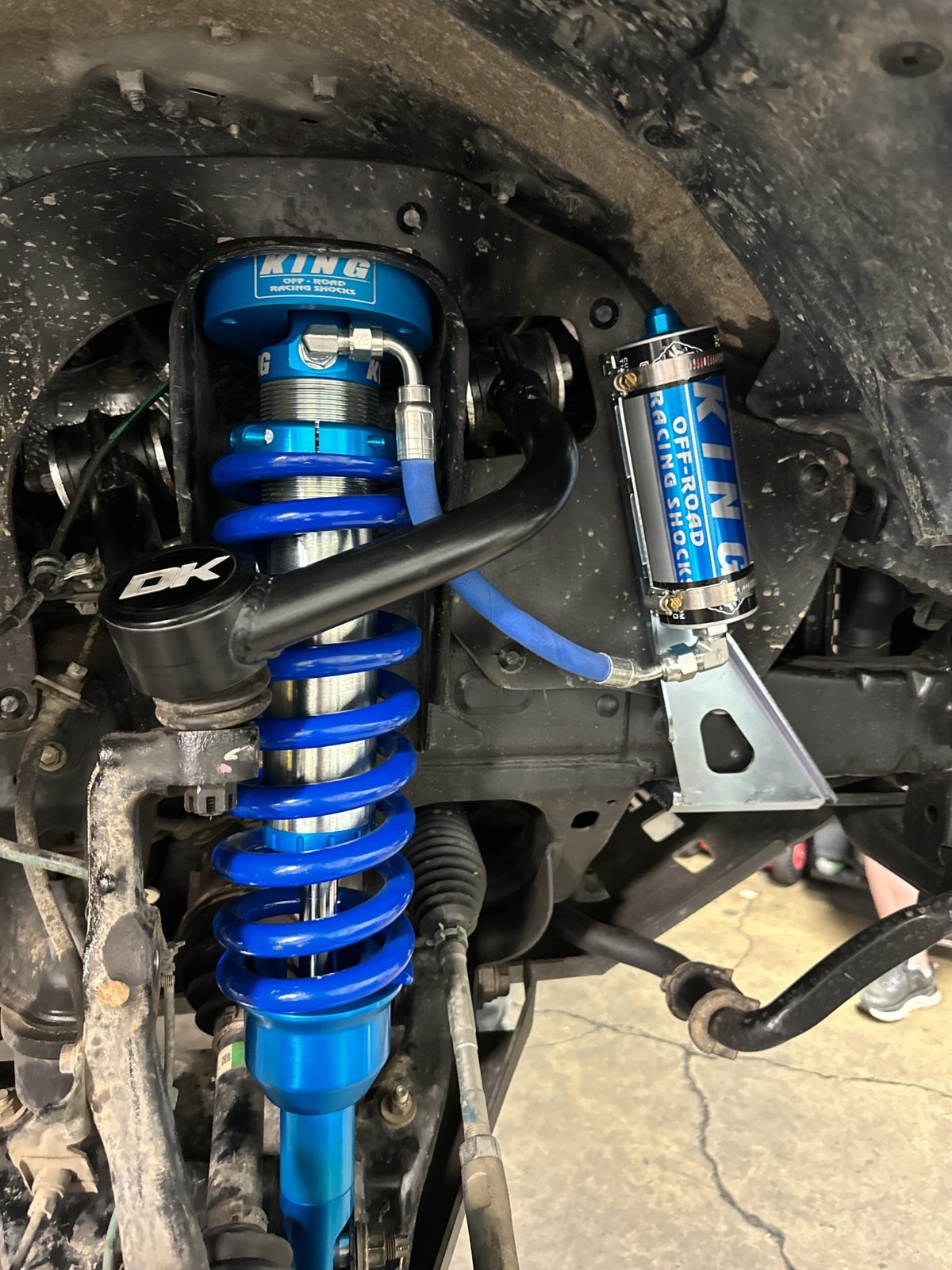

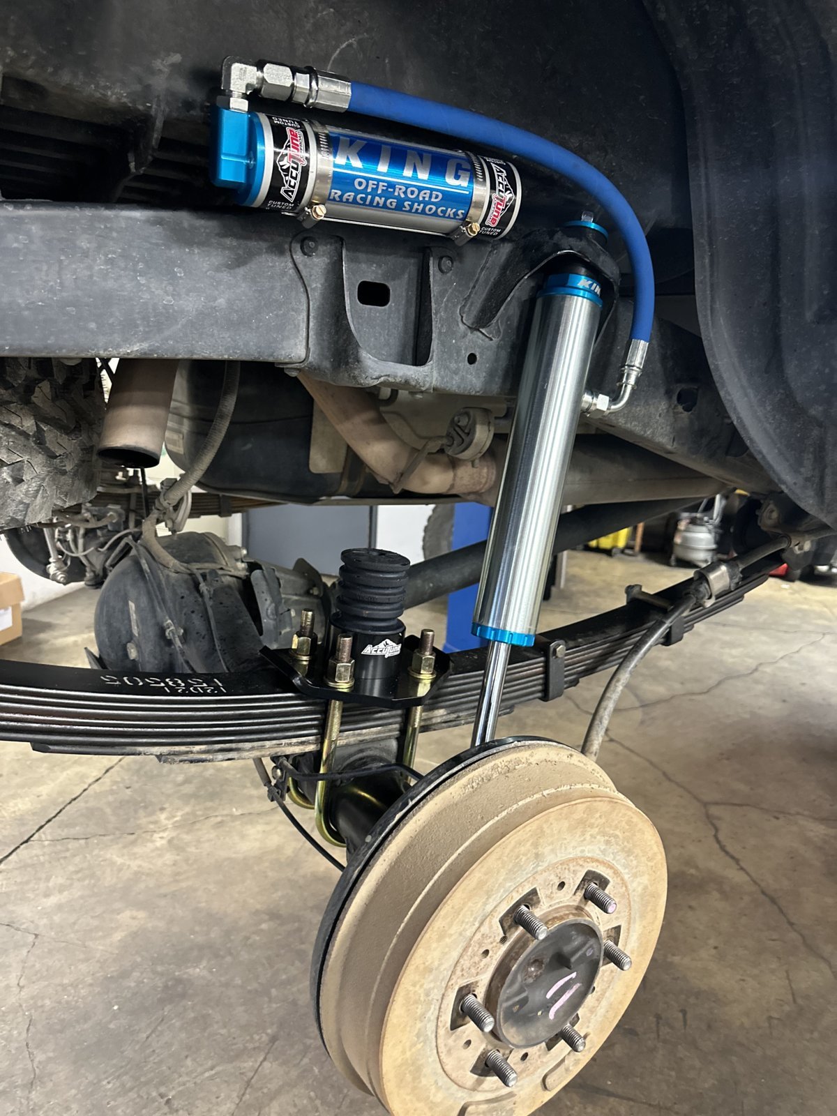

    Alignment on Tuesday. :thumbsup: Driving around town is great. Can’t wait to go off-road
