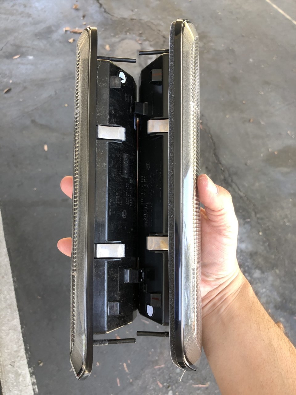

    So, there is a third revision to this light.
    As mentioned in my previous post, mine just started leaking and out of warranty. Appealed to Toyota and I got a “no”. Service advisor was shocked and sure they were going to do it. He apologized, gave me a massive discount on the diagnostic cost and gave me a 30% off coupon.
    Gonna shoot Toyota headquarters an email expressing my disappointment in the decision. I’m not going to be dramatic or anything, truck will stay forever, but I won’t be purchasing another Toyota. I’ve owned 4 fords (all mustangs), 3 M3’s and 2 Subaru’s and a Honda . Never had these little simple issues like this truck has had and all of the bigger ones have been fixed by the company (yes, even out of warranty.....example was Honda repainting my civic with 80k miles under recall for crappy paint). Maybe I’ve just gotten lucky. Who knows
    Still love the truck, so I will enjoy it as long as it runs.
    Anyway, enough whining! Part numbers:
    Original 81570-04040
    One on TSB 81570-04050
    One handed to me today 81570-04051

    Did you examine it to see what the difference was?
    MGMDesertTaco, Skydvrr and STrooper like this.

    i’ll post pics when I pull it out. Life is pretty crazy but I am thinking mid next week I’ll have a couple hours to knock it out.

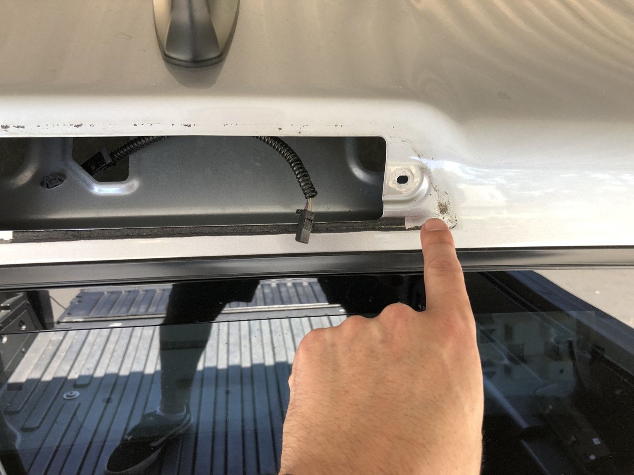

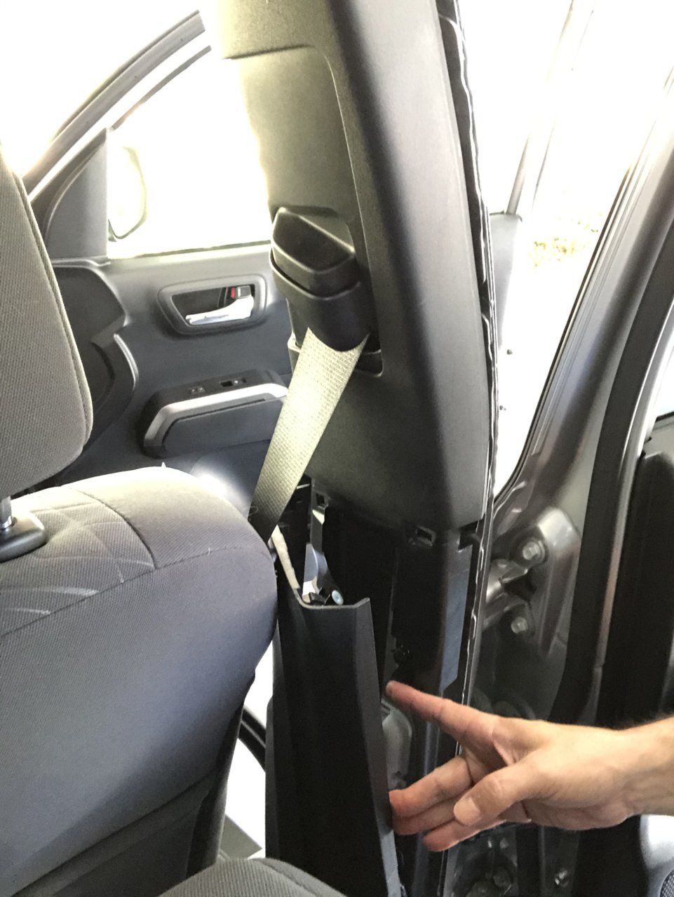

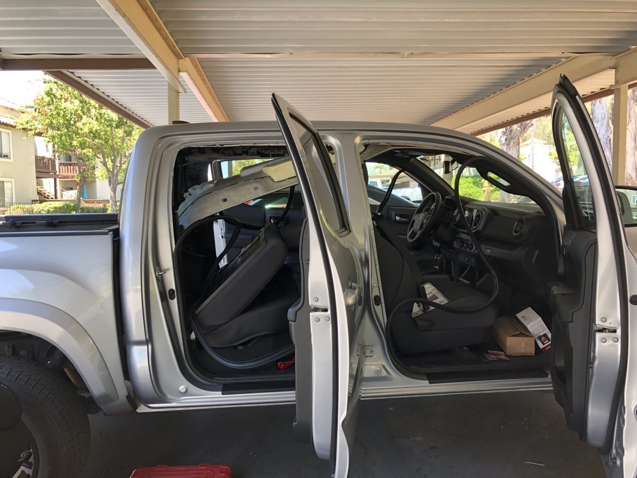

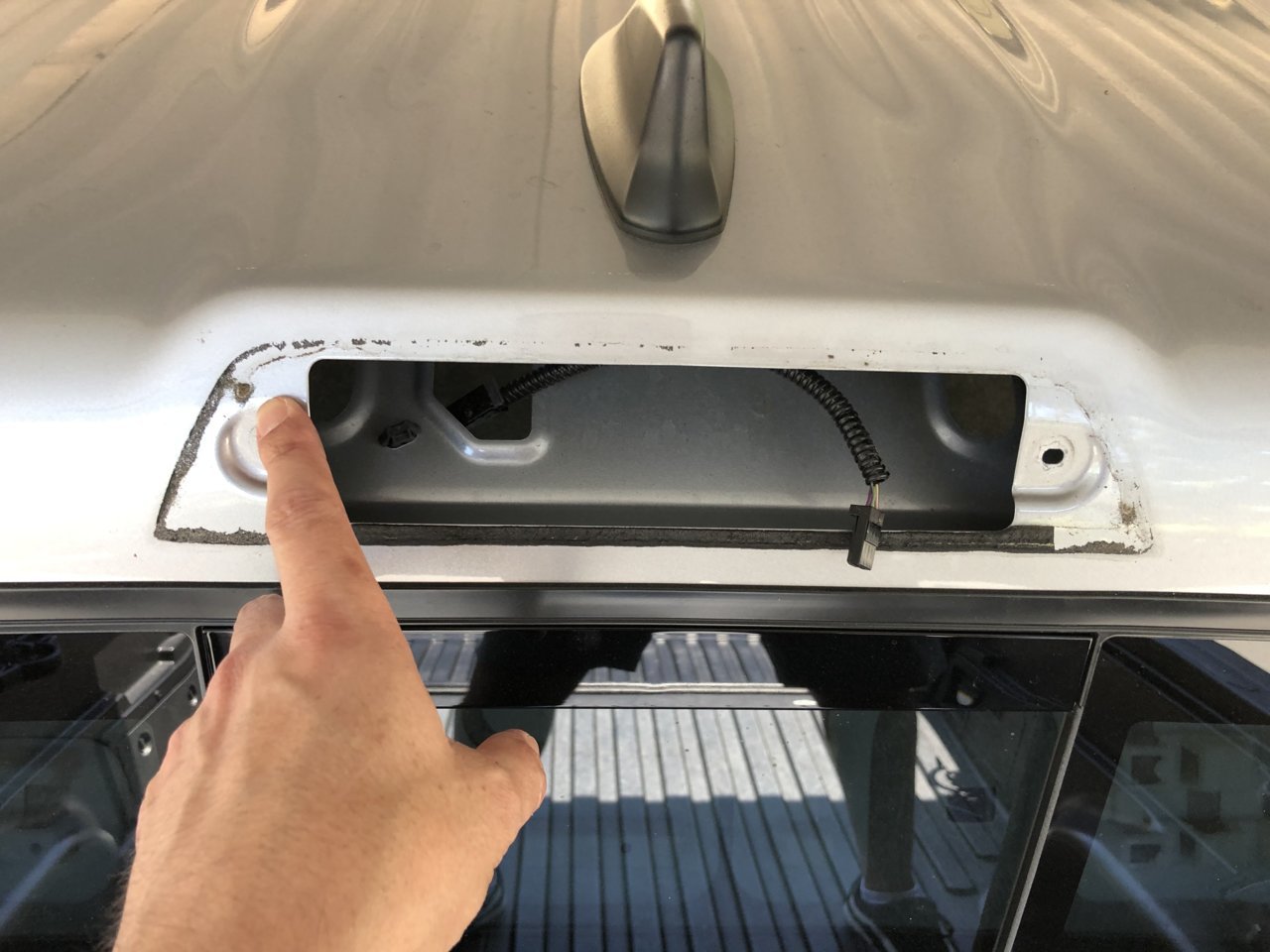

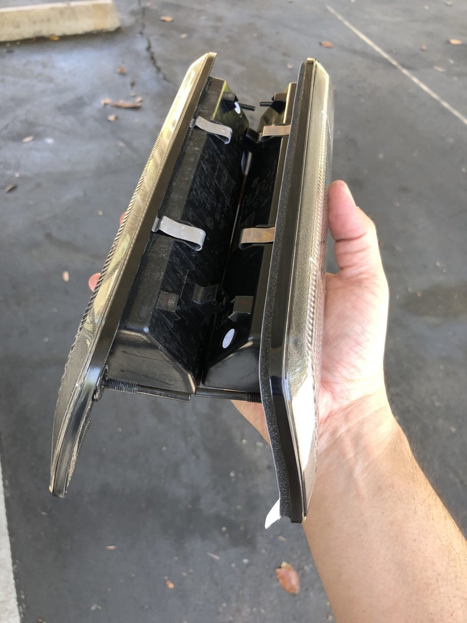

    @shakerhood it’s a thicker foam gasket. Original looks like it was just thick double sided tape. Barely holding on up top, leaking in two places. I’m pointing at the two places it’s leaking below and have posted pics of the old (left) and new light (right)
    for those doing this, there are two 10mm bolts holding on the b and c pillars. Behind the SRS Plate on the c pillar and under the lower b pillar on the b. Rest just pulls off. The lower b and c pillars pull out to release them from the upper pieces.
    the dome light does not just pull out. Pull the cover and there are two push tabs you push toward the middle to release it.
    lastly, if you don’t pull all pillars, the headliner will bend a little middle of the front door. Crease goes away when you put it back and it looks like this is how the dealer does it because it was already creased from when the dealer dropped the rear last week
    Also, grab some of the white panel clips. Not necessary as there are plenty, but I dropped two and no way to get them without doing more pulling. Panel still sits nice and tight.
    oh, and have fun with it ;).

    they physically stop (you will feel what I mean). I just used a 1/4 inch wrench and went to snug — hand tight on both sides, then snug them up (I hold it up near the head so I use as little torque as possible) and recheck just to be sure (mine did not turn any more at this point)

    B pillars just drop (one 10mm bolt and clips). Don’t remove the seatbelt, just need to get that plastic out of the way
    dome light just pulls down. It is a bit of a pain to get under it
    acsarm[QUOTED] likes this.

    I removed it . It’s a pain, but I did. You yank the cover first. Then there are two clips and the housing drops.
    HUGE pain for a light.
    crease will go away when you put everything back. Mine did
