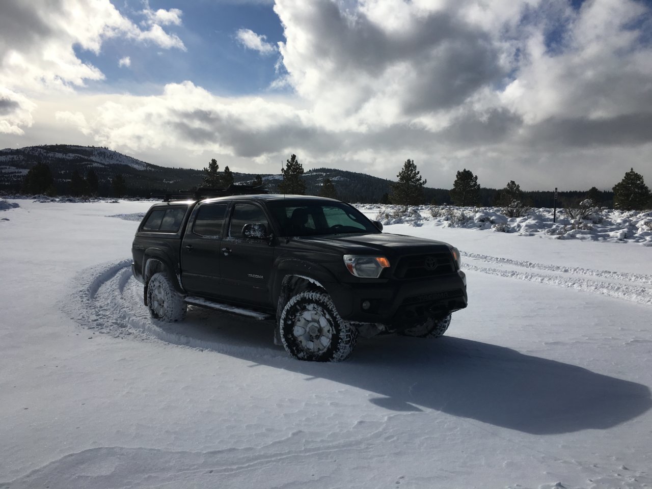

    Snow hasn't been an issue for me.
    If you're that concerned I suggest running some real snow tires and not all seasons.
    I also tow a boat (2,000lbs) and a travel trailer (4,500lbs dry) and haven't missed the swaybar at all.
