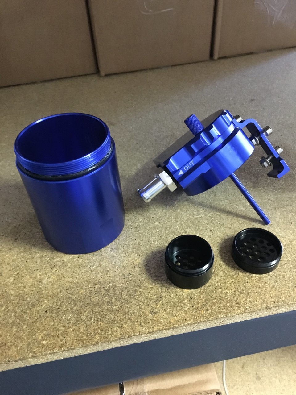

    Regardless of what the vendor calls it, this setup appears to be an oil catch can, not an oil separator can. They both do the same thing - remove oil from blow-by/recirculating gases. The difference being that in an oil catch can, the ‘caught’ oil must be emptied manually. With an oil separator, the caught oil is returned to the engine’s oil supply. Not knowing how the JL system works, I could be off.
    https://www.maperformance.com/blogs/tech/the-purpose-and-benefits-of-an-air-oil-separator
    Oil separators do come installed in some models - some Subaru turbos, some BMWs, most Porsches, Austin Healeys had them, Ford Performance has oil separator kits for certain performance engines. And there are several others. I wouldn't be surprised if most high end performance cars have them.
    They come highly recommended for turbo-charged and direct injection engines.
    I have had a Saikou Michi catch can in my 2nd gen for about six years now. If not originally installed by the manufacturer, they are not smog legal in California. However, most techs don't know to look for them. My truck has passed smog twice with the can installed, in plain view. I am simply too lazy to remove it for smog checks, which are required once every two years in CA (after five years when purchased new).
