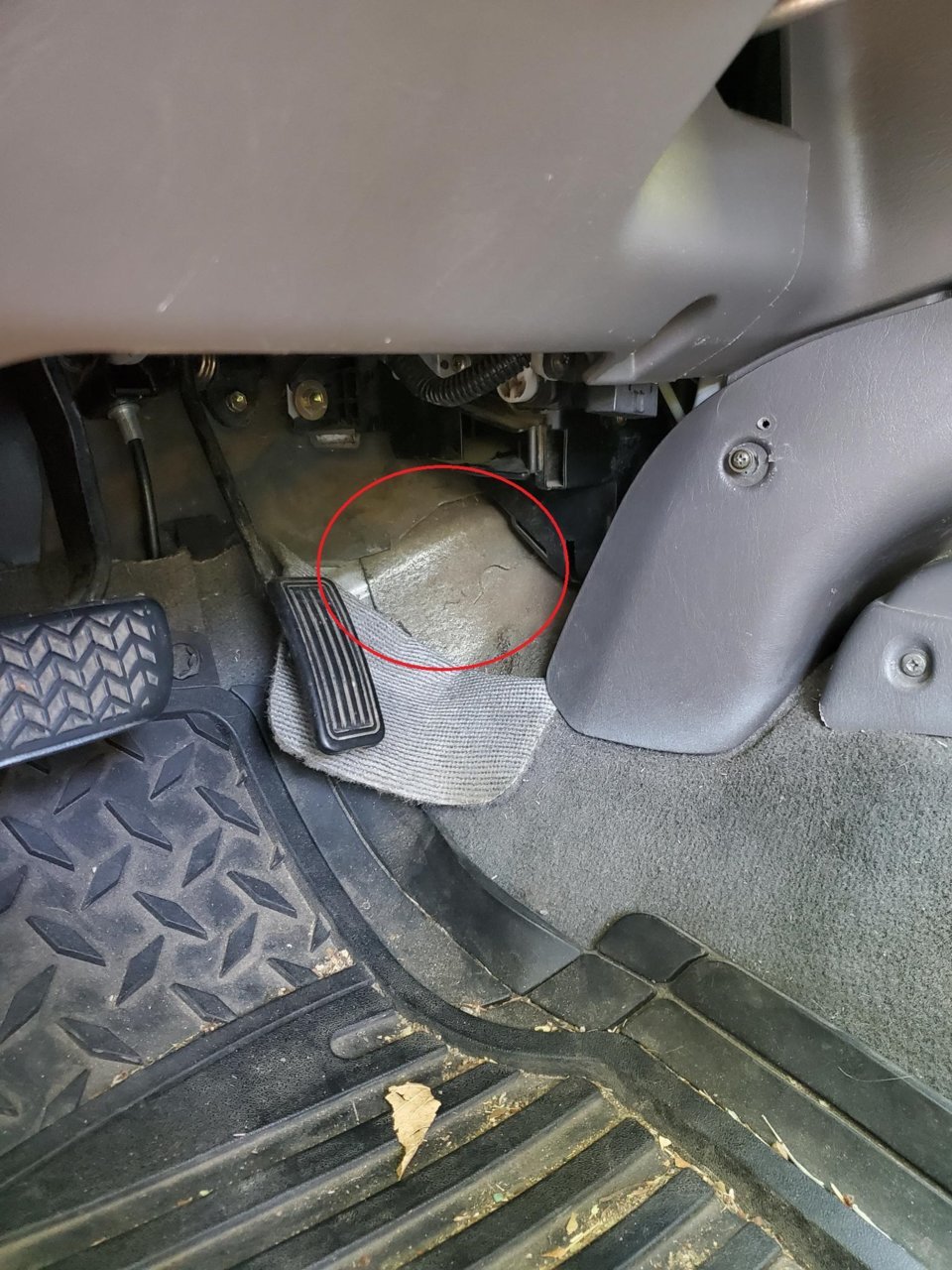

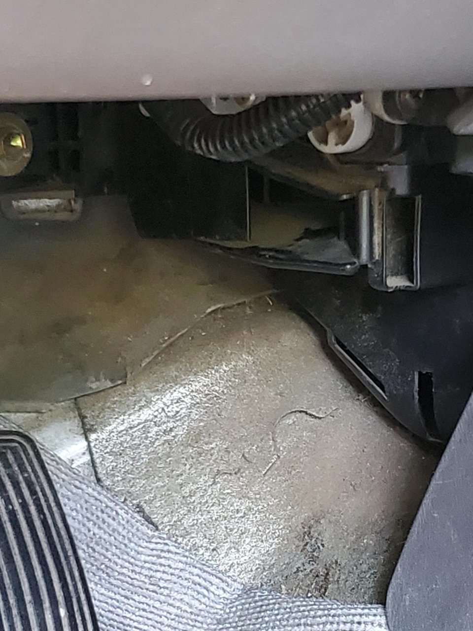

    Alright, update post: I was on the verge of giving up when I finally pulled up some carpet managed to isolate the rattle to a metal plate under the center console, seemingly where there is a seam or overlap. Pics attached. I can feel the rattle when i touch it and it changes pitch when i push hard on it. Unfortunately I have no idea how to stop it or mess with this. Any ideas? Thanks so much for the help so far everyone!

    haha i was considering it but I actually think I just found the problem which is on the other side of the plate under the hood. The bracket for what looks like the throttle control cable? (not sure what it's called) had no screws in it and was just rattling around on the cable hitting the plate. really sounded like a plastic inside the cab rattle lol. Now i just need to find the bolt size for that bracket.
