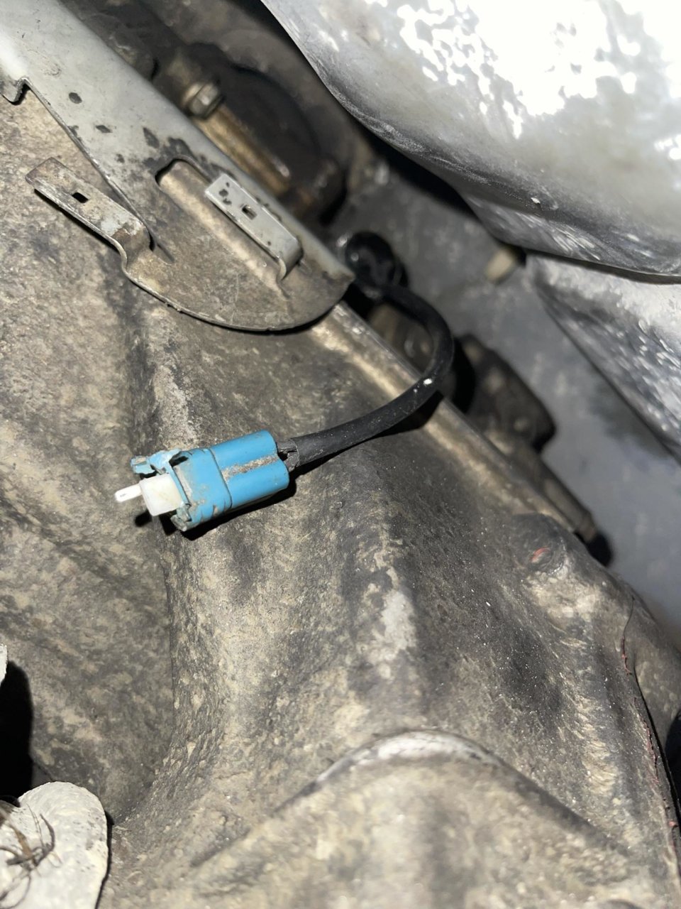

    Ok, so this may or may not even be relevant to the issue but I want to be sure we're talking about the same thing.
    You mentioned that "When shifted to 4wd the 4wd position switch 84222-35090 located on top of Tcase DRIVERS side sends signal to Transmission Control Relay Module 89531-35050 located under passenger kick plate. "
    HOWEVER.
    the plug that was broken on drivers side and that I hardwired was not part number 84222-35090. I know this because I bought that part and the plug ends are not the same. My only assumption is that it is part number: 84222-35110 ( I am saying this because it has a blue connector plug not the grey found on part number 8422-35090)
    The switch on the passenger side part number seems to be the same, because it also has a blue plug end, not the grey found on 84222-35090.
    So, at this point I am unsure if my problem still lies in the driver side switch. My only guess is yes, but how I am not sure. The wires from the engine harness are soldered directly into the driver side switch. So maybe the head of the switch itself is bad (the part that is threading into the T-case). I do not know, but these switches are extremely basic, and failure on these switches seems like it can't really happen other than the electrical side.
    Not sure what to do at this point, I guess the only thing left before taking it somewhere is to buy an ADD and see if that fixes it. Would a bad ADD still blink 4wd light or not light up at all?
    Any other thoughts???

    I hope you realize that there is a wiring harness connector that plugs into the blue connection shown in picturebiHV1nz.jpg
  10. Sep 4, 2021 at 1:18 PM
    #50
    bmwahba
    bmwahba [OP] Well-Known Member
    Apr 15, 2021
    #362760
    115
    i thought that was obvious... That was the start of this whole diagnosis. That plug had a broken end and wasn't connecting with the wiring harness properly. I chopped the two ends both wiring harness end and switch end to try to see if that was the issue but no fix.
    You mentioned previously in the thread that the wiring harness connector plug could be chopped along with this plug and wired together, that the plugs were there just for serviceability. I did that and now the rear locker is not working.
    So now I need to re-attach the two plug ends, both on the wiring harness side as well as the new switch plug so I can make that connection again and not have it hard-wired. Currently, I have no plugs in this connection. Engine harness is wired directly into switch pigtail. Is that clear ? I feel like there's a lot of miscommunications as it's harder to describe these things with words sometimes.
    Then once that's back in order I need to move onto the ADD...

    I may have switched the wires. Oh no :(
    There are two black wires coming off the switch side pigtail. Both black, no difference, but one likely sends signal through and one sends signal back.
    On the engine harness plug side (the side that was not broken) there is a white wire, and a white with black stripe wire.
    I'm going to reverse them and use the chopped off plug to see which wire goes where. I hope I did not cause more damage doing this and shorted it. I had a feeling I shouldn't have hard wired these...I am always for keeping things OEM but I just wanted to figure out what was going on.
  13. Sep 4, 2021 at 6:16 PM

    Alright, update time people!
    I popped the ADD off this morning and cracked it open.
    The worm gear on the motor had some rust, so I opened the motor side up and found that the brushes were not conacting the motor to engage it. I'm not sure what it was but the brushes had a lot of resistance in their slots. I sanded the brushes down to get them to not have as much resistance and popped the springs back in and they were not seized, allowing the spring to get them to contact the motor. Then I cleaned the whole thing like shown in the video above, popped it back in, and what do you know 4wd works! But...there's more...
    the story doesn't end there. Because I started this thread stating explicitly that my rear locker works. Well now it does not.
    The only thing that has changed was hard-wiring the driver side 4wd position switch.
    I am thinking what may have gone wrong was when I was doing the splicing of the 4wd position wires.
    There are two wires coming from the engine harness. One white, and one white with a black tracer. On the switch, both wires are black however.
    What I may have done was wire the two wires from the engine harness to the wrong side of the switch wires, and maybe that is why it's not sending the signal to the rear locker anymore. I am going to go ahead and order a whole switch, part number 84222-35110 and try AGAIN to get an 02 sensor socket on it maybe to pull it off, splice back on the factory engine harness plug, that way if the wires have a certain polarity, it only fits one way. In the meantime I can maybe cut my splice and try the reverse, but just wanted to post here before potentially making things worse again.
    At least 4wd works!!
    Thanks for the help so far guys, hopefully I can get this thing sorted 100%.
