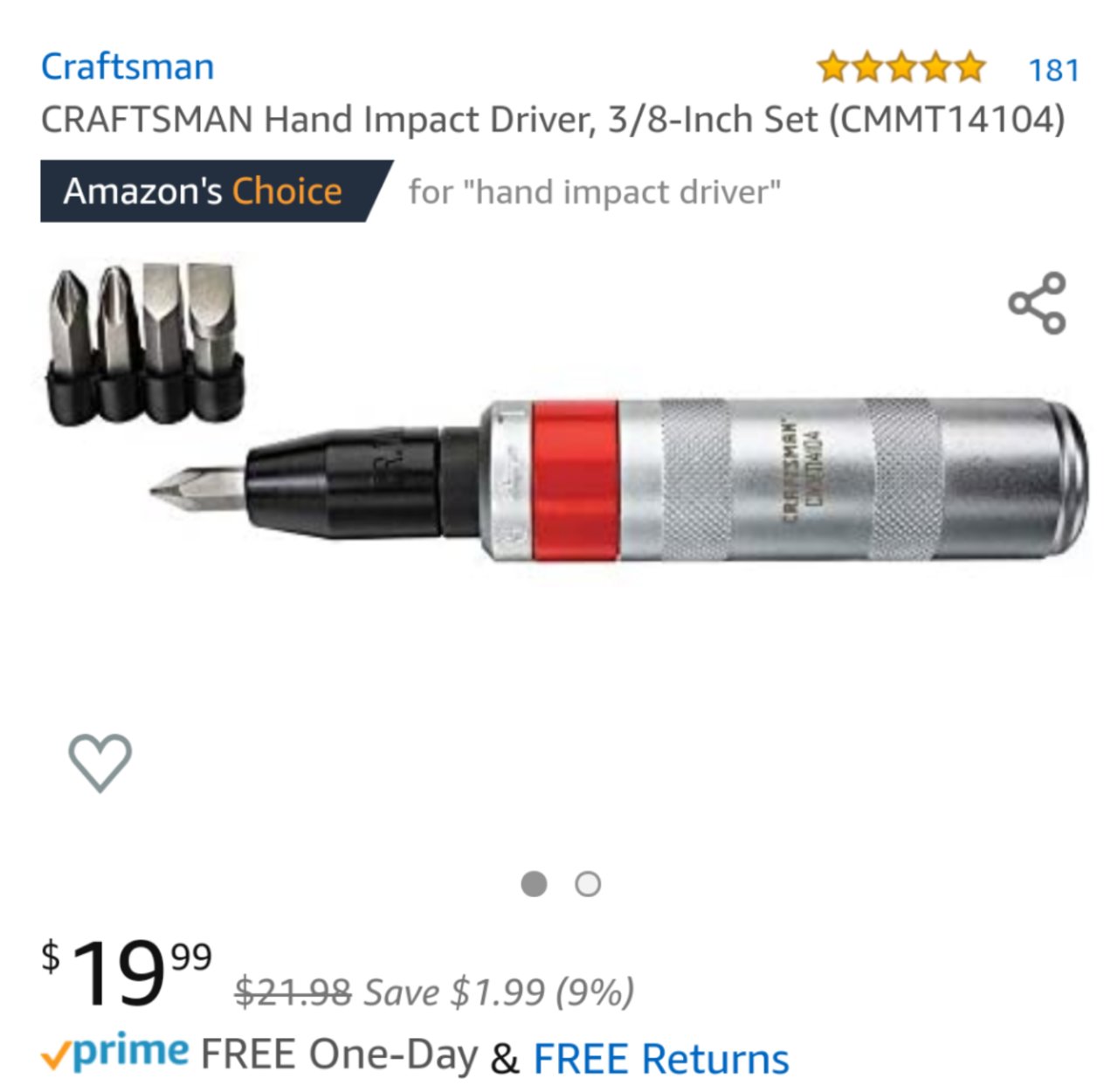

    I was also going to suggest using a grinder to cut a slit, then using a hand impact hammer to back out the bolt.
