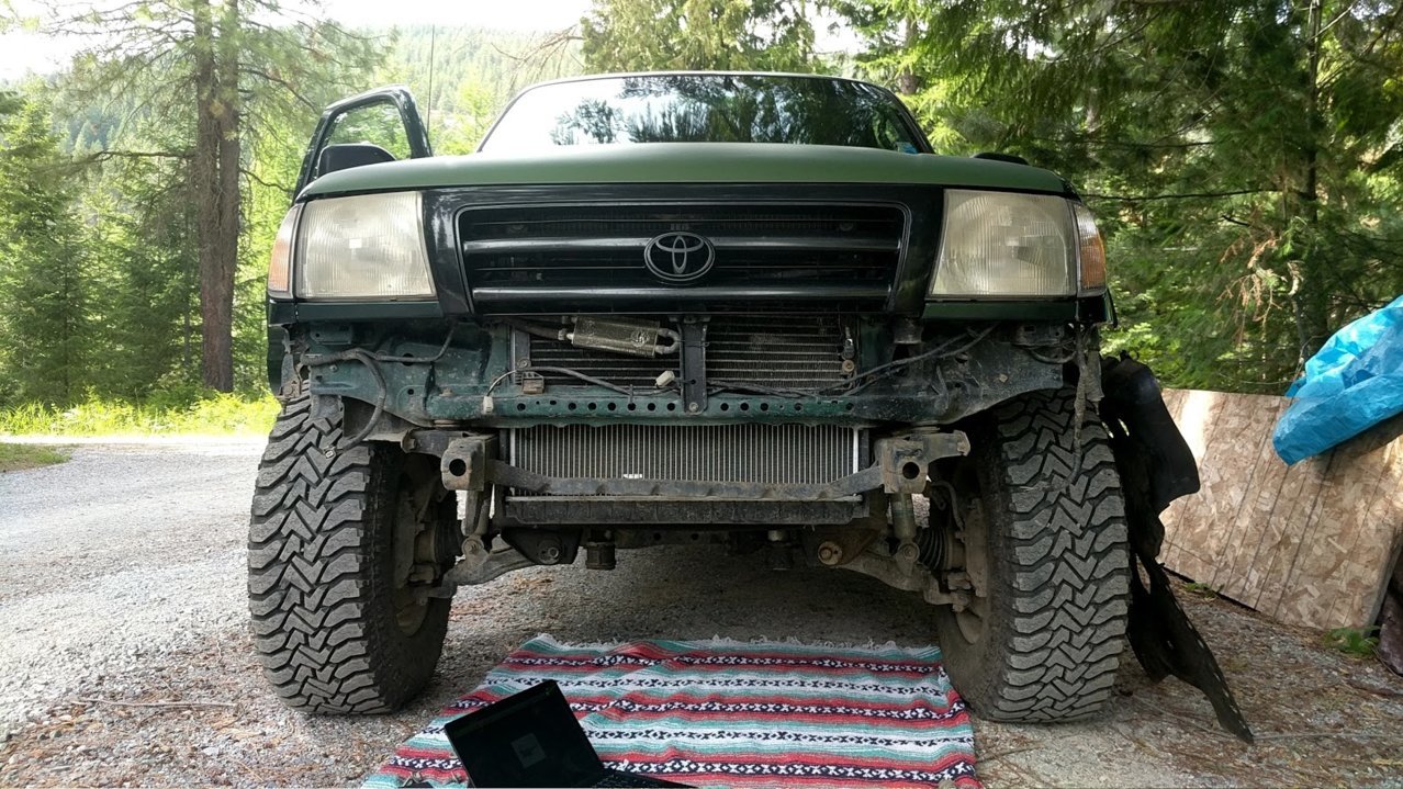

    Since I've been back I haven't done any mods but I took the front bumper off to start to design a custom one and I realized that the frame is bent at the front where I can see that there was a small collision on the drivers side corner (truck has a clean title so I'm guessing it was fixed by whoever crashed it diy style). I'm taking the truck to the local collision repair shop at the end of the week to see what they can do about it so I can build the bumper correctly. In addition, the truck will shift into 4wd but it doesn't actually engage and the light on the dash doesn't come on, I've been told vacuum seals in the transfer case might be toast but 3rd party confirmation would be great before I take it in to get fixed.

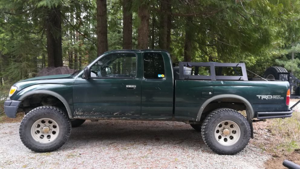

    Day after I bought the truck

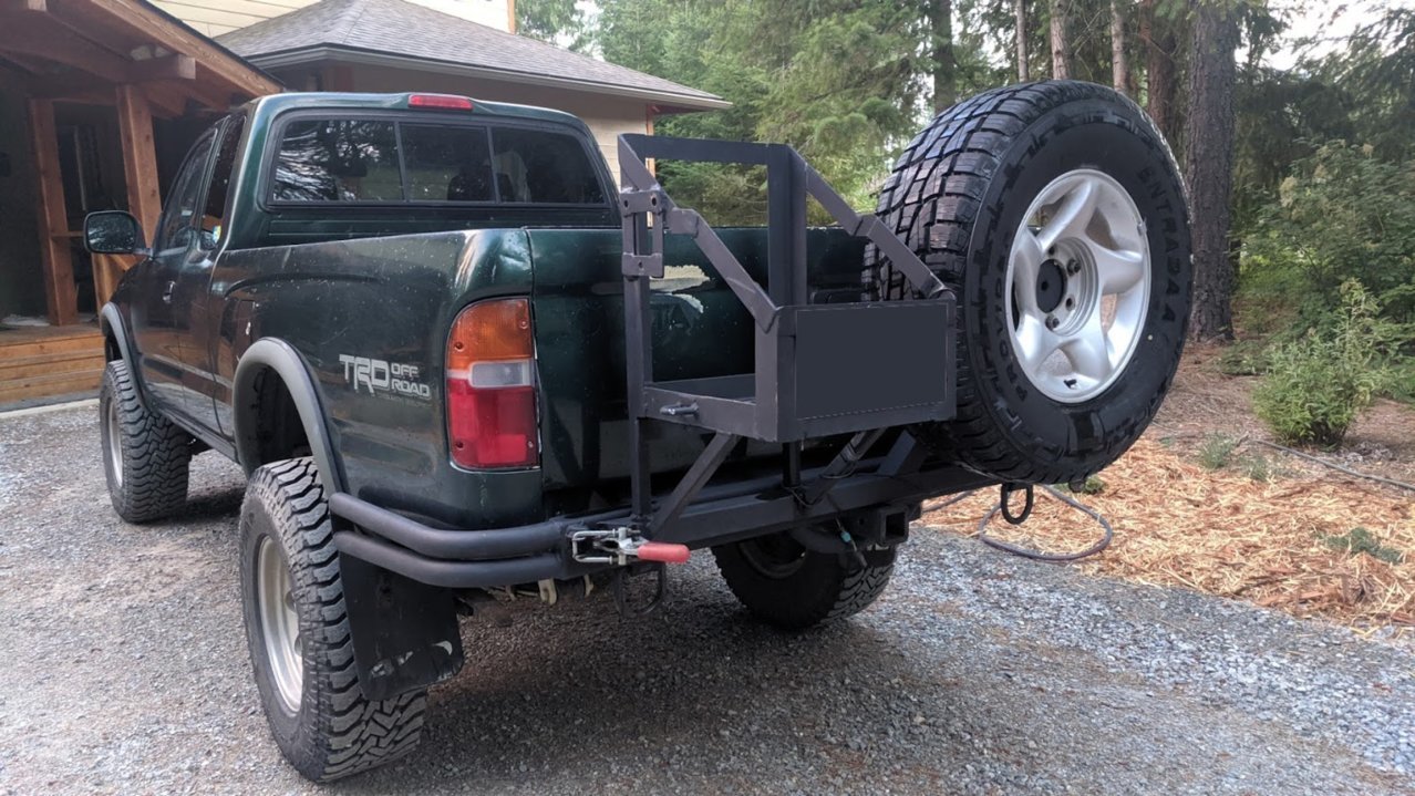

    Welcome fellow 98-00 1st genner. Have any more pictures of that rear bumper?

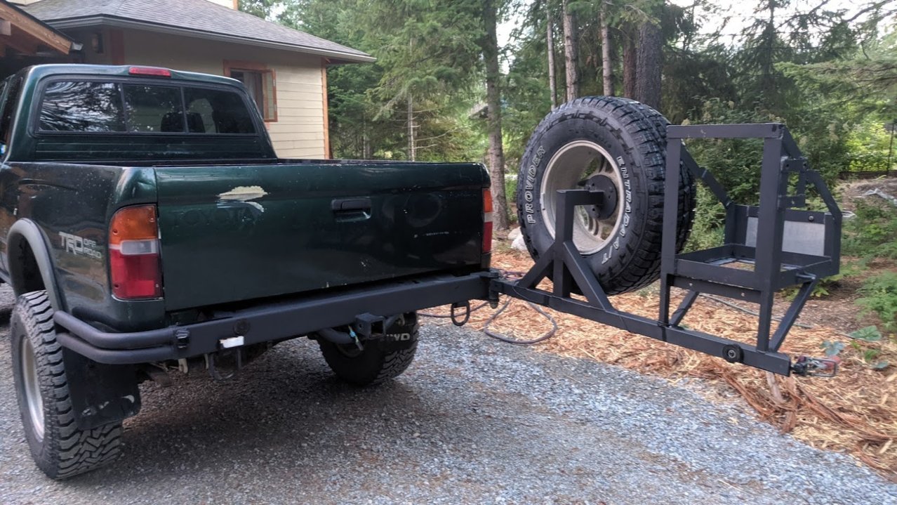

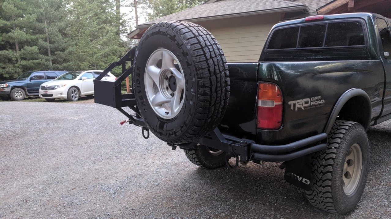

    Alright, the truck is clean now so here's some low light pics of the rear bumper. I don't have any jerry cans though, anyone know where to get some inexpensive ones?
    dxk1m15U8NBV8QWy-A9sVXN4YmoxHfNohMI1vTD__8ee270b2c43745ba66b3163ca6c2f6ac1a7abad9.jpg
    01fIvsAB7N31D3SHogMtOKqAKTXkHK-Au4yUpfyV_c91cb1a21738ead6a67c2402363f3750f3c6c0c6.jpg
    a8Kj209V1ES_xKWCDXurkJMdLUg-q5Ks6ZhCmfai_33536ea42a8557459773aa5d5f07ab8112301550.jpg
    4Aa1ArO03IXkiHuwAeZc_DKc9Ef2c4tV8T1bIU4q_a904fddc75acc3cf2657e987d83d57bc340b24c9.jpg

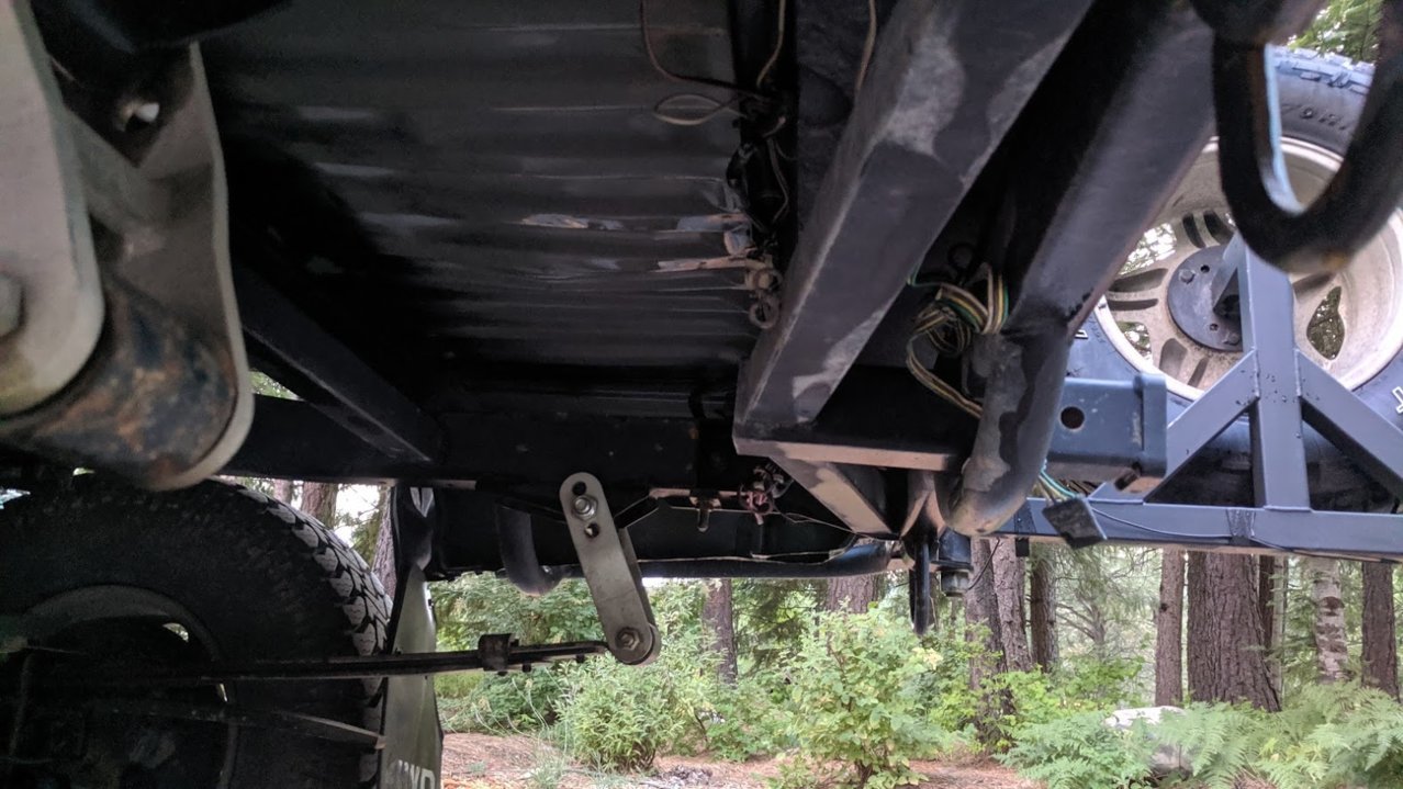

    Looks like those are stock springs with lift shackles in the back. When it comes time to upgrade or you realize you'll wanna carry more weight in the back you should think about a true leaf pack with stock length shackles... you get to keep the lift and increase your carrying capacity.
