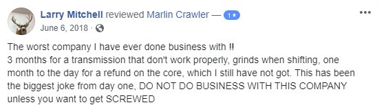

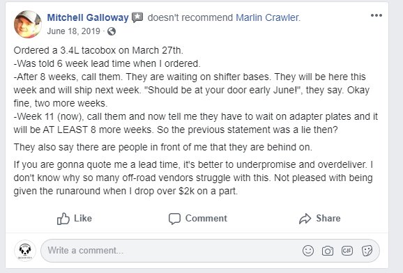

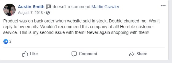

    Well Marlin Crawler is officially on the "I will never do business with them again" list. They have been an absolute disaster and quite frankly am glad I got out before they built my transmission. Their customer service is complete garbage and I wish I had read their Facebook Page before giving them $1,600.00.
    I would avoid this company at all costs. I've now got to source another location for an R150F transmission after waiting a month for nothing. - Check out all the 1 star reviews for bad gear issues and horrible customer service. Big yikes. Hopefully I can just get my money back and be done with this horrible company.
    Anybody got a lead on an R150F transmission in good working order? Or another place to source a reasonable replacement besides ebay or carpart?

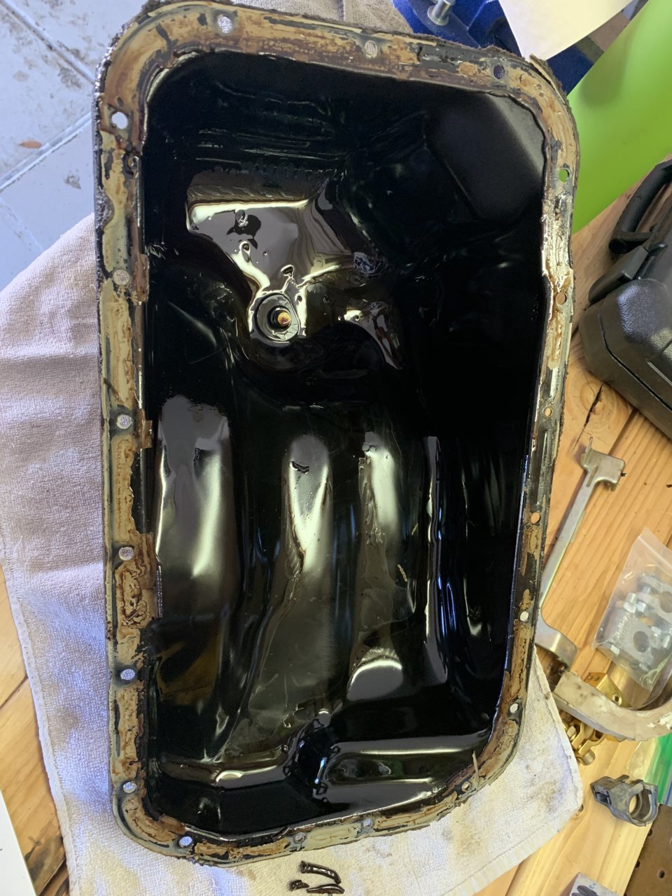

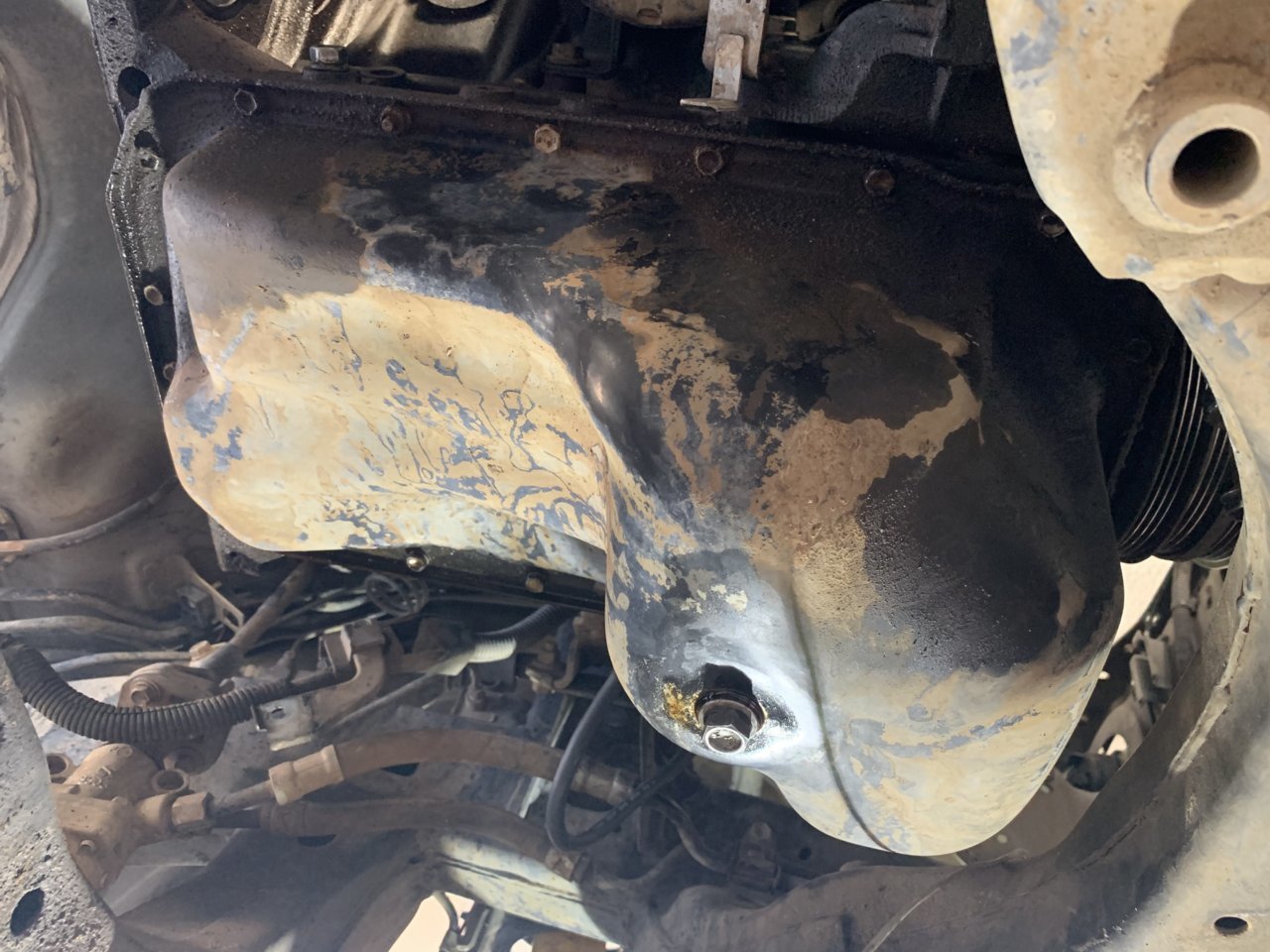

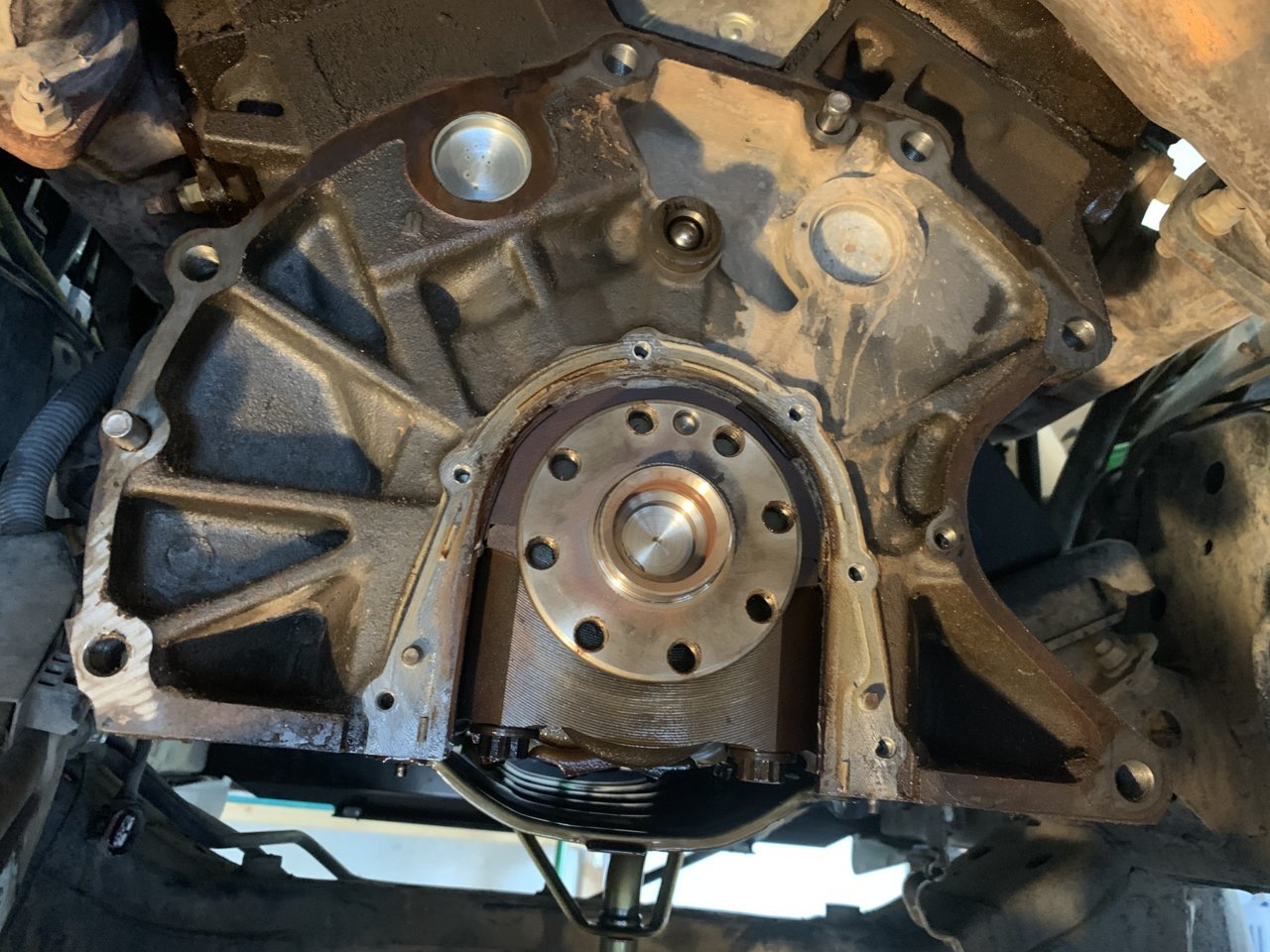

    Ok been a while since I provided an update. Lots has been getting done, but it is stinking hot outside in AZ right now 110 degrees as I write this post.
    Leaky oil pan before getting dropped and cleaned for like 3 fricken hours...
    Somehow didn't get any pics of the of the cleaning of the surface but it was icky:
    All fresh FIPG and cleaned all the hardware:

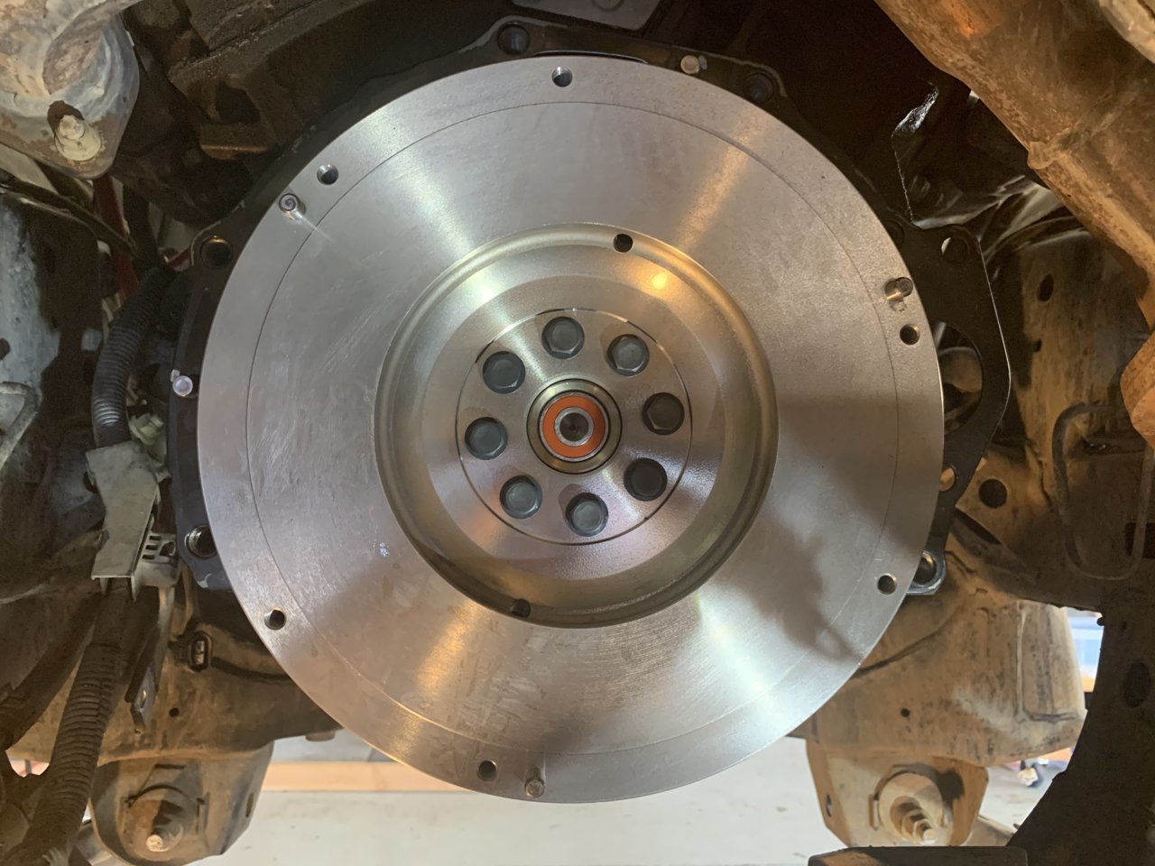

    Because I had to pull the pan anyway, I decided to just pull the little "gate" that holds the rear main seal. This was I could re-seal it also and it would make changing the RMS a lot easier. Here is gate removed, oil pan removed and engine backplate removed for cleaning.
    Here she is all cleaned up and re-sealed:
    Flywheel and pilot bearing installed: (yes the surface was cleaned before installing the clutch and PP)
    Clutch and PP installed and waiting for transmission:
    Heaps more in next post, battery stuffz, Timing job and valve cover gaskets :)

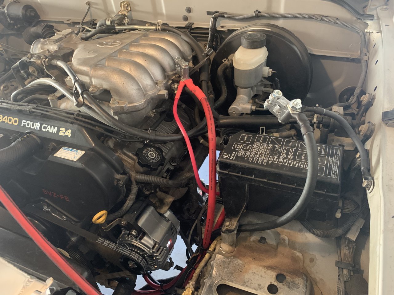

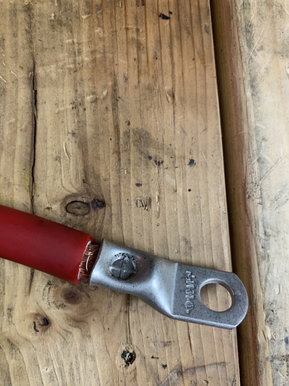

    The original battery cables on my truck were worn out and also on the small side. I decided while I had everything apart to upgrade the charging system as I will be adding a second battery, solar and DC-DC charger sometime in the nearish future.
    I replaced the starter to battery cable, battery to fuse block cable, fuse block to alt cable on the positive side. Replaced Neg to block cable and neg to body cable. Will be replacing the block to body connection at back of motor soon.
    Installed a 105 amp Denso alt that was direct fit other than post on bottom and needing to drill out bottom mounting hole on the alt itself.
    This required taking apart the loom, removing the bracket under the crank pulley and the plastic white cable holder that attaches to it. This was again the ideal time to do this as most of this was already apart for other projects.
    Cables were first clipped back, dipped and twisted in flux to pull the solder in and then crimped using a compression tool and my shop press. Then the lug was filled with solder after being heated with a torch. Once full of solder and cold, I applied liquid electric tape to cover the solder and wire above the lug. Once dry I applied heat shrink tubing (kind with glue in it) and heated with a electric heat gun till tight and glue ran out slightly.
    I personally believe this to be the strongest connection you can make for battery or other high current connections. I used tinned lugs also for additional corrosion resistance. Here are some action shots to provide some additional context,
    Completed cables and new 105 amp alt:

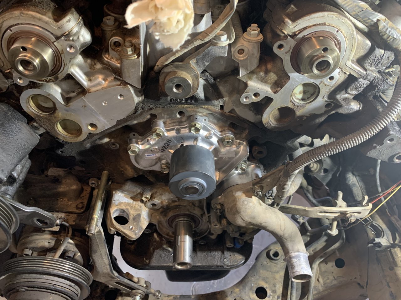

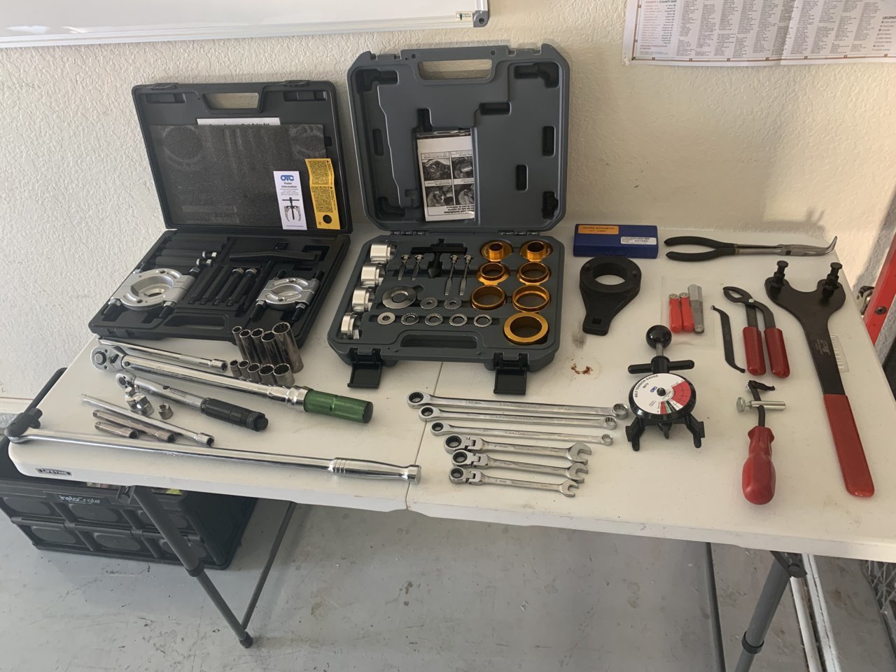

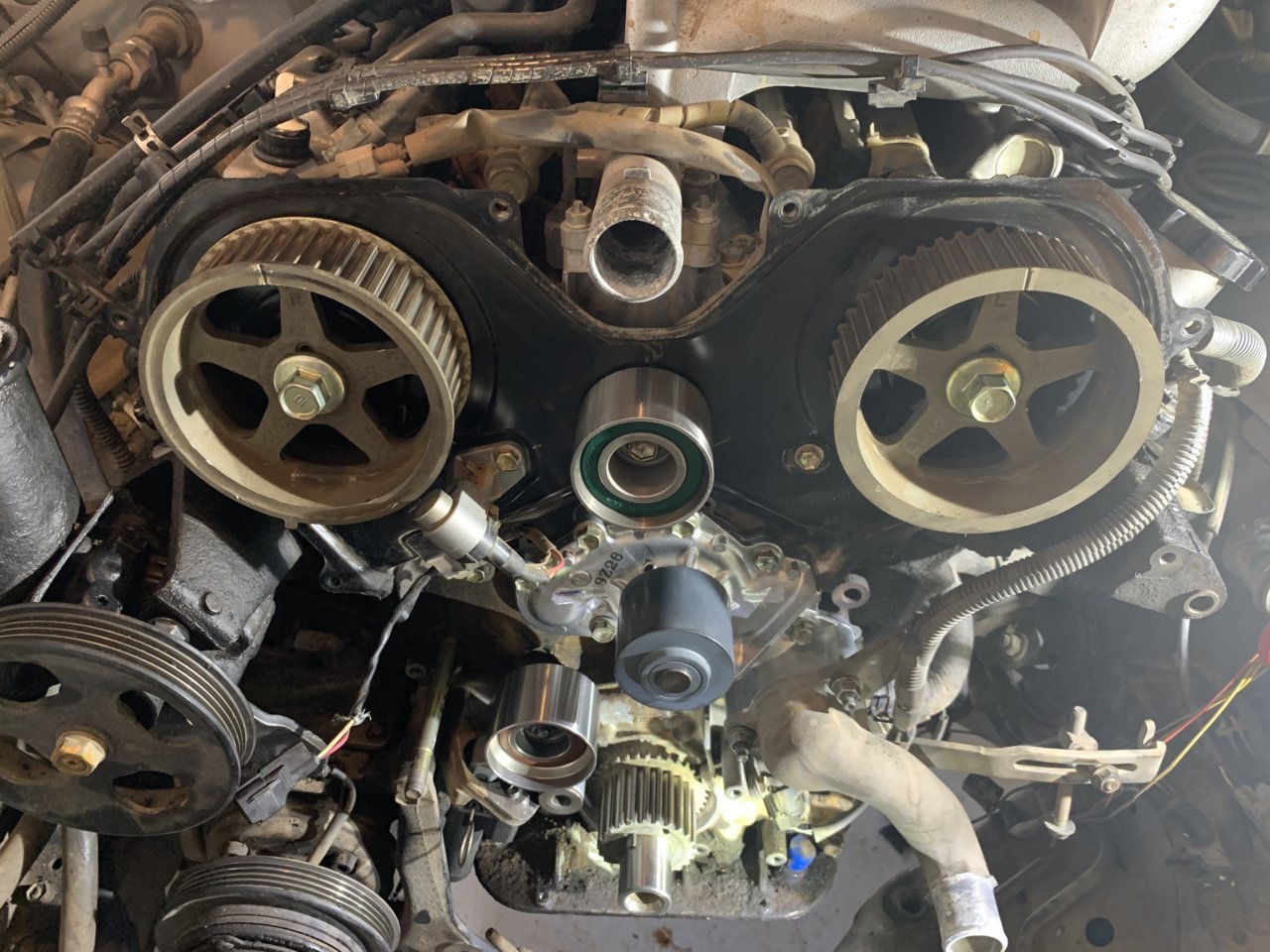

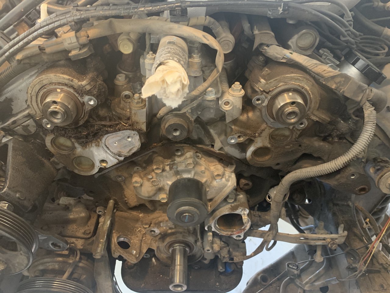

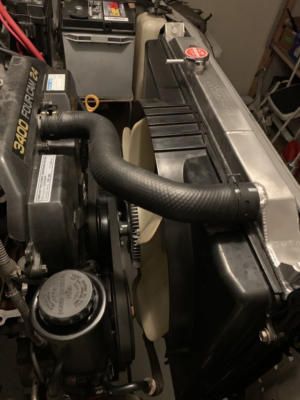

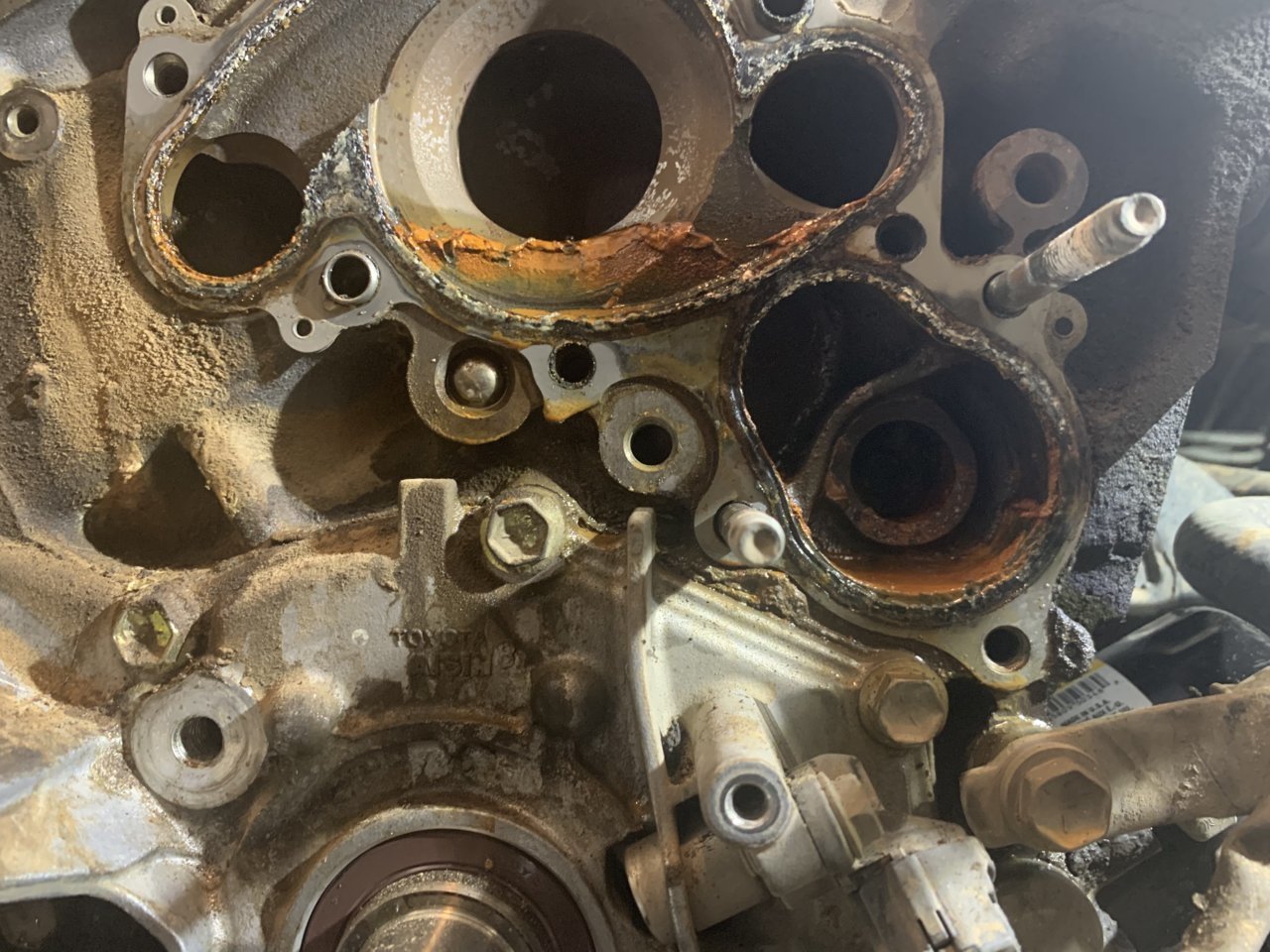

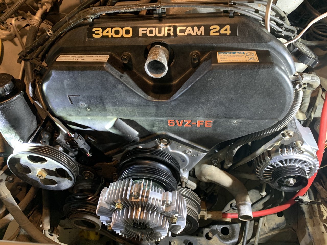

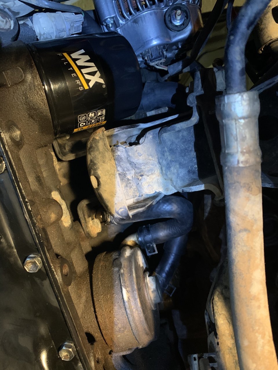

    Completed the timing belt job and all the bits included in that (cam seals, crank seal, water pump, thermostat, idle pulley, new tensioner & belts)
    In addition to that I replaced both radiator hoses with OEM, replaced all 4 constant tension clamps as mine were removed by PO, installed new Koyo radiator, HD/Towing fan clutch, fan clutch pulley, oil cooler hoses (2 on side of motor by filter) and will fill with Toyota red coolant once ready to start things back up.
    Things went smooth for the most part. I would say the hardest part for me was getting the new belt back on without rolling a cam or the crank. Second to that was cleaning the water pump mating surface as it was wrecked hard. Took my time with it though as with all these repairs and it came out great in the end.
    Parts set out for the job:
    Tools I used to complete the job:
    ^^ cleaned up and painted the motor designation in red cause I am accenting in red :)
    New side oil cooler hoses. Didn't want to have issues with these later, especially as they are a bitch to get at even with everything out lol.
    All buttoned up and the new radiator and hoses looking all sexy. Still waiting for my lower shroud from Toyota. Very pleased with how it came out. Radiator fit in perfectly and looks really nice!
    Something else small I did in this whole replacing gaskets and rubber adventure was to replace the o-rings on the dipstick tube into oil pan and the top o-ring. Now it clicks in like it was new, kinda of awesome!
    Can see my new AGM Plat battery from wally world in the background. Should work out nicely with the charging system upgrades :)
