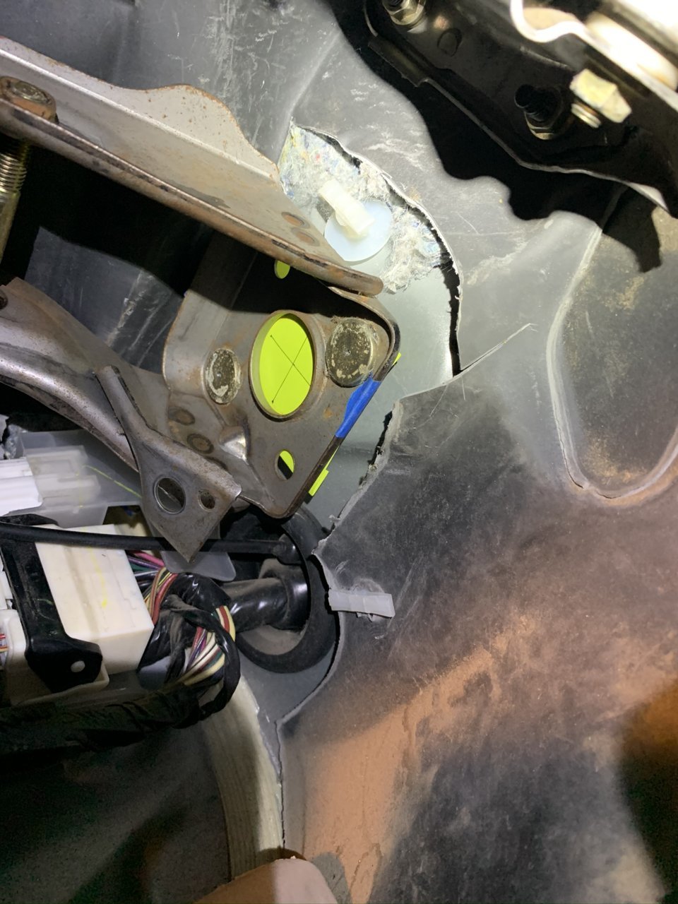

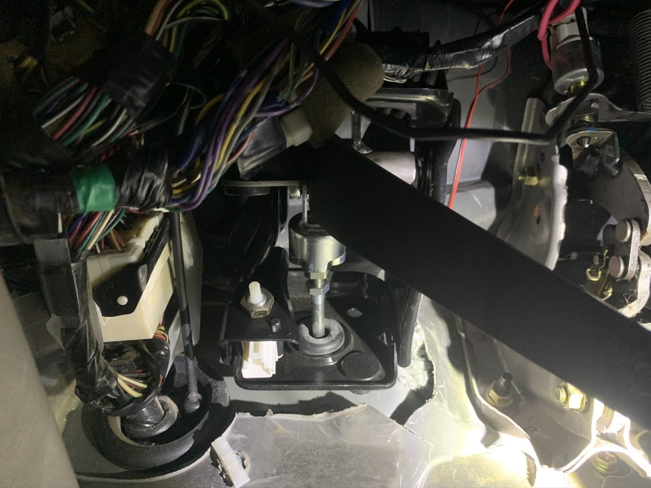

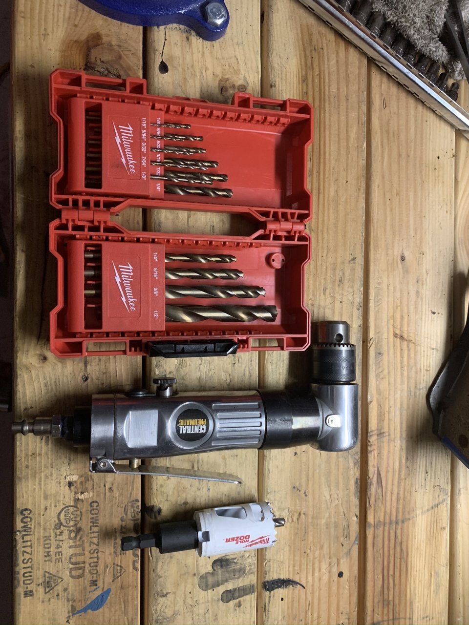

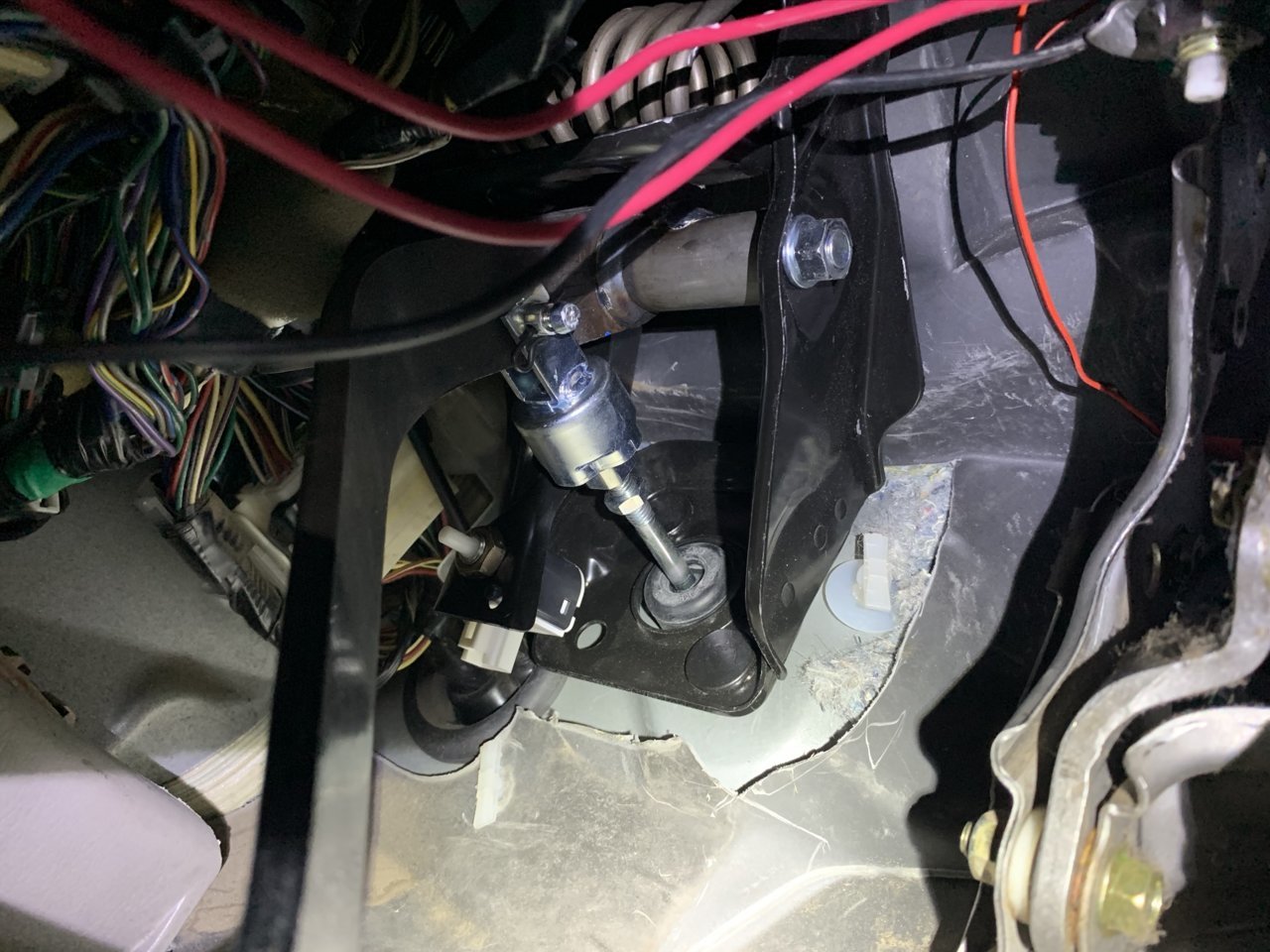

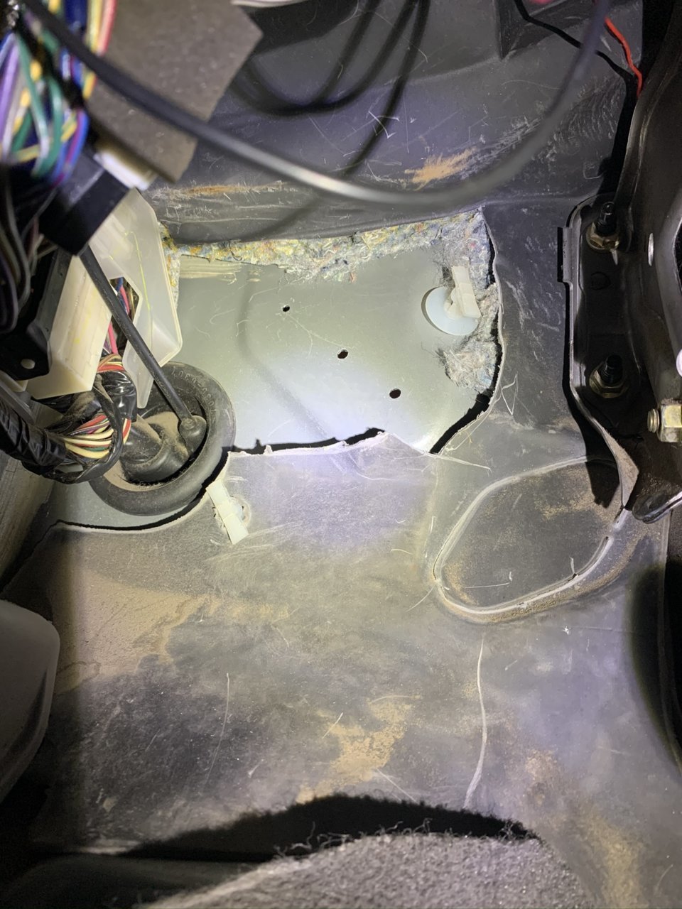

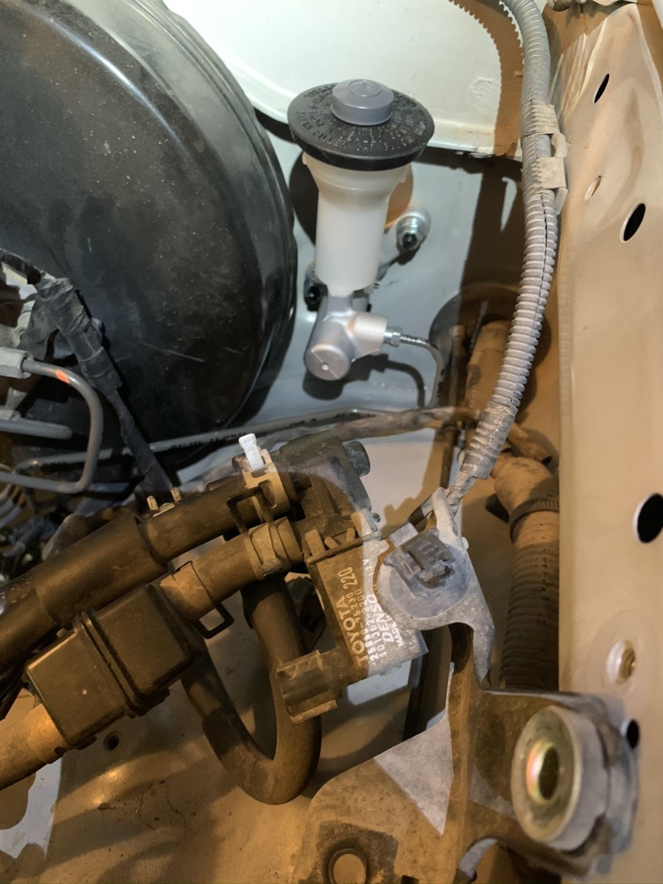

    Alright time for more updates! If any of you follow read the "What have you done to your Tacoma today" thread, you will have seen a few action shots. I apologize in advance, these posts are going to be quite detailed. I hope to add my small bit of knowledge to the vast collection of information out there and shed more light into area's I had difficulty gathering data on.
    So we will dive in with the clutch bracket, clutch master cylinder, hydraulic lines and clutch pedal. Will also touch on some information about swapping the brake pedal, as there are some things to be aware of.

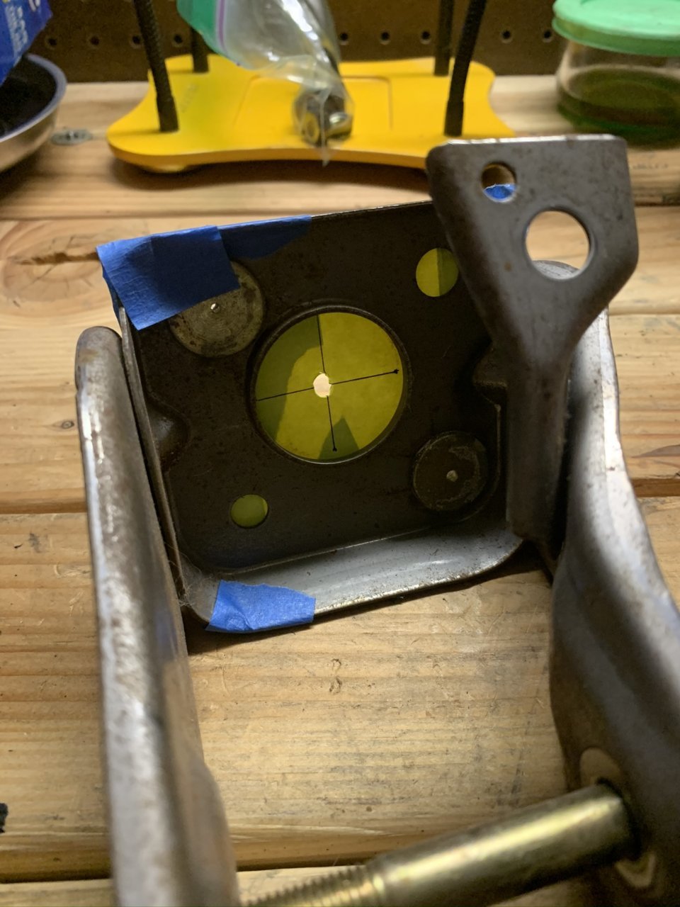

    Getting the under-the-dash clutch bracket (which has studs that go through the firewall to mount clutch master cyl) holes drilled correctly was a big concern of mine. Just hadn't come up with a way yet that I was sure would be dead on. This isn't one of those "oops I fucked up, so I'll just give it another go" deals as you really only get one shot to get it right. I'd recently been reading the build thread of this awesome custom 3rz crawler that swapped to a 5 speed and clearly the bloke new what he was doing from the build thread, so I shot him a PM to ask how he went about getting his lined up.
    @Kkrause09 mentioned taking the studs out of his bracket and mounting the bracket under the dash using the pre-drilled and tapped location under the dash. Then marked them with a marker and started a hole with a 1/8 drill bit from inside and then finished them from under the hood. He then plug welded his studs back into the mount and was good to go. So I took that idea and ran with it, made a couple changes to suit my options and went to work.
    I purchased a used broken bracket off E-bay (one of the studs was broken, perfect!) and sheared the bolts off using a cut off wheel on a grinder.
    Then went about finding the dead center of those studs and drilling a 1/8" hole in each. Measured and marked the center of the large center hole (for clutch MC) using a post it note and painters tape.
    Once the bracket was ready, installed it under the dash and made sure all was straight. Looked at several other pictures from thread on here to double check my work along the way. Custom taco's write up, safetydang's etc..
    Once I made sure I was happy with everything, I removed the bracket once more. Filled the area on the firewall that would meet up with those holes I made with black electrical tape to provide a surface to indent. Put the bracket back in place and double checked everything again and used a penny nail to poke through each of those stud holes and make a mark on the tape. Did the same with the center of the big hole with the sticky note. Then removed the bracket again and used a center punch to start a indent in the firewall to ensure my bit didn't skip.
    I used an air drill due to the tight working space and because I had one sitting around. It's nothing special and they are very cheap at harbor freight (I use very occasionally). Started with 1/8" bit from under the dash and created the three pilot holes.
    Then from under the hood I started expanding the holes. Finished at 3/8" for the studs and 1-1/4" for the center MC push rod hole.
    Above is the holes completed right before the first test fit. Boy was I anxious to get it stuffed in there and make sure I got it right! Below the clutch master cylinder is all mounted up. :)

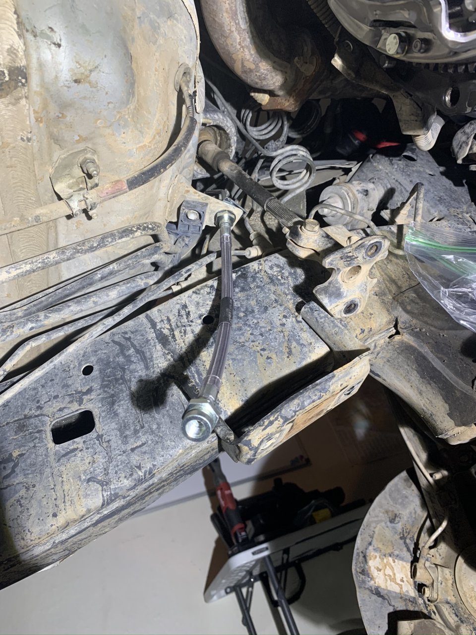

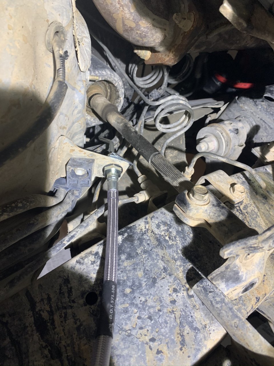

    As you can see in the picture above, I was also very excited to make sure the hard line down to the slave cylinder lined up correctly. I am happy to report that it lined up so perfectly if I hadn't done this myself I would say it was stock! Once I had it lined up on the correct path down the lower bracket (which is already there on a pre-runner FYI) it ended dead center of that bracket and hooking the Marlin SS flex hose was breeze with everything out of the way.
    But that is the end of the clutch hydraulics for now because the next step is to run the line for slave cyl, which I will do with the trans in place. So next was time to get rid of annoying automatic brake pedal that is now too big and sits way to close to my soon to be clutch pedal. This got a bit interesting because the original manual brake pedal I purchased on e-bay was from a 99' Tacoma. Turns out that they are different between some years because of the brake booster / master cylinder. The one I purchased had a bigger support bolt, larger hole where pedal connects to MC (chain link looking deal) and was shaped differently. After some poking around it was easy to figure out that I needed one from around my year. Sourced another used one off e-bay from a 2003 and once it arrived it installed without issue. Here is a picture of the different pedals for reference:

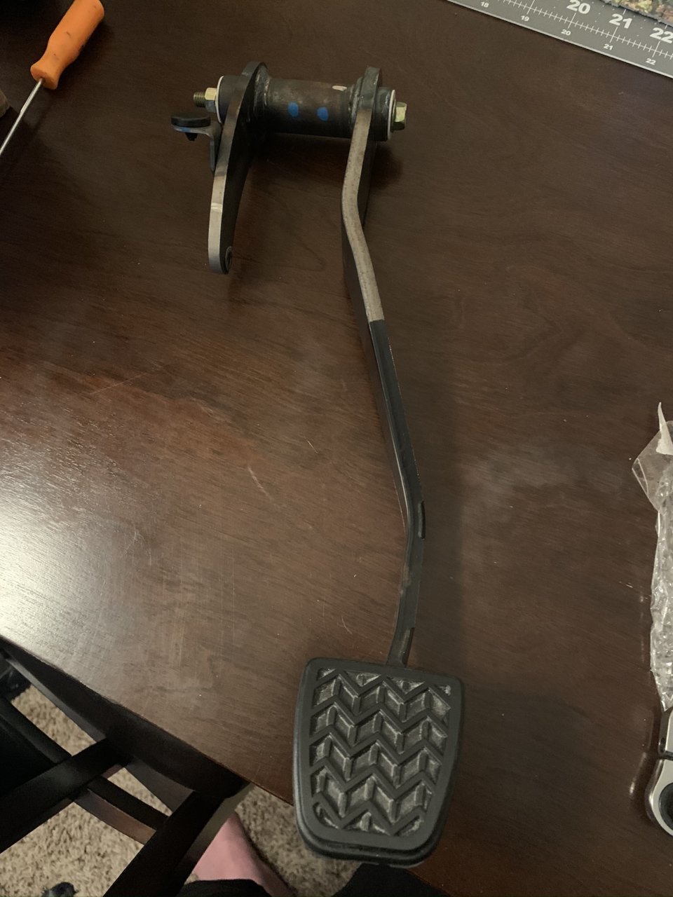

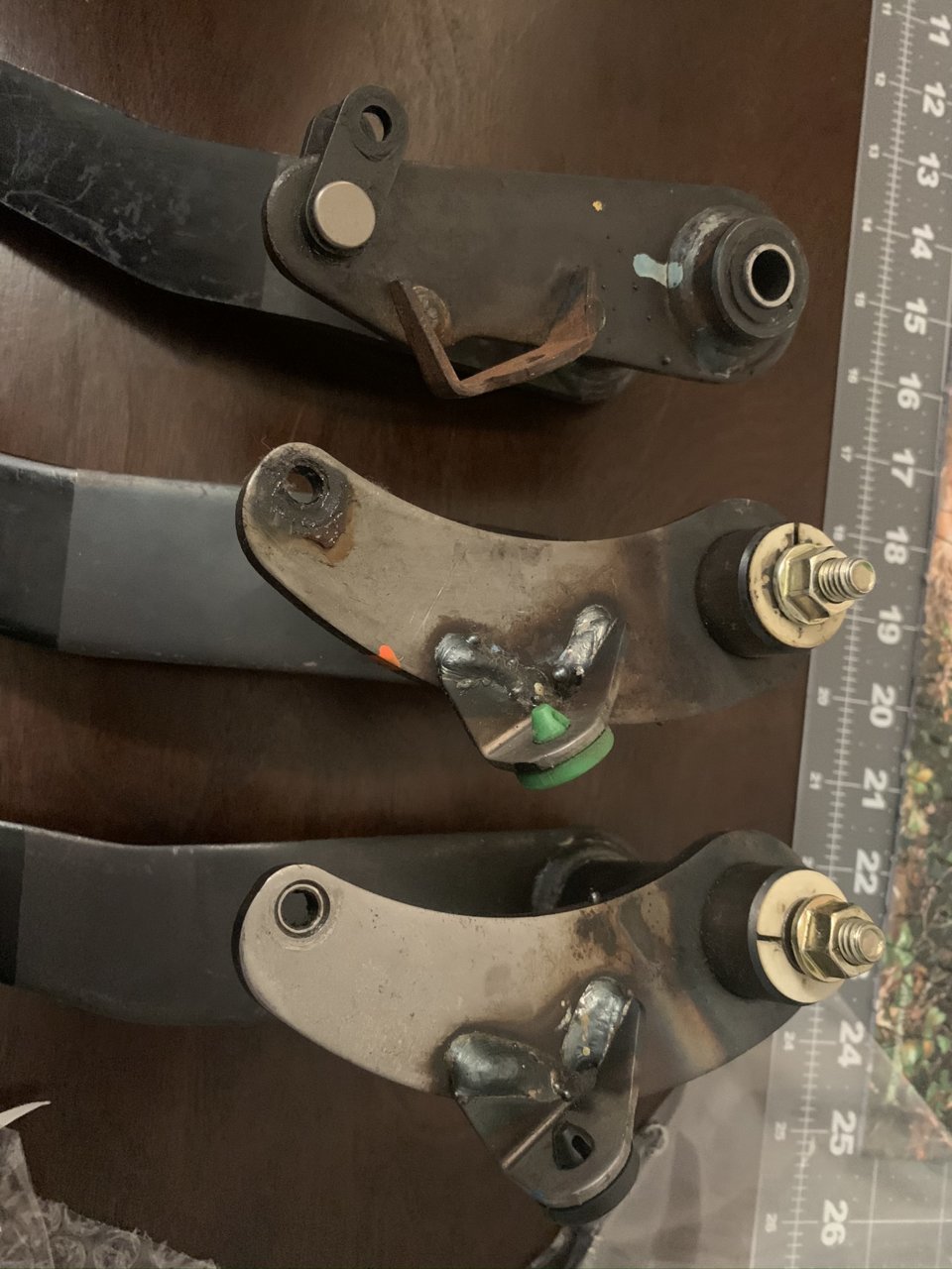

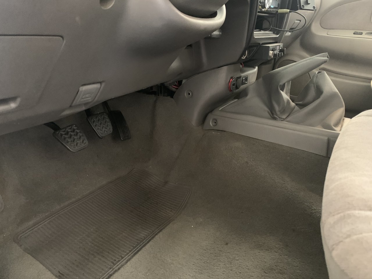

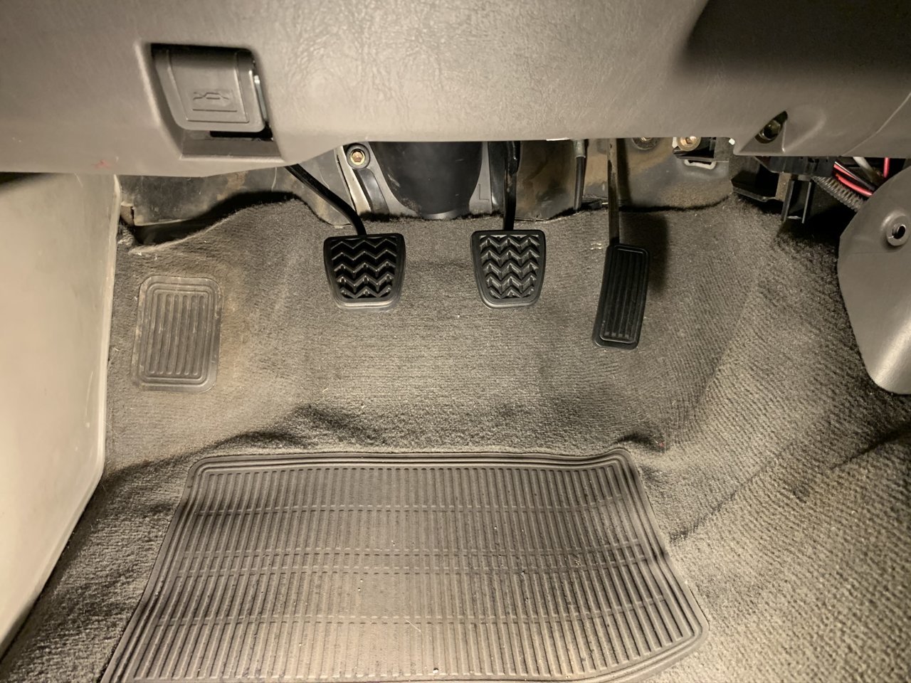

    Top is 99' Tacoma manual brake pedal, Middle is 03' auto brake pedal, bottom is 03 manual brake pedal. Notice how the top one doesn't have the same curve and you can see the hole for the bolt is much larger.
    Put new bushings, cushion and rubber pedal cover on the used brake pedal and lubed it up before installing:
    While I was waiting for the correct brake pedal to arrive I got the clutch pedal all connected and installed the two switches (haven't wired them yet). Here is a picture of the more or less fully installed clutch pedal assembly under the dash:
    Here is the 3 pedals all installed and connected.
    Center shifter portion mocked up to make sure everything is coming along as it should. Will have to stuff the transmission in first to be sure, but I think I have the transmission tunnel on the body trimmed out enough for the levers to come in with clearance.

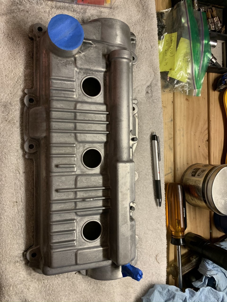

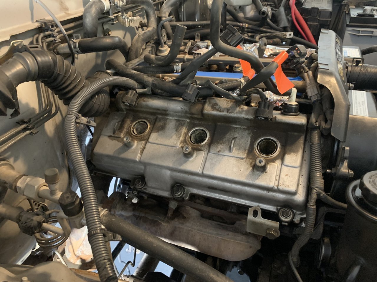

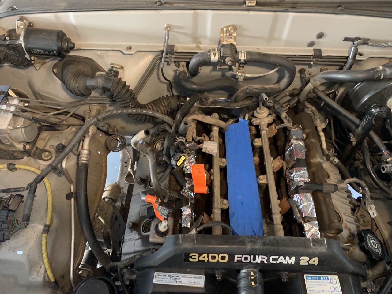

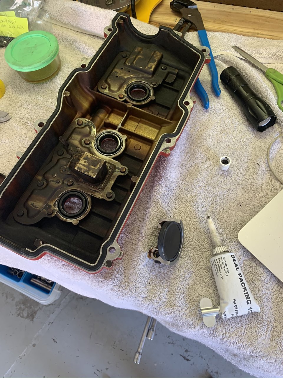

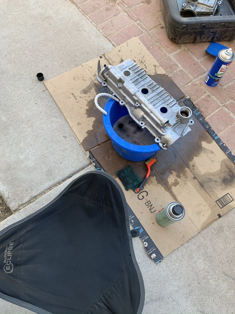

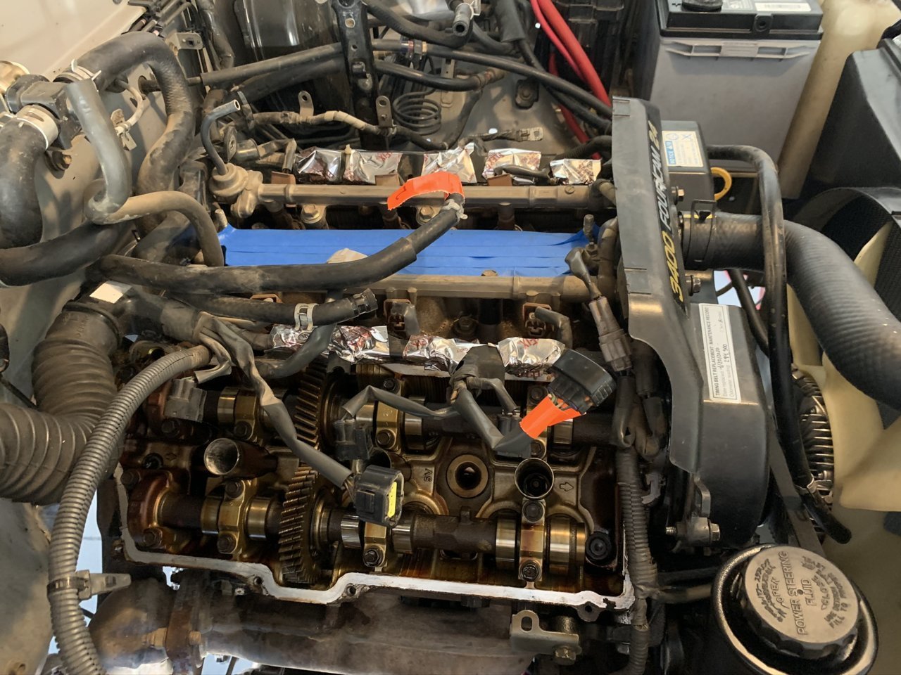

    Valve covers were leaking and had been for some time based on the amount of built up oil crud on the center support for the steering rack and back/sides of motor. So I had planned already to replace those, the spark plug tubes, cam plugs and half moons. I also wanted to adjust my valves while I had the covers off. So after completing the timing belt job and clutch disc job I replaced a lot of seal and hope to have no more oil leaks. I am accenting in red and my valve covers were in less than great shape and really filthy due to the aforementioned leaks so I cleaned them up and painted them red with rattle can engine enamel.
    I kind of cheesed out on adjusting the valves. I checked 4 of them (two of each) and they were all within spec and it was really hot and I was tired, so just decided to call it. Might revisit this in the future but we will see how she goes. I do have a little taco tick but it doesn't seem excessive compared to other 5VZ-FE engines.
    Gonna just drop some action shots here. This stuff has been documented into the ground at this point...
    I think I am gonna need a re-bore sooner rather than later. Probably will looking into sourcing a spare to as to avoid downtime. Got this all cleaned up and shiny, not sure why I don't have a pic of that lol...
    All buttoned back up (for now...)
    All went well on this job. Pretty straight forward honestly. My valve cover bolts were stupid loose I think some of them could have been turned by hand! So I am sure that didn't help the leaking situation. They are all tightened to FSM spec's with a torque wrench now. Will make a note on the maintenance log to check these in a few k's.

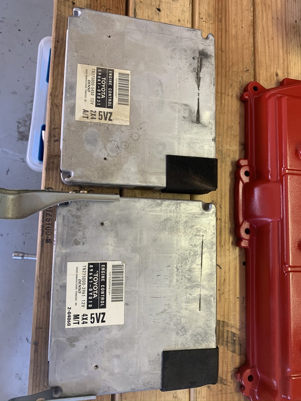

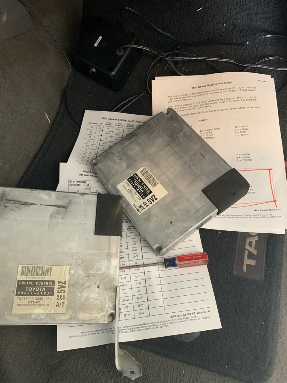

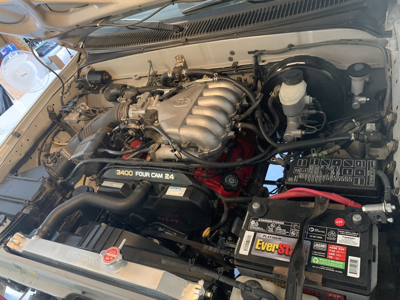

    So this might trigger some people but I have decided not to de-pin my ECU during the swap. Based on personal knowledge, research and crap I've found on the interwebs, I've decided to just plug and play. I am doing this for a few different reasons. Most importantly, I would like to put the issue to rest, once and for all. There is still speculation nearly 10 years later if this is possible or not and if it will damage the ECU or the truck wiring. I had originally planned to de-pin and had everything lined up to pull the trigger as you see below:
    Funny how similar that image is to @SafetyDang's write up photo. Timeless I guess lol. For anyone keeping track or wondering the guide on wiring is spot on. I checked the wire colors and they were all exactly what they should have been. So had I decided to actually de-pin or cut the wires, I had complete confidence that it would be right.
    So stay tuned I'll let you all know if I blow up my $400 ECU trying to prove it as being safe. Of course from a control standpoint I've no proof that the used ECU off E-bay is actually functional to begin with, if the worst is to happen. Either way, choice is made and the dash is all put back together. Timmy has a great video on swapping these so I didn't bother to document it.

    Quick question: I thought you could just buy an ECU from the same year, same engine, 4x4 (in my case) but with the 5MT transmission, then just plug and play with no issue. Correct?
  12. Jun 11, 2020 at 7:27 AM
    #72
    osterhagen
    osterhagen [OP] Well-Known Member
    Aug 6, 2019
    #301384
    579
    Rafe
    Glendale, AZ
    2003 DC v6, MTM, 4x4
    "Totally Stock"
    That's what we are gonna find out. Previous to this, everyone has either cut or de-pinned some wires that are used for the auto trans that aren't for a manual. Think anything related to the electronically controlled transmission for example. I've personally not be able to locate any swap documented with a plug and pray, with follow up that it worked and continues to work.
    In theory, yes you can just do exactly as you've described and that is exactly as I've done. If you want to read about the initial work that went into this ecu swap, you can find it . Later in this discussion (a few years in fact) a Toyota master tech was asked about this and said that the harness is the same for both trucks and it shouldn't cause any issue. But safety had already cut his wires at this point so could no longer test.
    In my situation the only real unknown is if the ECU I purchased off of E-bay worked to begin with. So the problem is, if it DOESN'T work I won't be able to say 100% that what I did (just plug and pray) caused it to not work.
    But on the other hand, if it WORKS I can report that a direct plug doesn't cause any issues and hopefully put this to bed forever. As much as anyone is willing to stake a few hundred bucks on what some dude on the interweb said lol.

    My thoughts exactly. I’m sketched out about the ones on EBay but it’s a leap of faith you have to take.
    And I like “plug and pray” much better.

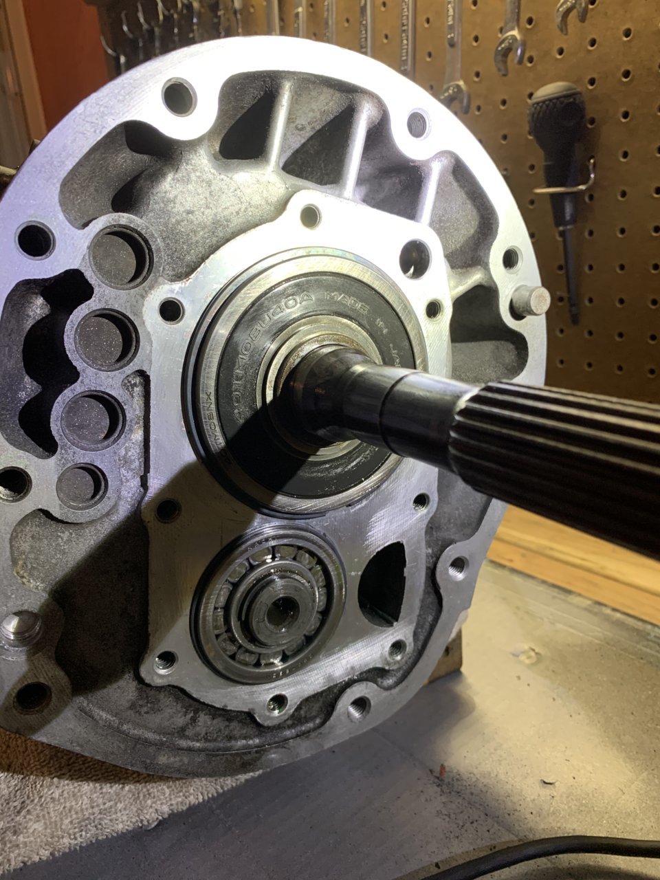

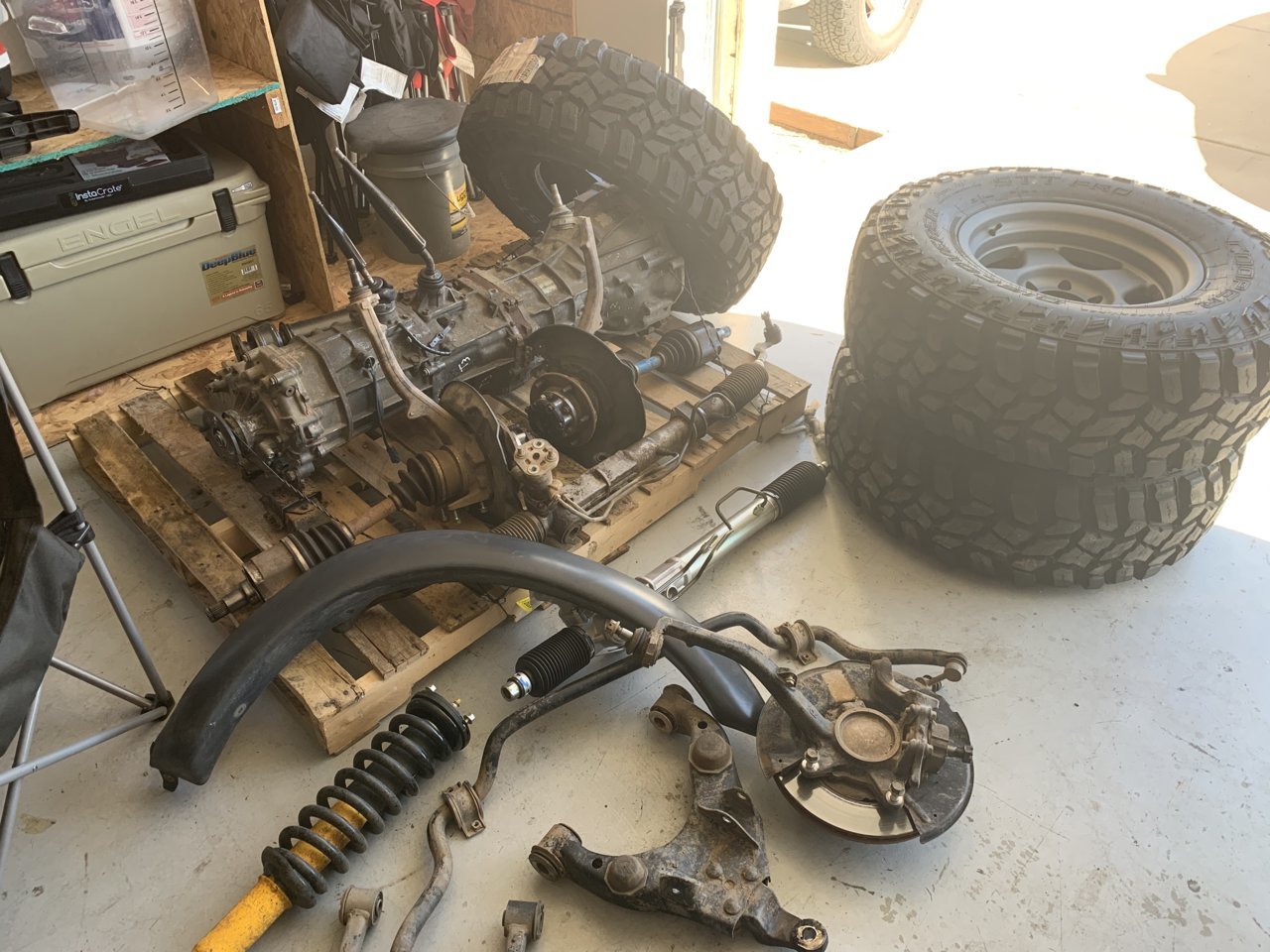

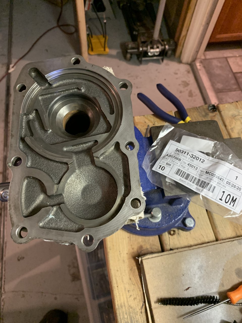

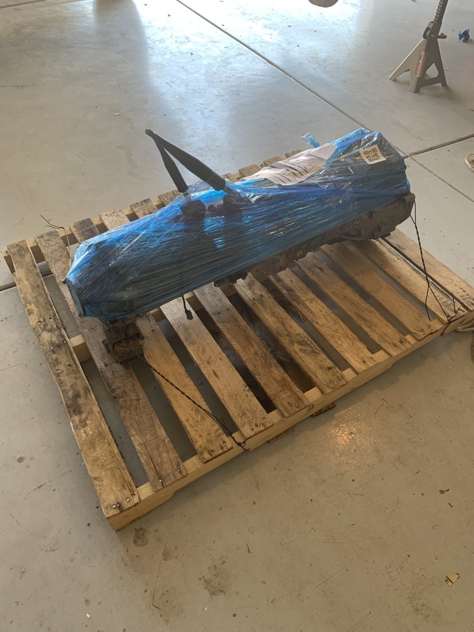

    Got to spend some more time on the truck this weekend. Spent a ton of time getting the trans cleaned, painted and prepped for install. I can finally start to see light at the end of the tunnel.
    I hadn't done much with the transmission since it first arrived other than to remove the plastic and give it a quick once over. Here is how it arrived from JDM imports:
    I noticed right off that the flange on the output of the transfer case was toast, looked like someone got carried away with a cut-off torch. I had checked to make sure everything moved freely and it shifted into all gears along with the transfer case. Then left it to wait while I worked on other stuff first because of Toyota taking ages to get parts to me.
    I had already planned to replace all the sensors because I had no idea if they would be functional or not. Boy was that the right choice. Every sensor was either broken housing, cut wires or otherwise not usable. I would end up finding a few other surprises along the way, but we're skipping ahead...

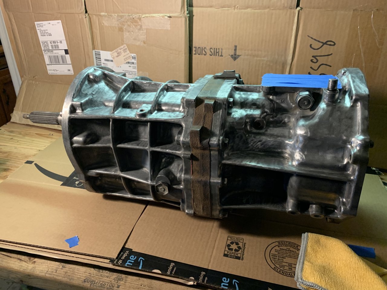

    With all the parts in hand, it was time to dive in at last and renew this transmission. For all it's faults, it shifted nicely on the pallet, no bearing noise, what fluid was left looked good and a gander inside the various ports showed everything looked pretty clean!
    I stared off by breaking down the different sections. I needed to replace the seal inside the front bearing retainer and wanted to have the bell housing off for that and cleaning. I had over the past week or two, been occasionally spraying all the bolts with a quick blast of PB Blaster in a hopes to have no issues when breaking stuff loose. Happy to report everything broke loose without issue, though I did find a broken bolt in the bell housing during this process... and two different stuck alignment pins from the old engine it came from.
    Decent picture of the before breakdown of whole unit: (Pardon the pile of parts otherwise)

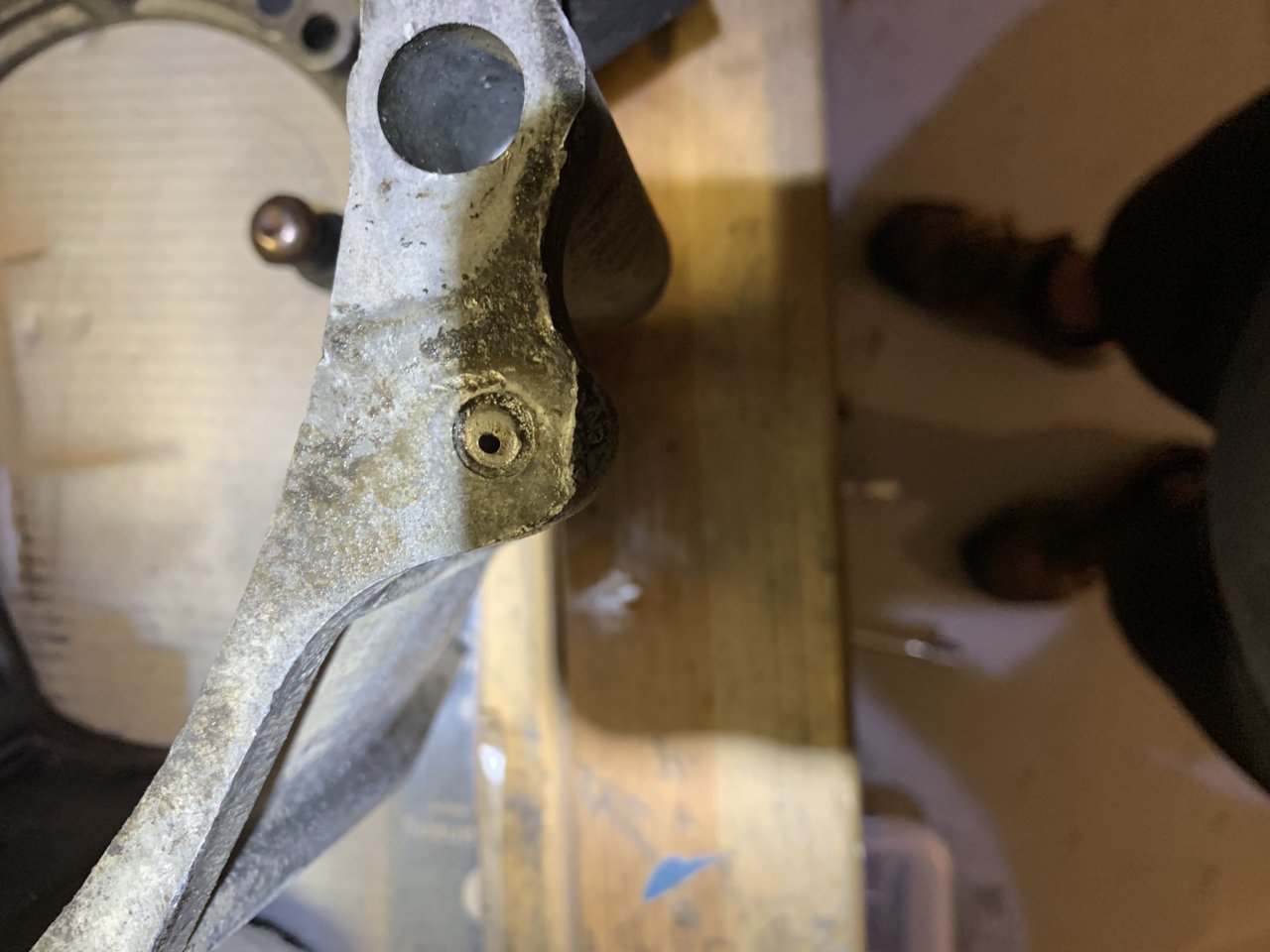

    Broken bolt in bell housing: (just for inspection cover but still, wanted to fix it)
    Drilled the bolt out for removal:

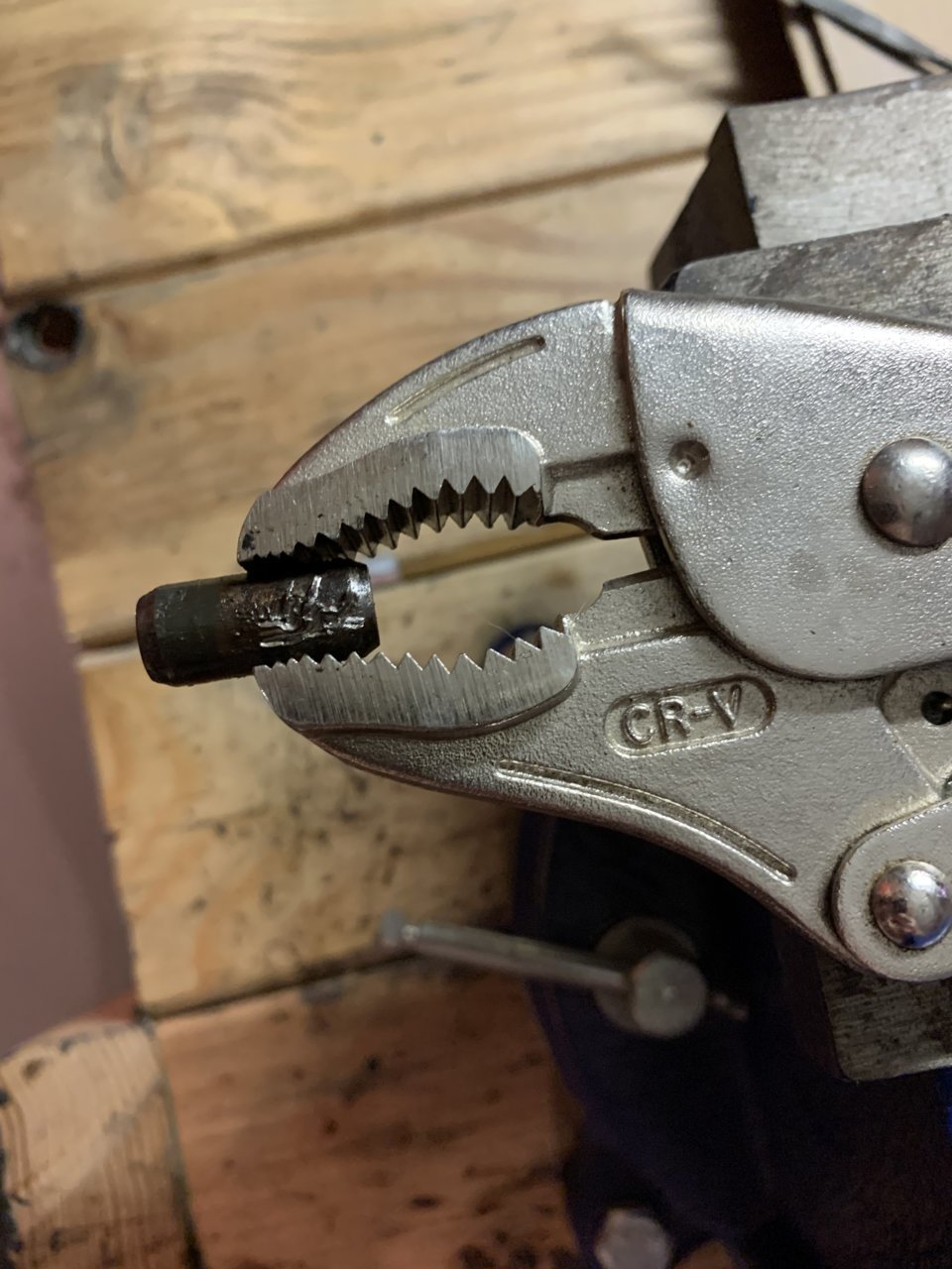

    One of the stuck pins, had to use a torch a vice grips to get these damn things out.
    Wire wheeled:
    Replacing the front bearing cover seal:

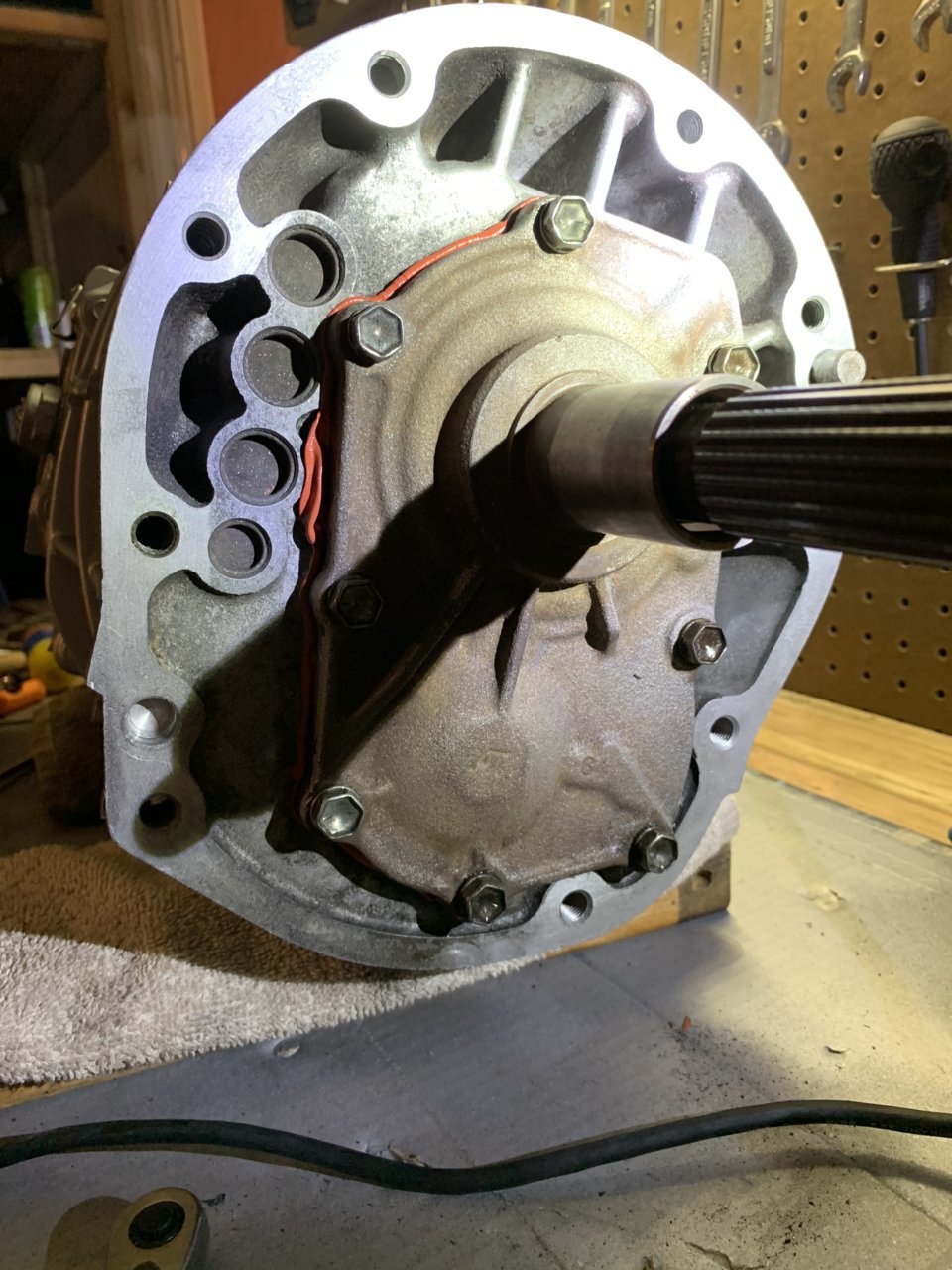

    Made sure all the surfaces were very clean. The old seal was really nasty. Bearings were clean and rotated smoothly. Little bit of shaft play top to bottom and side to side but nothing that felt excessive. Can anyone chime in that has a R150F and mention if there input shaft had any play?
    All sealed back up with fresh FIPG:
    Painted & new output seal, back-up sensor, marlin hd magnetic drain plugs, shifter base gasket, marlin short throw shifter, hd seat and bush installed. Along with new throw-out bearing, shift fork, rubber boot and slave cyl. Damn parts have been sitting on the shelf for ages it feels like. So glad to finally have them installed.
    Not perfect by any means, but happy with the outcome. The next post will detail the install and a few bits I wanted to provide more information on. Thanks for reading :)
